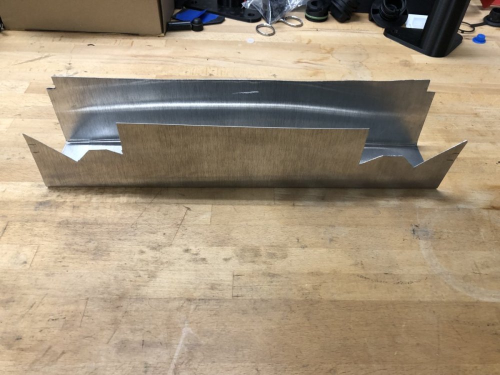

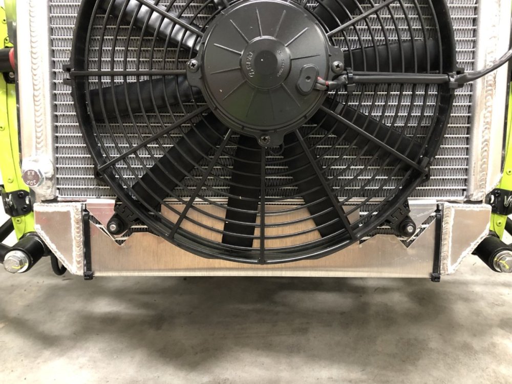

UglyFast Posted October 16, 2023 Posted October 16, 2023 On 8/19/2023 at 4:10 PM, JohnCh said: The crate engine, air box, ECU, dash, gauges, switches, dampers, factory fuel system, etc. Anyone want to build a car from my leftovers? I did a little fettling today then took the car out. Temps were still cool and the notorious oil over-cooling on these cars was present. As a result, I never took it over about 4500rpm but the engine felt good. I also seemed to really begin pulling strongly at part throttle at 4000rpm. To temporarily address the cold oil temps, I fabricated a simple block off plate out of thin aluminum. The clamping force is strong enough that it doesn't move once in place, and it is inset a bit, which results in the end caps preventing lateral movement. A couple of zip ties should ensure it doesn't vibrate off. I consider this V1, and suspect I'll make it to V3 or V4 before I'm satisfied. -John New crate Duratec that needs a good home did you say? LoL I might know a guy.
