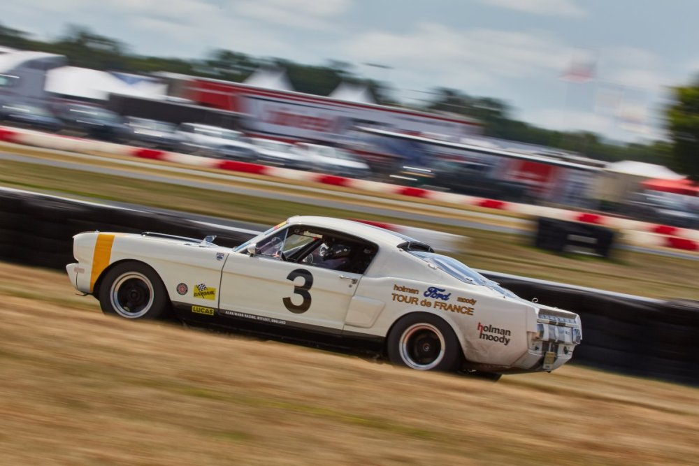

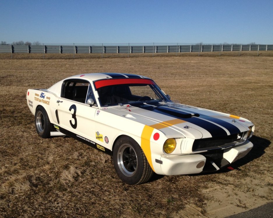

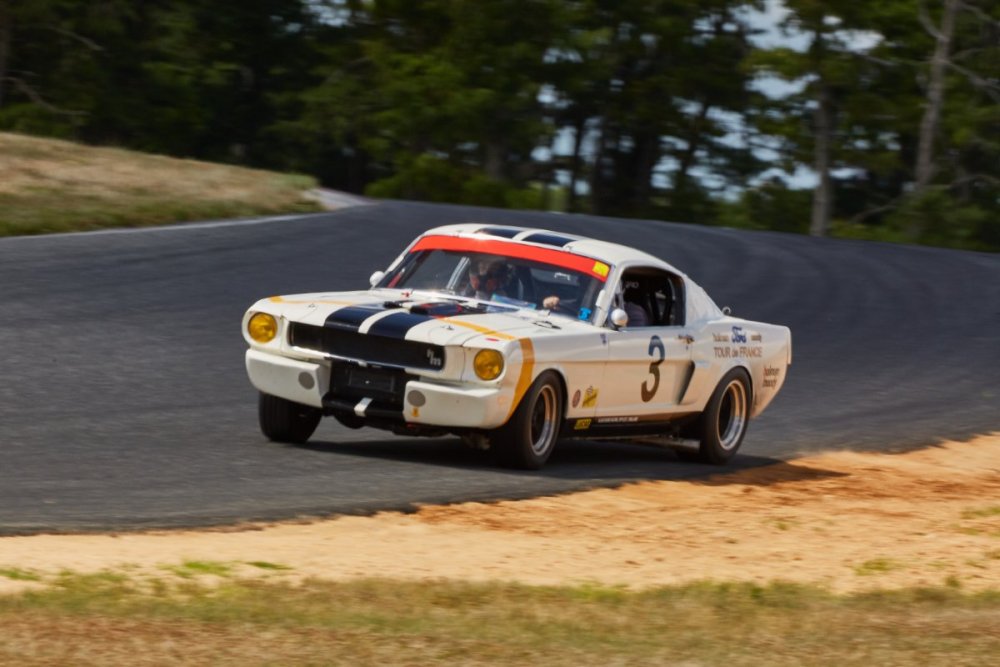

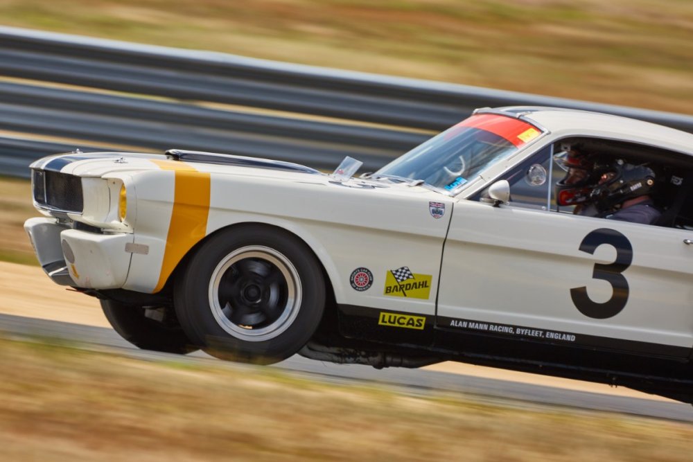

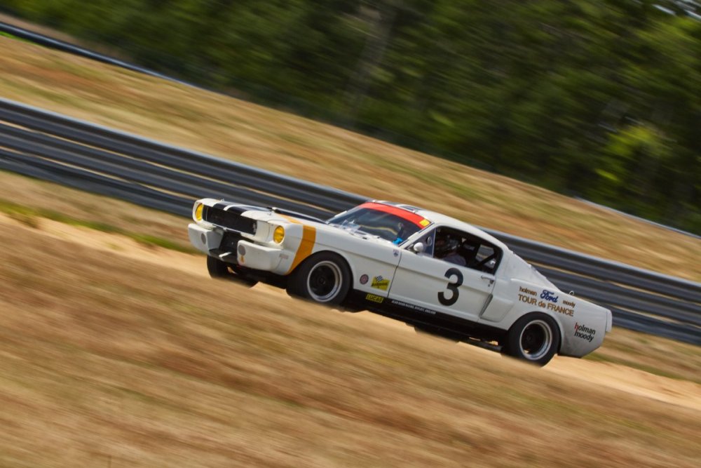

Time for another car of mine.  A 1965 Ford Mustang Fastback.
This car had been a hacked up race car for many years.  Found on a backroad of NC for sale with a Jericho gearbox and no engine to speak of, it was given to Holman Moody and Pathfinder to do some magic.

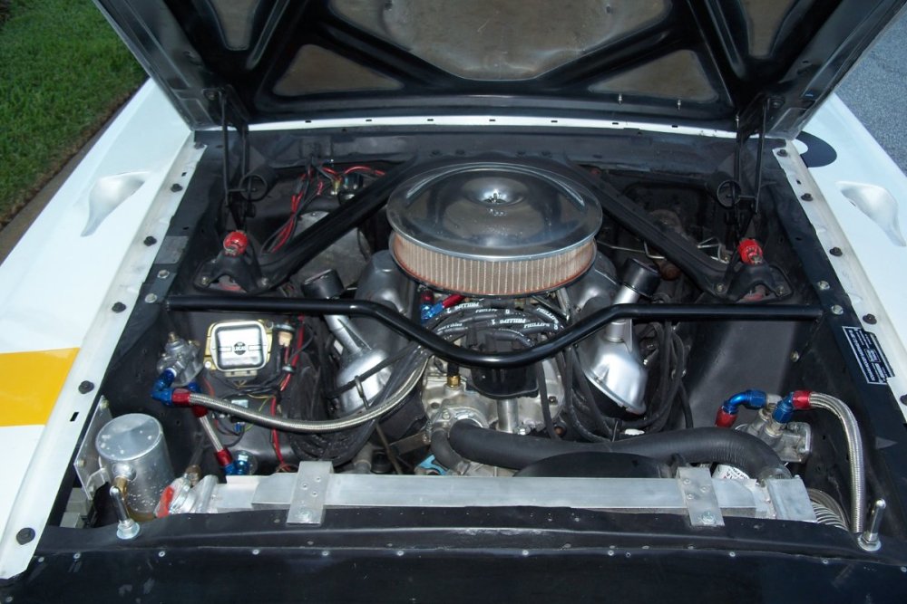

The Jericho came out.  A T-10 gearbox went in.  Holman Moody did a Ford 289 HiPo engine with Nascar headers tuned for 93 octane.   Like all Ford engines of this era, it leaks oil, a lot.  I think of it as the corrosion protection program.  Three inch stereo pipes. No muffler.  Apart from having roller rockers and being tuned for 93 octane it is FIA compliant - so an easy conversion if a future owner needs it.

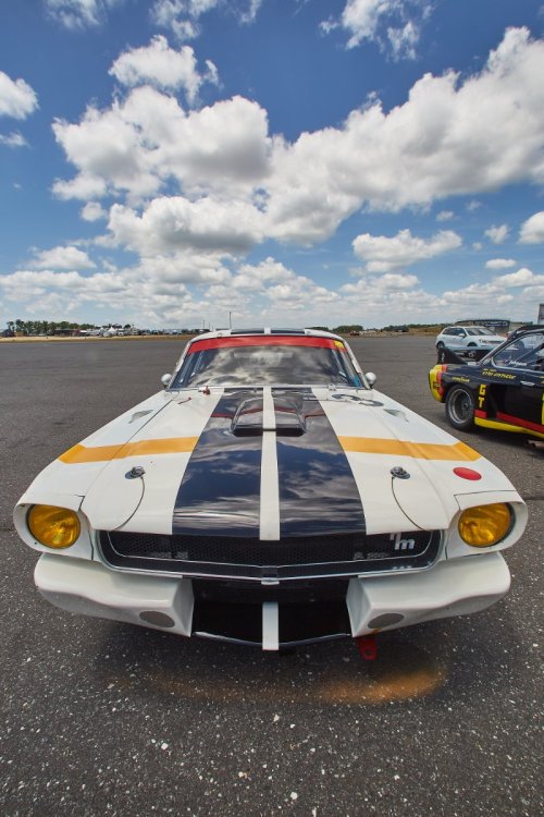

The body was given the usual GT350 R (for racing mods) - fiberglass hood and trunk, air scoops in all the right places.  Suspension follows the same period GT350R mods.   It was running the Lincoln Versailles rear end (9 inch diff on live axle) as this allowed rear disk brakes but I eventually had to swap that for a Mosler diff as I was bending the axle under hard cornering and creating oil leaks from the rear end as the seals warped.
Interior dash is a GT40 Mk11 dash from Abbey Panels, just turned upside down for installation in the Mustang.  The exterior was intended to be a tribute to the Ford Mustang notchback race cars that did so well in the Tour De France road rally event of the period.  This also played a part in the idea for a limited run Holman Moody Ford Mustang celebrating Tour de France road rally (red exterior with gold accents) which was released just after this was finished.
Because the standard Gt40 race dash had so many holes drilled as standard, creativity was applied to fill in the holes with some fake switches.
It is a tough car to drive.  It is physical and requires a lot of finesse and more than usual brute force to rotate it properly through corners.  The front tends to want to push despite the ton of negative camber on it.  So the right foot and a bit of a flick is needed at turn in.  A lot of wheel waggling then ensues to line it up.

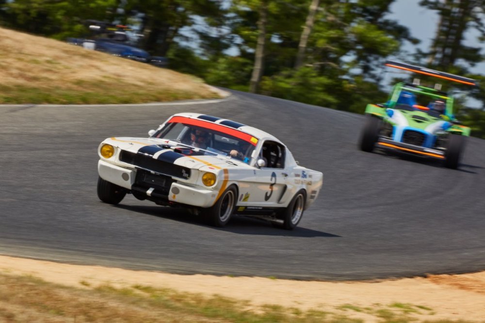

Being chased by @xcarguy here, with his son in the passenger seat of the Mustang.  @Kitcat is coming over the crest in the background.  I had vague hopes of staying ahead of both but there is a video somewhere on USA7s that shows what happens when grip finally gives up in a corner in front of two sevens - only a lap or two after this photo was taken.  I lost the car laterally onto the dirt and the rear rotated around in front of Kitcat.  He locked up, poo came out and then he sorted out how to get past all 2700lbs of rotating Mustang.  Meanwhile Xcarguy is behind, both hands off the wheel doing thumbs up signs.  Oops.

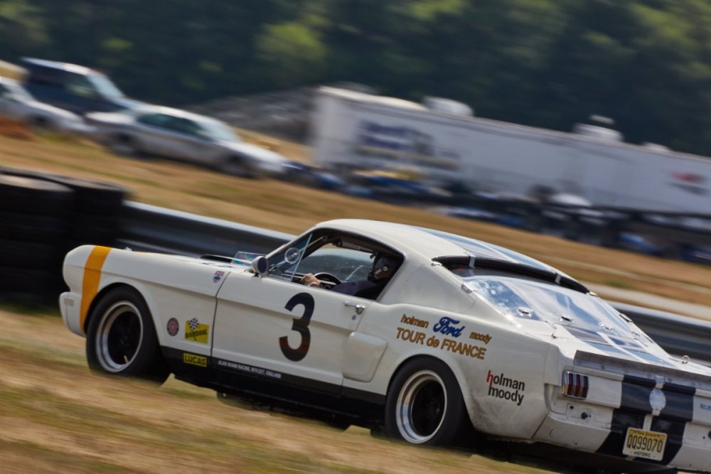

On a hot day, the tires just give up and she goes sideways in the corners.  This photo shows a certain level of desperation to avoid going off as the visible hand on the wheel shows opposite lock coming on and my right foot is on the floor.
But for all that the car is intoxicating for its smells and the epic engine note as it bellows out of a corner.  Easily rivals a v12 Lambo engine for engine note as it revs out.  You feel its pistons firing through your body.    Rev limit is 9K but I stop at 7K to save it.  Thats still around 140mph in a straight line.  With brakes that take 4 laps to warm up so you are slewing the car into a corner to scrub speed.  And even when those brakes do warm up they are not the greatest, reflecting what it was like in period.
In summer you are wrecked in 25 minutes.  Truly an intense exhausting drive to hustle it fast.  Quite easy to drive it at 7/10ths but taking it faster is massive increase in effort.

Great looking, nostalgic car.  Very authentic to my non-expert eye - reminds me of Watkins Glen and the old Trans-Am days.  Perhaps you should post a video that includes those terrific motor sounds - I'll bet it thunders!
I share your perspective - it is so much easier catching someone as opposed to staying in front.  When you are behind, everything is in front of you.  But when you are ahead, you have two vistas to monitor at all times, while still managing to drive.  I could see from Xcarguy's excellent video how difficult the Mustang is to handle at 9/10's - out of those turns, she was shaking her derriere harder than a French can-can dancer.  And, as you noted, even more when two Sevens are on your tail.  I suppose some of this should be expected from a fairly heavy car riding on fairly skinny rubber.  But you also mentioned overly-responsive turn-in - makes me wonder if your alignment is a bit out.  Is the problem asymmetric?  That's usually a hint.
(For the uninitiated, my post has intimated that Croc's car was possibly a little under-prepared.  Just watch - when you provoke a crocodile, be prepared for a dagger-toothed response.)

I guess granada front brakes and dropping the upper control arm shaft down an inch on the unibody. They have power rack and pinion conversions available for these now too. I always disliked the original power system with the tilting pin actuator. Always seemed to over-correct.
It was kept period GT350R on the front.  So front brakes are Kelsey Hayes 11 inch discs which was the upgrade option available instead of the base model front drums.  Rears were drum from a Ford station wagon (or was it the Galaxie?)  but I have adapted for rear discs.  Mind you - the car still doesn't stop great!
Front suspension is basically standard 65 Mustang but with 3 deg of negative camber thanks to some camber plates. GT350R spec springs (shorter to lower ride height plus different rate).  Yes the upper control arm mounting is dropped an inch.  Rear has the usual GT350R traction bars and revised rear springs.
Mine is original style steering box - no power steering.  Yes it is heavy at low speeds.  Quite vague at the straight ahead so a fair amount of wheel waggling goes on at speed to work out where the wheels are pointed.  If I upgrade it using the new power rack approach then I get one step further away from keeping it FIA spec.
Alignment is fine.  Actually my alignment is excellent compared with your eyesight.  Were you posting before your afternoon nap?  :classic_tongue:  What I said is ...
My command of Minglish says that is NOT an overly-responsive turn in.  A push is tendency to understeer.
Car was set up by Holman-Moody.   They know plenty about setting up race cars, more than even you.  This is the first time I have not had to set a race car up myself.  It handled very well out of the box and I am decently competent at setting up a car's suspension for good handling.  I explored putting the toe in to neutral and then to toe out to get the turn in a little crisper but I found it is nicer at the original settings because it is more controllable on the throttle.   I'm old school - I like throttle steer.
