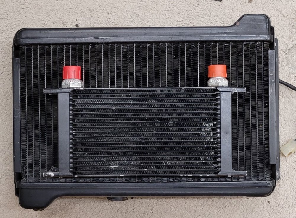

IamScotticus Posted May 10, 2023 Posted May 10, 2023 I have this Setrab 6" oil cooler. is it too big to go in front of this radiator? Radiator has a puller fan on back.
7Westfield Posted May 10, 2023 Posted May 10, 2023 I'd call that overkill we don't run one that big on a Formula Ford As for mounting it there, remember any heat it dissipates is going to go right into the water, so I question if there's any net gain
MV8 Posted May 10, 2023 Posted May 10, 2023 I put one about that size on a miata I turbocharged (no water jacket) to help extend the oil life to normal change intervals. I don't see the need for a cooler on an NA application. There is also the extra plumbing taking up space, oil pressure drop through the cooler and lines, plus oil drain and fill complications. If you need extra cooling, consider an aluminum radiator. More efficient than the cooper/brass.
IamScotticus Posted May 10, 2023 Author Posted May 10, 2023 All good points. The necessity is something i contemplate.. As for location, I haven't seen OCs mouted anywhere else on 7s.
KnifeySpoony Posted May 10, 2023 Posted May 10, 2023 On modern 420/620 the oil cooler cooler is mounted below the water rad. It's very small but the oil is still overcooled in all but the most demanding track situations (ie high ambient temps and nose/tail drafting). 1

wemtd Posted May 11, 2023 Posted May 11, 2023 (edited) Fwiw: my oil temp was getting to 230+ I added a Setrab cooler: Both water & oil temp are now stable at their set points. Discussion is here: Edited May 11, 2023 by wemtd Add link. Make more succinct.

Dave W Posted May 11, 2023 Posted May 11, 2023 If you are over cooling the oil, google Mocal thermo controlled oil by pass. It does an excellent job and will really shorten warm up time. 1
