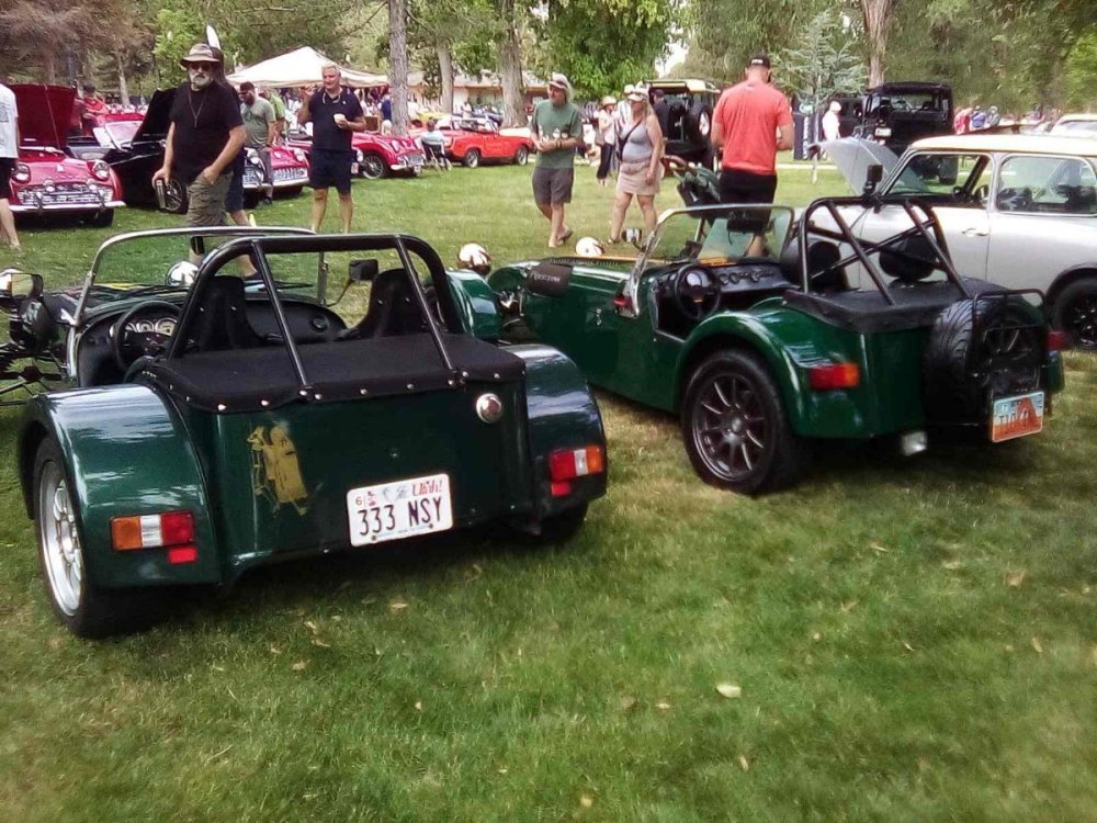

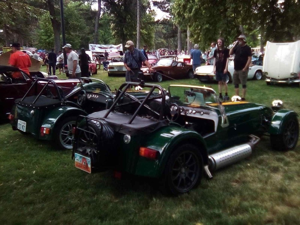

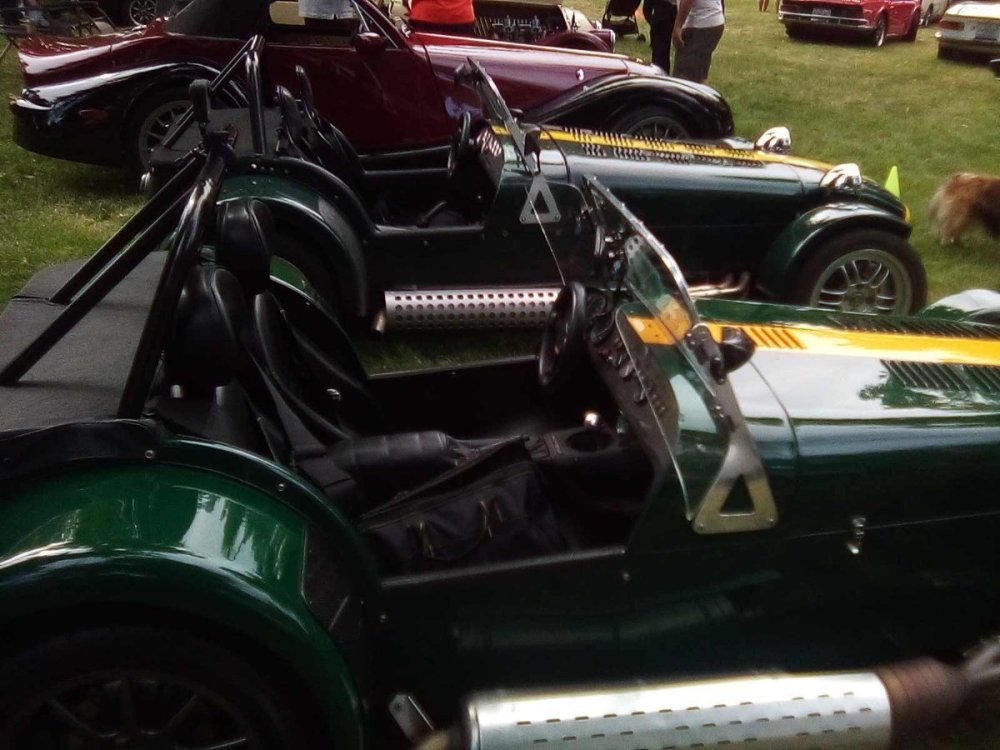

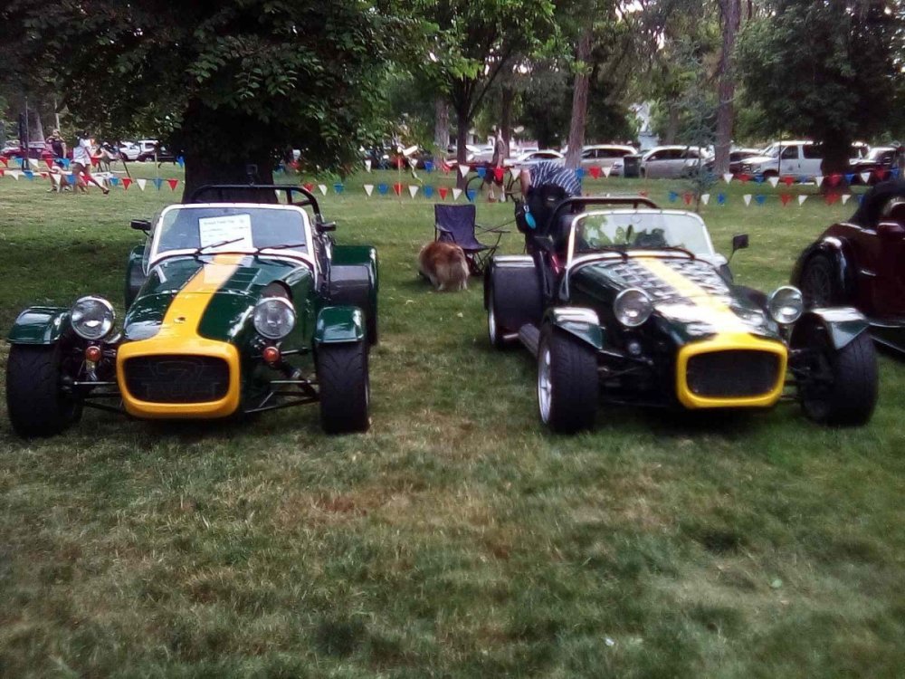

Took Bones to the British Field Day in Salt Lake City today. Met up with @Frankie and had the chance to really compare a Birkin to a Caterham side-by-side. It's interesting how similar the cars are, with really just very minor differences.
This car show also has a very little autocross course. I had the second fastest time, but was definitely hampered by a lack of steering radius on such a tight course. The fastest guy was a friend of mine who is a very good driver in a heavily modified bugeye Sprite.
  • Like 4
It was a wonderful day under the Elm, Cottonwoods and Pine trees at the Historic park in the center of Salt Lake. I didn't take an official count of how many cars were there but it had to be in the realm of 150 plus. We were parked next to a beautiful 2005 Morgan Aero 8.  Breath taking car! But the best part of the day was meeting a new Seven friend who I will be able to drive Utah's Wasatch's  canyons with.  I purchased a GoPro Max this year and have already driven four of our closest Canyons. Millcreek, Emigration, Big and Little Cottonwood Canyons.  As soon as i figure out how to use the damn GoPro and edit the film I will post them.

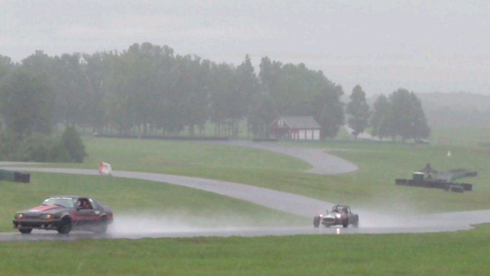

Went to an SCCA autocross today. How it started:
How it ended:
112_1642.thumb.JPG.d011b28928363d037ace350506f966b5.JPG112_1640.thumb.JPG.23fea5d19df4d30e0fecb2772cfef762.JPG112_1641.thumb.JPG.a6ee2a96d0c22f0b5e10c7ab142bc855.JPG
It's tough to get pictures mid-deluge, but long story short, the "15% chance of scattered showers around 3:00 P.M." weather report turned into hours of persistent, heavy rain starting about 11:00 A.M. Lessons learned:
1) Don't trust weather reports
2) The tonneau cover works surprisingly well to keep most of the water out of the car
3) One really does get drenched driving one of these in rain
Serious question for those who have ITB's or carbs with exposed intakes: what do you do when there is heavy rain? How effective are these air filters at keeping water out of the engine? I wasn't sure, and opted to better be safe than sorry, meaning not getting any runs in the event and leaving the 7 at a friend's house a few miles from the autocross site. I wasn't about to get caught out in another big storm on the freeway trying to get home. A disappointing day to say the least, but another good story to tell.

I've driven in some pretty vile weather on tours without issue and none of the other cars with exposed filters on those tours had problems.  The picture below shows how much of the filter is exposed on the Westfield.

We have now driven through three major rain events. (The last one just a week ago that produced an EF1 Tornado with winds of 165KPH. It was some distance to the west of our location as we hightailed it east.) Our car hasn’t missed a beat do to water. However, there is a leak somewhere that allows water to drip down into the interior from the shelf.
I’ve been meaning to look into getting some sort of filter to prevent objects getting into the engine via those large mesh screens on the velocity stacks. I’d say that “itg” form filter makes your car much better off than mine.
Best of intentions but sometimes you cannot avoid the rain.
I think you have less issues from the water into the exposed air filter intake than you do from water leaking down into the well where the coils drop into the engine.  In heavy rains my last four Caterhams have all developed engine misses in heavy rain - usually from the front most coil.  Four different engines - regular Zetec, SVT, 2.3L Duratec and 2L Duratec.  Two different cam covers on the 2.3L Duratec made no difference. If your engine was not missing then the car will be fine but wet, along with you.
It took a sump pump to drain 3 inches of water out of the Caterham cockpit after this maritime expedition.  I discovered I had no drain holes - oops.  Still one of my favorite all time drives in a se7en.
Still you can easily dry the car out and do it all again.
Thanks for the replies @JohnCh, @theDreamer, and @Croc. The consensus is that I was indeed being overly cautious, a little bit of rain won't hurt the car, and in the future I shouldn't be worried about driving it in a rain storm.
