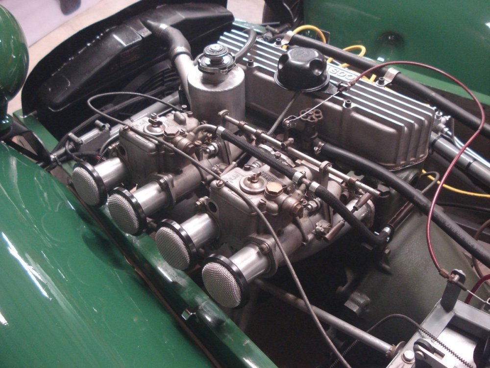

Christopher smith Posted March 22, 2024 Posted March 22, 2024 I have the stainless steel mesh type on my 40 DCOE2 velocity stacks. Not sure they filter out much except nuts,bolts and stones. And the rubber attachment rings seem a bit shaky. So can not recommend this type for higher mileage use particularly in dusty situations. But I see claims of better performance from other mesh air horn units. I recall seeing the oval track sprint car guys running without any filters or mesh and wondered how many rebuilds per season they must do.

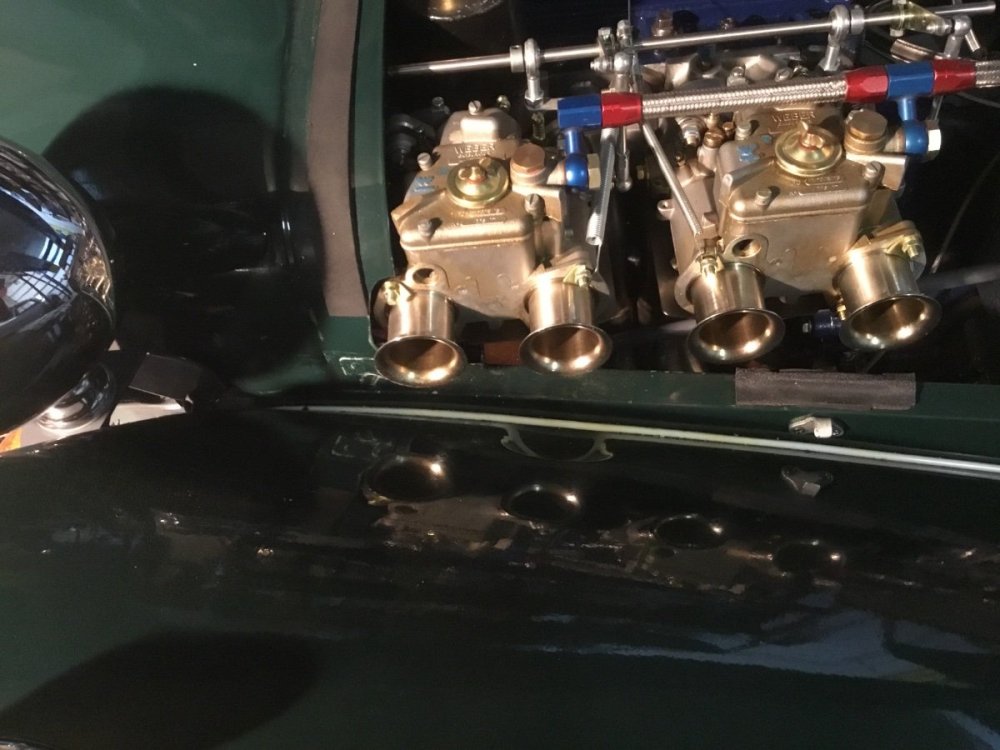

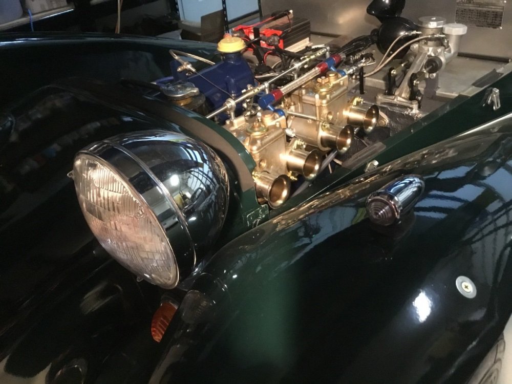

JohnCh Posted March 23, 2024 Posted March 23, 2024 1 hour ago, jbcollier said: Exactly how much space do you have between the carb and bonnet? How much if you bin the air horns*? To me, this is the key. Understand what you have to work with, and identify those constraints before spending time on solutions that may or may not apply. Pictures of your bonnet scoop and the carb to frame area like many showed above may also help.

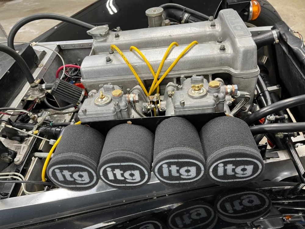

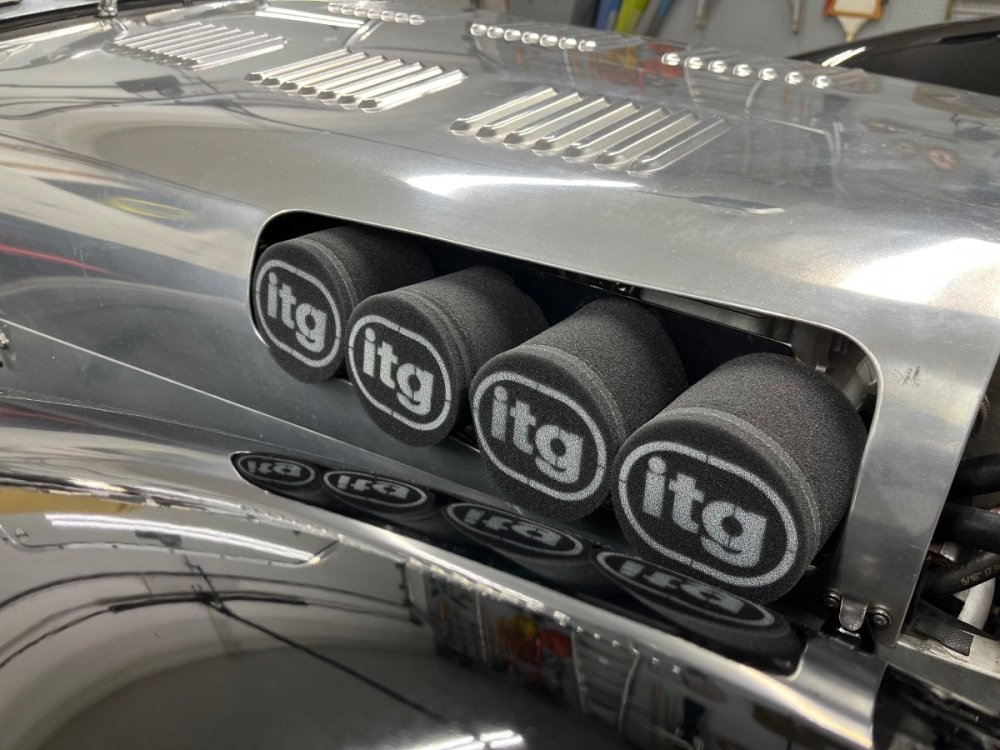

Stevensonjr Posted March 25, 2024 Author Posted March 25, 2024 I thought I would send photos as suggested. As you can see the front air horn is sitting in a cut out where it just barely fits. The fast taper of the air scoop does not allow room for anything added to the air horns. I might try a paper pattern to see if a cutout to fit the air horns would interfere with the bonnet latch. I’m open to any suggestions to move forward on this. Thanks, Bill 1
