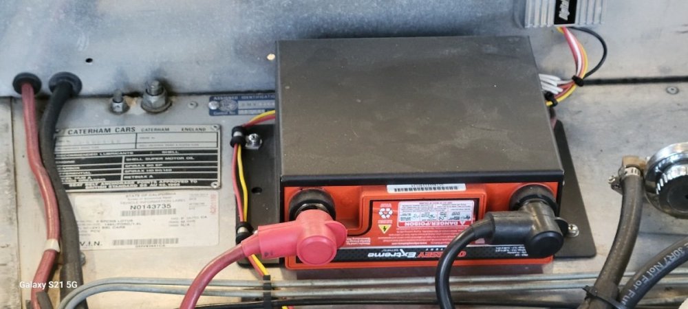

I used the Odyssey box on top of the footboy shelf.  Easy job since I am not encumbered with luxuries like a heater...

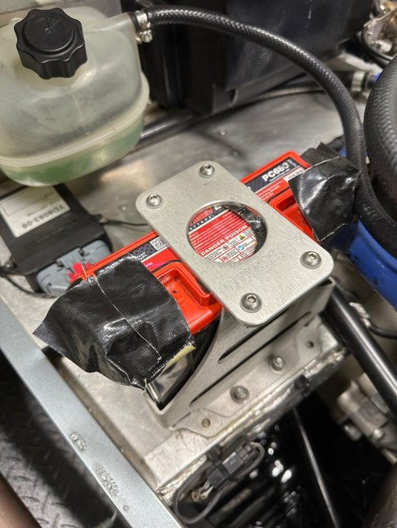

Finally was at the garage this week to deal with some automotive things
Here is my Caterham Odyssey PC680 installation with the Odyssey bracket.
Thanks Mike. It appears to be over the passenger footwell. I’m installing same bracket same place. Did you secure the two SS studded plates so they don’t fall away when removing side brackets /nuts / battery? How? The bracket is an engineering marvel except for when you might want remove the battery seasonally etc. cheers! Steve

Hi Steve - yes it is over the end of the passenger footwell.  Its been a while since I installed this but if I want the battery out I undo the top cross plate and pull it out the top.  The side plates are screwed down to the base - never touch those.  I feel like I am missing your point?  Apologies - its been a long week!
Got it thanks!  Now I see the all the battery pictures posted.
