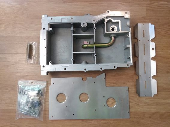

In case this helps, here's what the insides of a Caterham wet sump look like. The pickup tube is just loosely installed and it looks like the whole assy is pretty well designed. I'm sure it would be fine in a HPDE setting on 200TW tires, but if you ever wanted to upgrade to stickier tires it would be a lot easier to have a dry sump installed from the factory.

I just measured the wet sump depth at approximately 3" or 77mm.
Raceline says their dry sump kit measures the following: The Raceline Duratec dry sump kit measures 440mm in length x 310mm width and 50mm in height.
Raceline says their wet sump kit measures: The Raceline Duratec aluminium wet sump pan kit is designed to run5 litres of oil while giving maximum ground clearance (approx 75mm from block face)
I measured 77mm so you save between 25-27mm depending on which measurement you believe, so approximately 1 inch.
