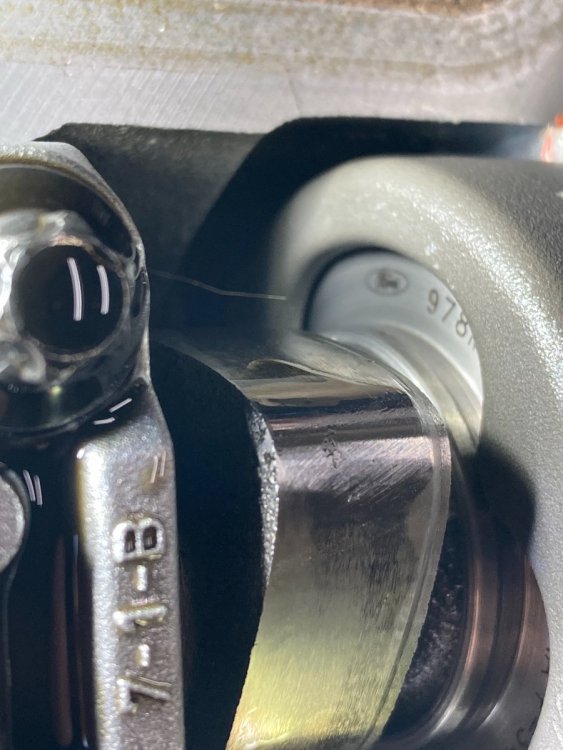

Vovchandr Posted July 19, 2021 Author Share Posted July 19, 2021 4 hours ago, Dave W said: If you look at the wear pattern on the lobes, they are not consistent from one lobe to another. Typically they appear to be simular for any given cam profile. Could actually be the cam grinder did not do a second spark out on the profile? Dave w I see what you mean. Didn’t see any obvious contact patch issues on the intake. did find this small blemish on exhaust on Cyl1 Link to comment Share on other sites More sharing options...
Dave W Posted July 20, 2021 Share Posted July 20, 2021 That small blemish in the real world probably would not cause any issues. It's the bluing marks on the lobes which indicate a high heat condition. What is causing the high friction? Cam profile, oil or possible oil passage blocked, lifter bucket, possible break-in procedure, machining error ? That's the million $$$$ question. First, try by eliminating what it is not, starting with the easiest possibility first. Dave w Link to comment Share on other sites More sharing options...
Vovchandr Posted July 20, 2021 Author Share Posted July 20, 2021 2 hours ago, Dave W said: That small blemish in the real world probably would not cause any issues. It's the bluing marks on the lobes which indicate a high heat condition. What is causing the high friction? Cam profile, oil or possible oil passage blocked, lifter bucket, possible break-in procedure, machining error ? That's the million $$$$ question. First, try by eliminating what it is not, starting with the easiest possibility first. Dave w I see the logic behind there being an unresolved temperature problem. True history of the car use prior to my ownership is unknown and if the headgasket was blown before my ownership it's not out of the realm of possibility that it saw high temperature events prior. At the time of purchase the car had no radiator fan wiring hooked up at all and would over heat very quickly if started. Not sure what capacity previous owner used it like that and for how long. My best guess at this point is get the head cleaned, get rid of most marks possible, reassemble and check in the future if new ones are forming. If there is any other advice as to what to look into in the meantime with head being off, I can look into that too. Link to comment Share on other sites More sharing options...

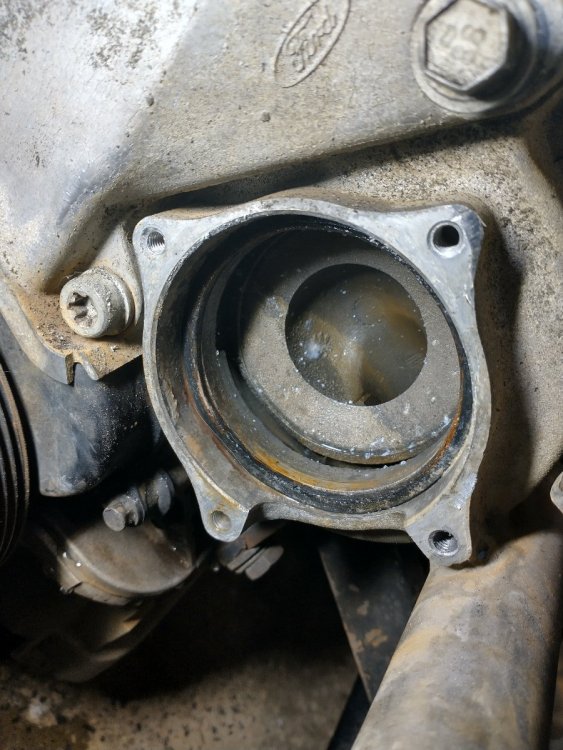

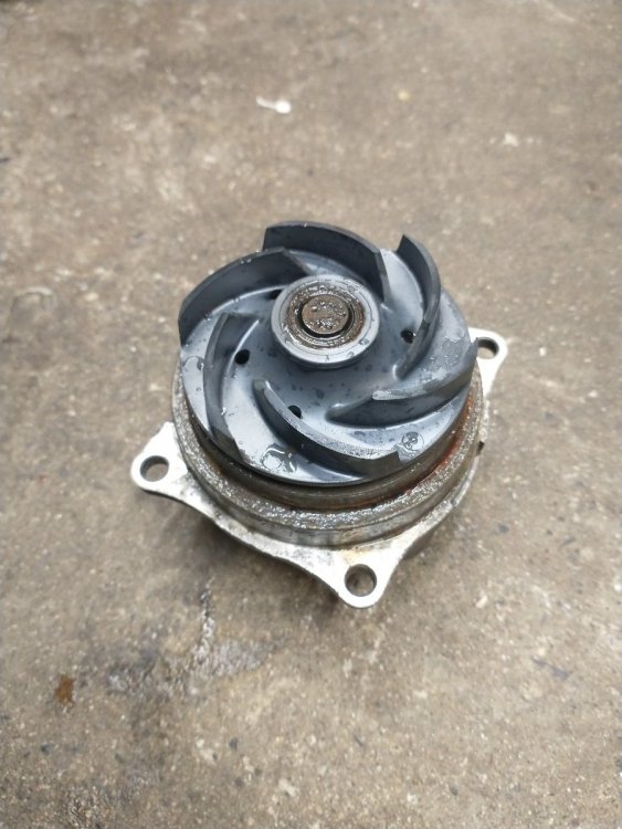

Vovchandr Posted July 27, 2021 Author Share Posted July 27, 2021 Dug into it after work today and got the head off. Water pump is in one piece. Maybe a little hard to spin if I have to be critical of it There are little gelatin like pieces all over. Any ideas? Link to comment Share on other sites More sharing options...

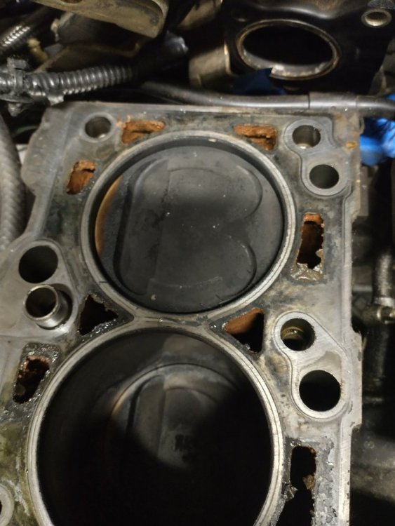

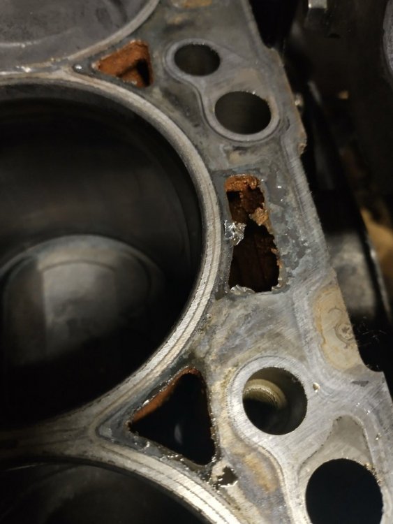

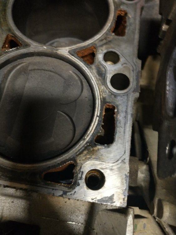

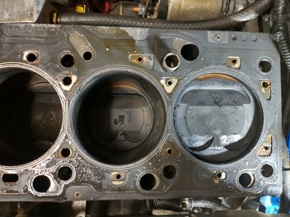

Vovchandr Posted July 27, 2021 Author Share Posted July 27, 2021 No smoking gun anywhere Link to comment Share on other sites More sharing options...

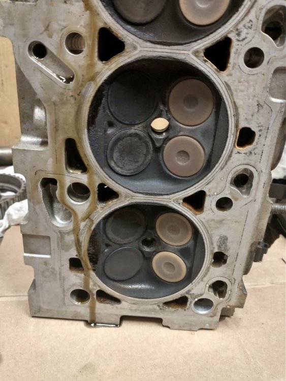

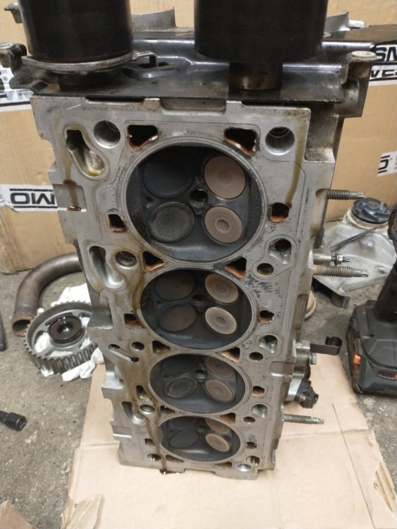

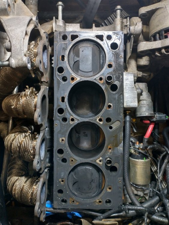

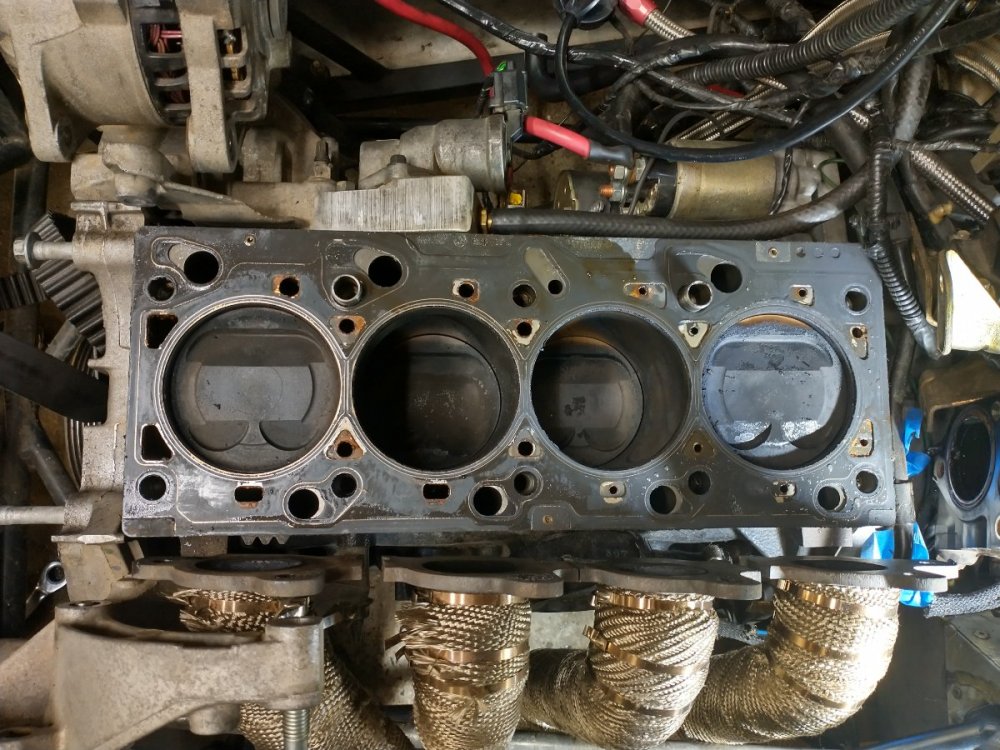

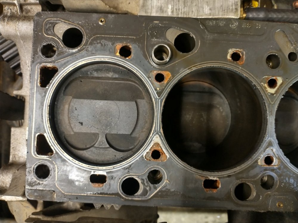

Vovchandr Posted July 27, 2021 Author Share Posted July 27, 2021 All 4 cylinders look pretty matching now Head looks normal? Link to comment Share on other sites More sharing options...

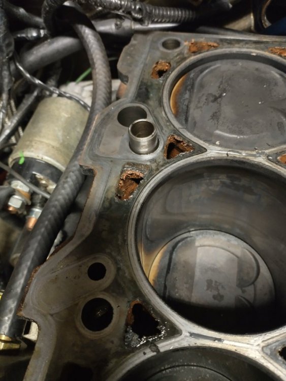

Croc Posted July 27, 2021 Share Posted July 27, 2021 That white gunk looks suspiciously like oil/coolant emulsification from when it was running coolant - not sure but I don't like seeing it where it is. I am concerned about the rusted condition of the coolant galleys in both head and block. Not sure how best to treat that short of a full tear down. If the water pump is hard to spin then that might be a sign of a bad or going bad bearing. Investigate that now. I am going to ask the innocent question - how will you clean the block top surface so that debris does not fall in the cylinders or cooling galleys or oil galleys? @JohnCh Beer money bet - how many cylinders do you think were breached? Link to comment Share on other sites More sharing options...

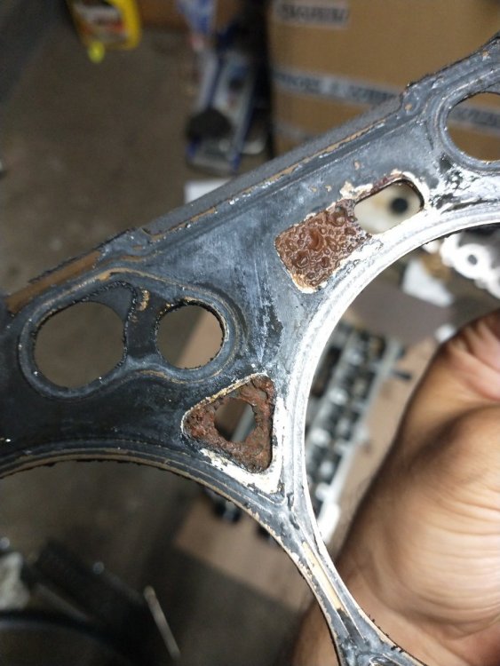

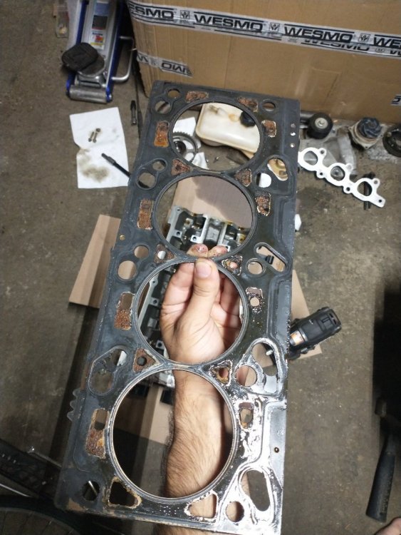

yellowss7 Posted July 27, 2021 Share Posted July 27, 2021 Vlad, what does the head gasket look like? Any obvious breaches? Link to comment Share on other sites More sharing options...
Vovchandr Posted July 27, 2021 Author Share Posted July 27, 2021 10 minutes ago, yellowss7 said: Vlad, what does the head gasket look like? Any obvious breaches? It doesn't look pretty but no obvious breaches Link to comment Share on other sites More sharing options...

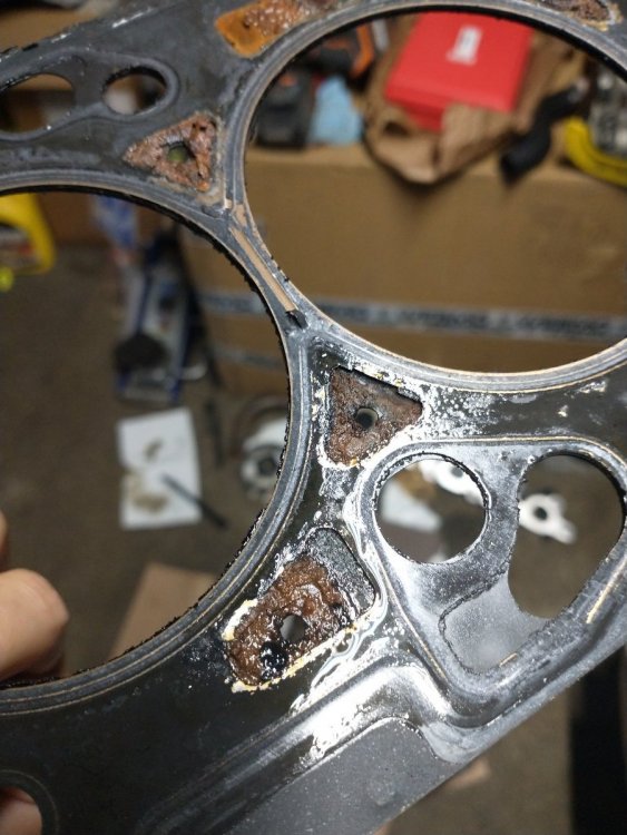

Vovchandr Posted July 27, 2021 Author Share Posted July 27, 2021 Link to comment Share on other sites More sharing options...

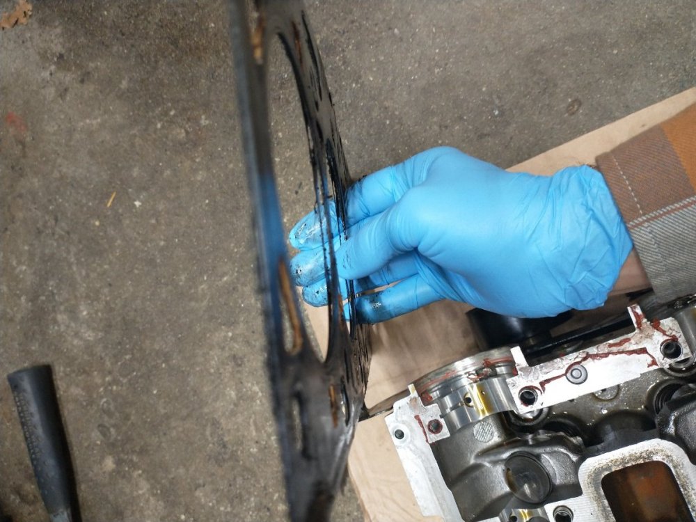

Vovchandr Posted July 27, 2021 Author Share Posted July 27, 2021 Hard to tell if it's an artifact of removal or a broken state but the layers of the gasket aren't held well together and are "flaking/delaminating" from each other with relative ease Link to comment Share on other sites More sharing options...

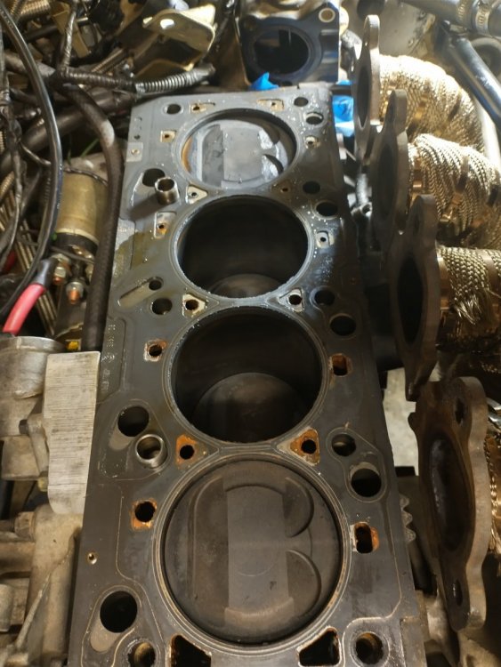

JohnCh Posted July 27, 2021 Share Posted July 27, 2021 Have you examined the bores, valve springs, and valve seats yet? I know the color of the exhaust valves isn't a red flag, but it's interesting that the edges of pistons 2-4 on the exhaust side have matching discoloration. For the experts, does that point to an issue? -John Link to comment Share on other sites More sharing options...
Vovchandr Posted July 27, 2021 Author Share Posted July 27, 2021 2 hours ago, JohnCh said: Have you examined the bores, valve springs, and valve seats yet? I know the color of the exhaust valves isn't a red flag, but it's interesting that the edges of pistons 2-4 on the exhaust side have matching discoloration. For the experts, does that point to an issue? -John I believe you mean the intake side? The little browning on 2-3 & 4. I haven't done anything with the head. Plan is to give it to a shop and let them figure it out. Pressure test it, clean it, level it etc. There isn't much I can do with it on my own. I glanced at the springs and they did all appear to be intact from what I could see. Link to comment Share on other sites More sharing options...
JohnCh Posted July 27, 2021 Share Posted July 27, 2021 9 minutes ago, Vovchandr said: I believe you mean the intake side? Yes, thanks for catching that. It does look odd. Is it only on 2-4? -John Link to comment Share on other sites More sharing options...
