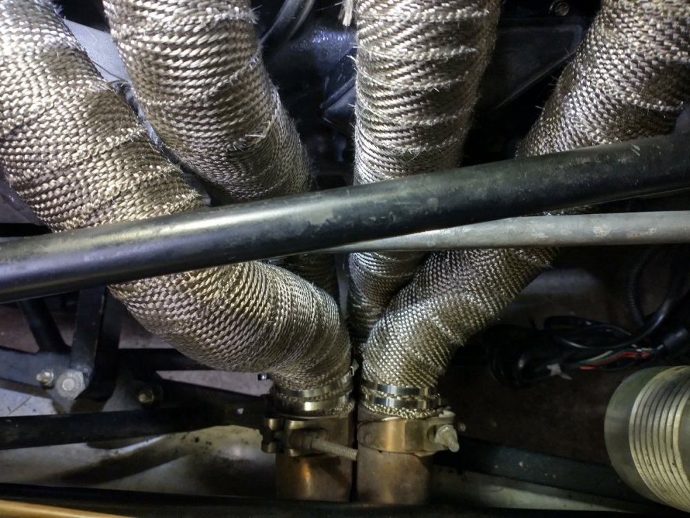

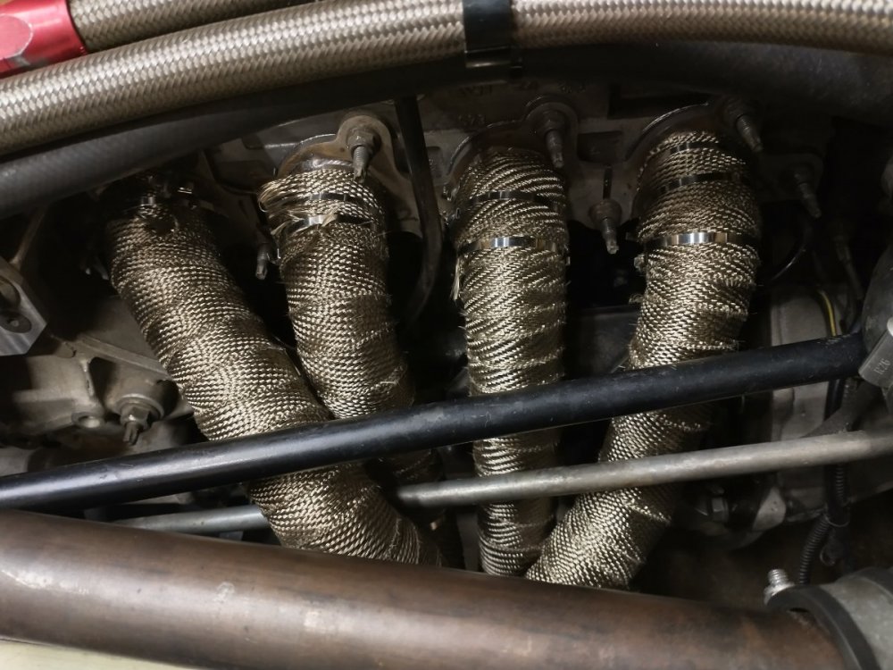

It's a wrap!
Took far longer than expected and was quite a PITA but many hours later it's done.
My one advice is if you ever plan on doing this is do it with engine out or have the header off if possible.
All my runners are individual runners and even though I started to try to take them off I remembered it would actually be more work in the end for me to proceed with taking them off.
Happy in the end. A LOT better than the old job that was falling apart and had had foil as I guess part of design.

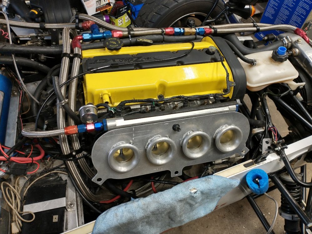

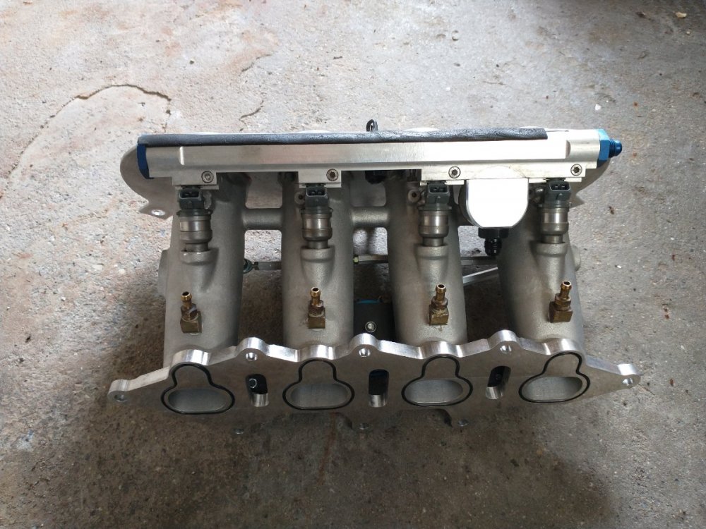

Rebuilt ITBs are finally back
Pretty much entirely rebuilt except face plate, venturi stacks and my IAC rail. New double springs throttle return, new FPR and all new components and actual manifold.
Will hopefully tidy everything up next week and get to test it.

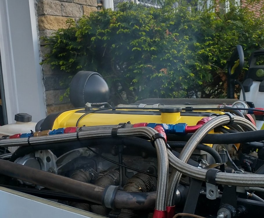

Outgassing of the new wrap was pretty serious. Had to quickly Google it to see that it's expected and normal.
Got the car started.

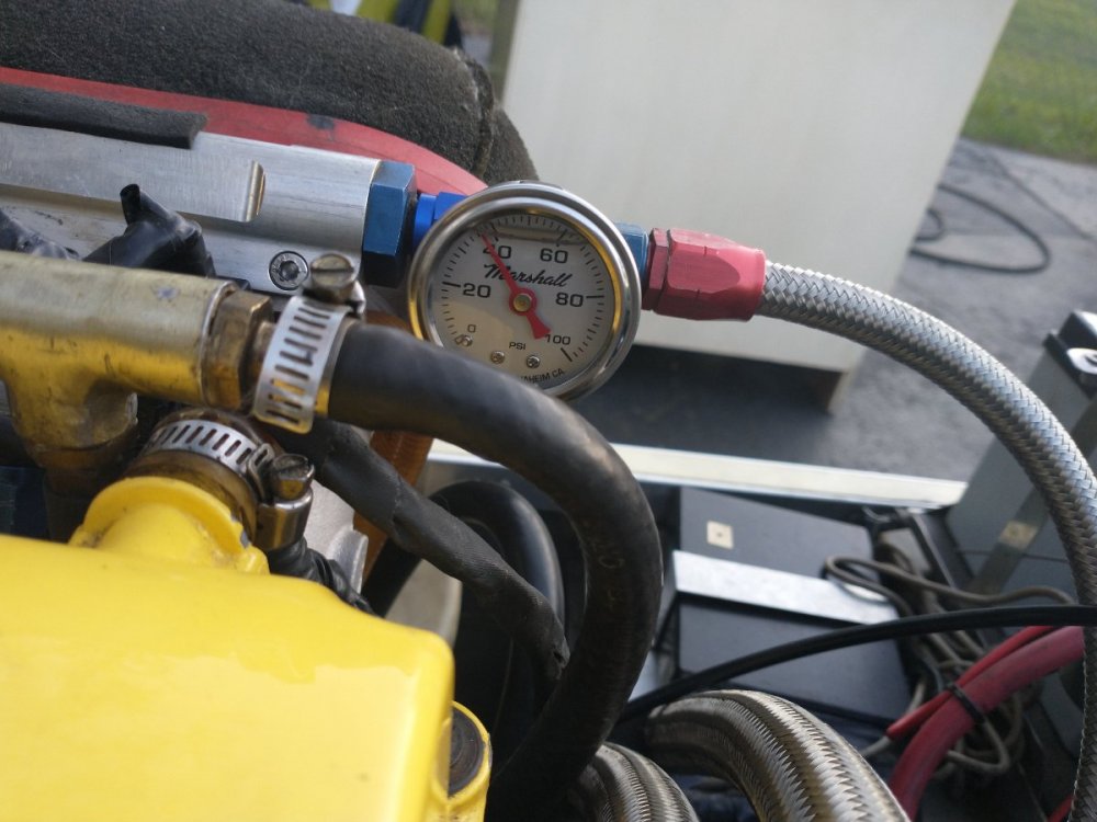

Good news. Rebuild FPR is at 40psi!
Bad news. sticky/Runaway throttle/rev hang issue is still present.
Quite disappointed that the rebuilt ITBs with the dual spring return and brand new throttle cable didn't resolve it. I'm sure it's something stupid too but I'm running out of ideas. Unfortunately it's not safe to drive in this condition.
