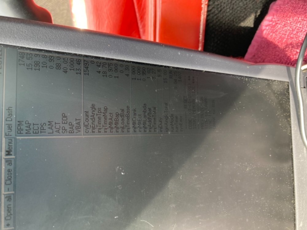

Car parameters to start
TPS shows 10.8 at idle
Idle settings (not sure what any of them do)

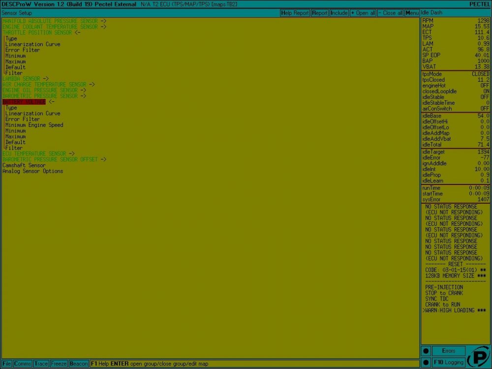

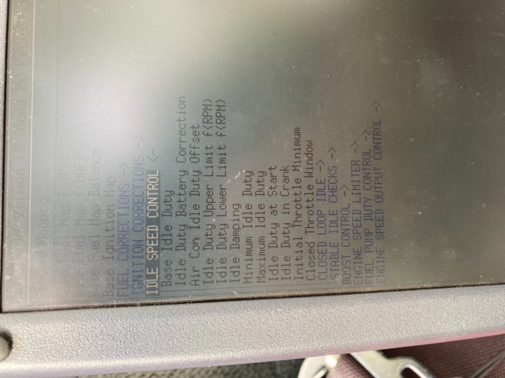

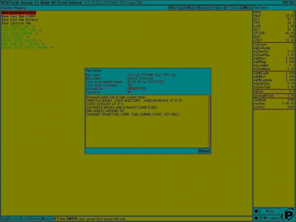

Updates:
Decided to get more serious about the tuning software and will share with the class.
*FULL DISCLAIMER* there is a chance that this monkey poking around on the typewriter at certain point in time over-wrote my original maps with one of the ones I found on the internet. It's highly unlikely (5%?) but stranger things have happened. I'm not sure how I would verify. I think you have to load a profile to start and I may have pressed the flash button years ago. More on that below.
As I suspected, my WOT is not really WOT. At pedal to the metal I'm only at about 60%. Going to the ITB's and maxing out the linkages I'm at about 75%. I have to figure out how to change that. Not sure how drastically this effected my performance but I'm sure it was at least marginal. If WOT condition had it's own maps, that means I never hit them.
Pretty pictures time

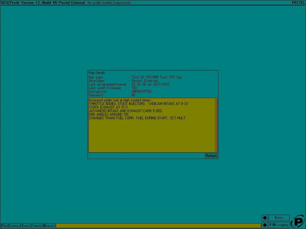

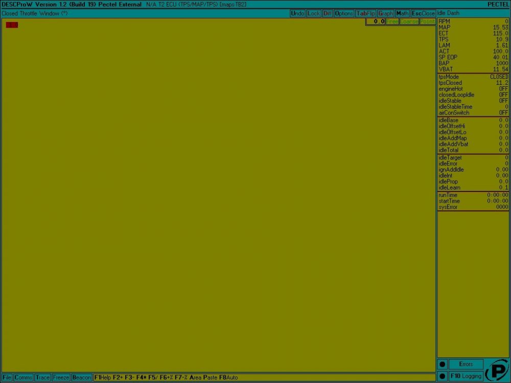

This is the welcome window that describes this loaded map. Time stamp 2002 of last update. Could be OEM?
This is a a closed throttle menu on top left. Not sure what it implies

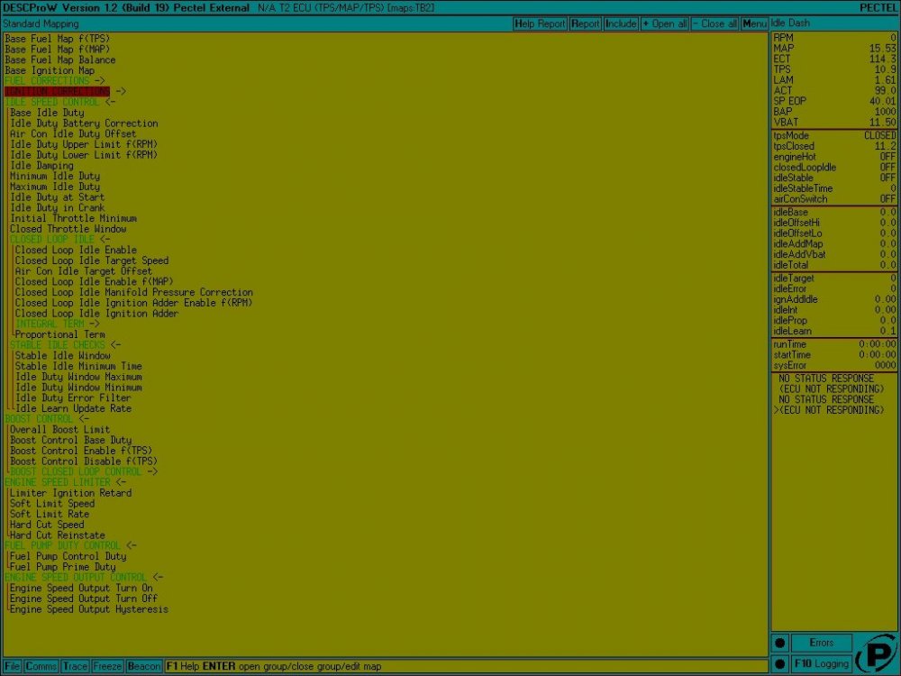

This is the open menu for the TPS sensor

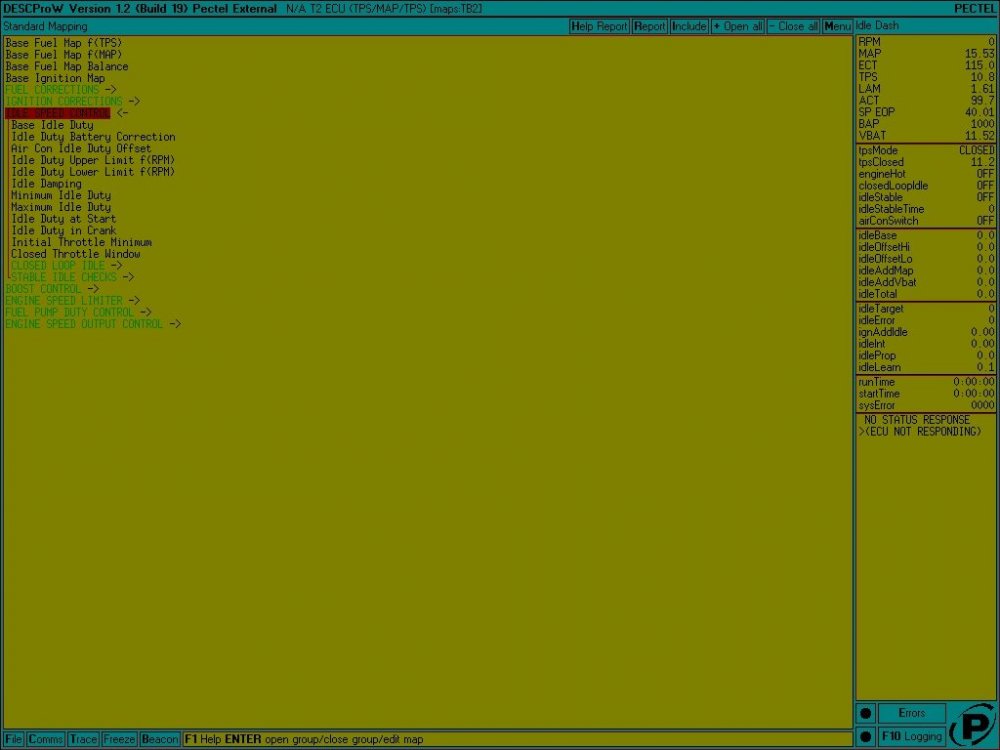

This is the IDLE SPEED CONTROL menu

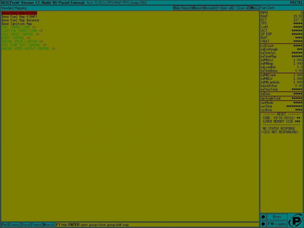

Welcome window. Loads from ECU
This is with what the car looks like on at IDLE - settings on the right. 10.6% TPS

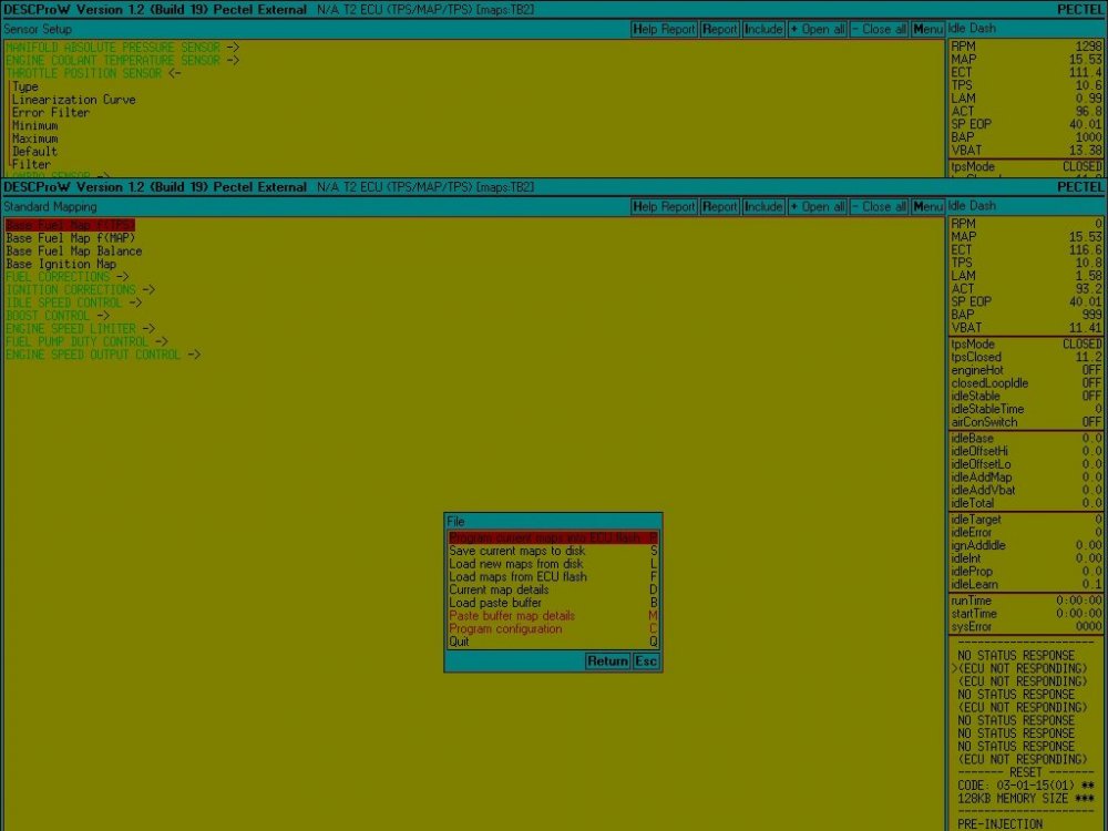

Also shows the menu where I think I may have over flashed my ECU? "Load maps from ECU flash"? I'm sure I clicked it at some point a year or two ago (as well as today)

So now that I'm in over my head I'm going to have lots of questions.
If my ITB's were physically wide open but my TPS was only reading them at ~65% does that mean that I was running lean this whole time?
If so I'm going to have to escalate my time table for wideband sensor install.
Could this have been setup like this on purpose originally?
Link to comment
Share on other sites
If it was mapped with ~90deg throttle opening being ~100% throttle and you're getting ~90deg throttle opening at 65% throttle you'd be a bit lean and the timing would be wonky too!
Take a look at your base fuel map and see what it looks like. You could map a car so actual WOT is at 65%, but the only reason I could see doing that would be you're too lazy to sort out the throttle linkage travel. You'd loose a bit of resolution, but you could make it work.
If you disconnect the throttle cable are the throttles capable of sweeping the TPS from ~0%-100%?
