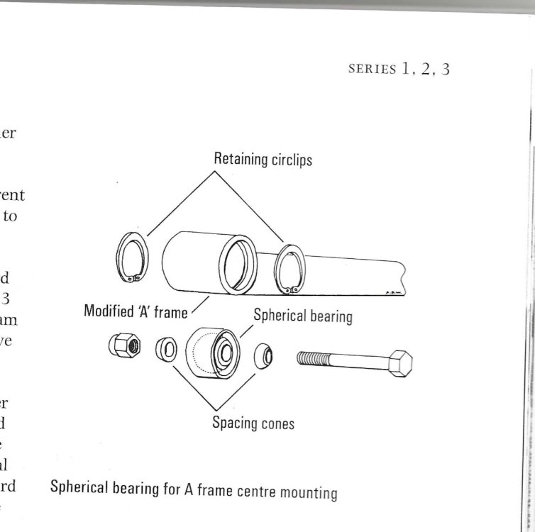

Thank you - I have a bunch of stuff coming from Bruce and was surprised when he told me he wasn't aware of the issue. Bruce is very helpful and knows the cars. Despite paying to ship parts back and forth across the country I like to get stuff from him. He guided me towards the stronger front hubs, axles and bearings, and I need to check the rear wheel bearings and upgrade those if I have the old ones. I am going to have all the suspension apart to replace the bushings with Power flex bushings. I hadn't considered how the A frame / lateral link worked, but it is under a twisting moment. I do not understand why they would do that. I am either going to replace it or at least have it magnafluxed. A friend of mine regularly runs against a guy who races a Caterham. I am going to speak to him as well. I am not putting urethane bushings in the A frame. The more compliant rubber will reduce the bending moment on the tube. Getting my car back from body work next week. Hope your car is fixed or close.
