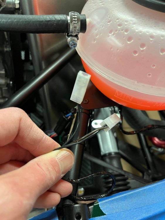

Pokey Posted October 10, 2021 Posted October 10, 2021 I'll pull the bonnet off of my car to confirm, but I believe the answer is nothing
mdork Posted October 11, 2021 Author Posted October 11, 2021 Bruce confirmed those mystery wires connect to nothing. In other news - got the steering wheel in and adjusted. Couldn’t help but do a very slow lap of my street. She feels eager! Will be away from the car for a bit before The Big Push to complete by end of the month.
KnifeySpoony Posted October 17, 2021 Posted October 17, 2021 Yep, there's another set of unused wires on the left side of the engine near the oil filter as well. I just ziptied em somewhere out of the way. Nice progress. Everything is still fresh in my mind from my build so any other questions, ask away.

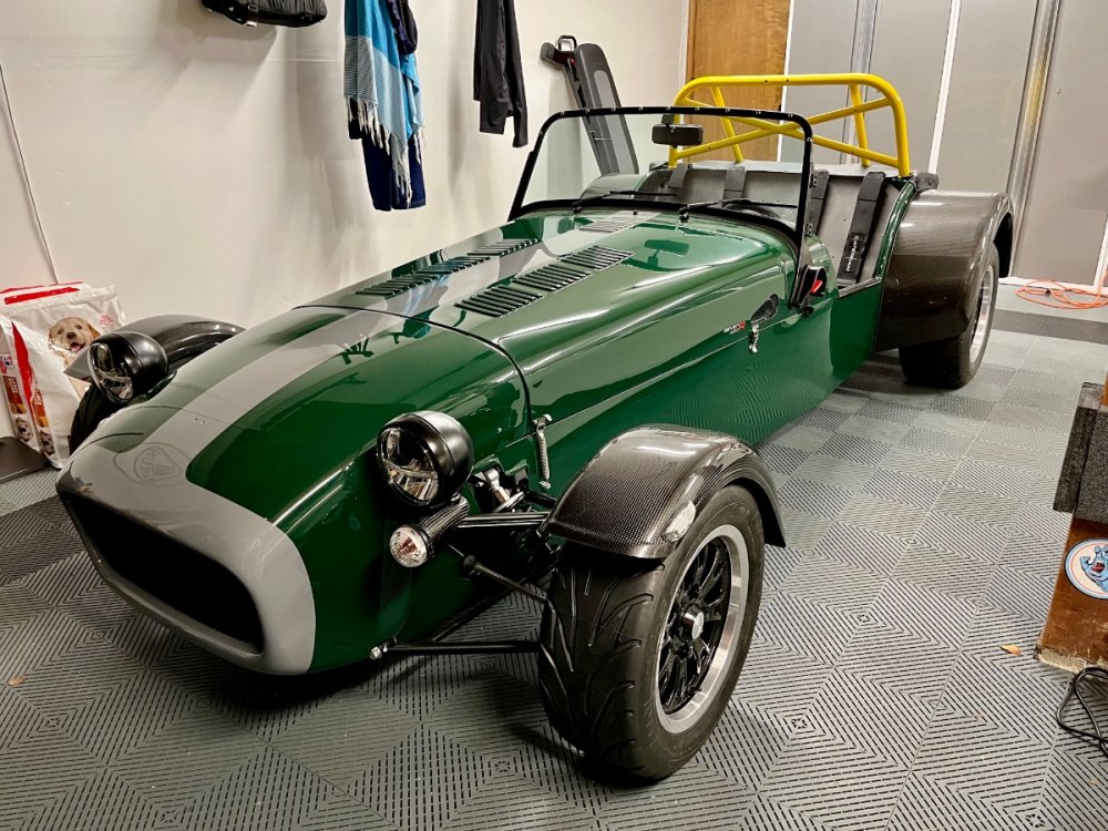

mdork Posted October 23, 2021 Author Posted October 23, 2021 Big day yesterday. Wings are on!! Took some courage to do the fronts but hopefully did ok. Love the new LED lights in the rear but Caterham don’t supply a grommet so will have to harvest one from the supplied set. Got the fuel filler cover and washer bottle in as well. The supplied wiring harness was too short so had to build a little jumper. Will do the repeaters today along with trimming the knee panels to fit. After that it’s off to Bruce before I can do the final few bits. Sadly the weather is horrid this weekend but hopefully will be out for a blat soon!
yellowss7 Posted October 23, 2021 Posted October 23, 2021 Before you install the knee trim panels, if your car didn’t come with them, you should consider getting the fixed nut windscreen brackets. That way if you decide to take the screen off and put a brooklands screen or aero screen in you won’t have to drill out the rivets to get to the nuts. Nice build. BTW. Tom
KnifeySpoony Posted October 23, 2021 Posted October 23, 2021 Or just don't install them at all. I failed to see what benefit they gave so I didn't install them. Seemed it would only make for headaches later.
mdork Posted October 23, 2021 Author Posted October 23, 2021 Too late - they’re in. Of course they didn’t fit at all without trimming but wouldn’t expect anything less. 🤣

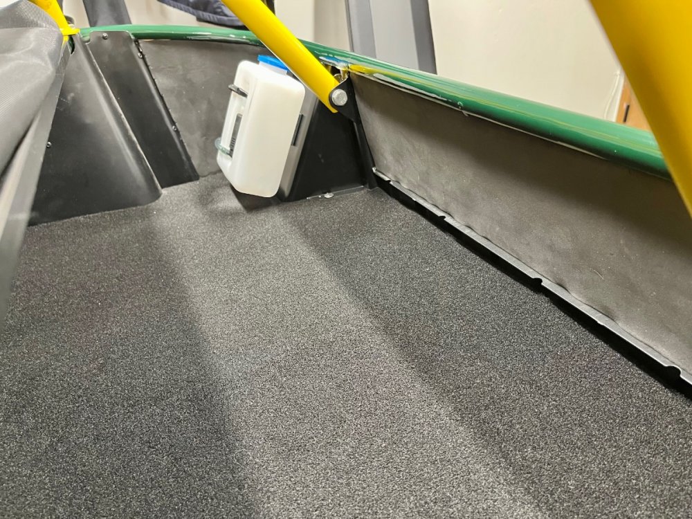

mdork Posted October 27, 2021 Author Posted October 27, 2021 While waiting for a few bits needed to install my repeater lights I decided to make some simple protection for the boot skins using a roll of neoprene. May not win any design awards but I’m happy with the result
Anker Posted October 27, 2021 Posted October 27, 2021 Great idea. My back skin has a couple of dents caused by stuff sliding around in the boot!
kayentaskier Posted October 28, 2021 Posted October 28, 2021 looks great, but you're missing the seats
