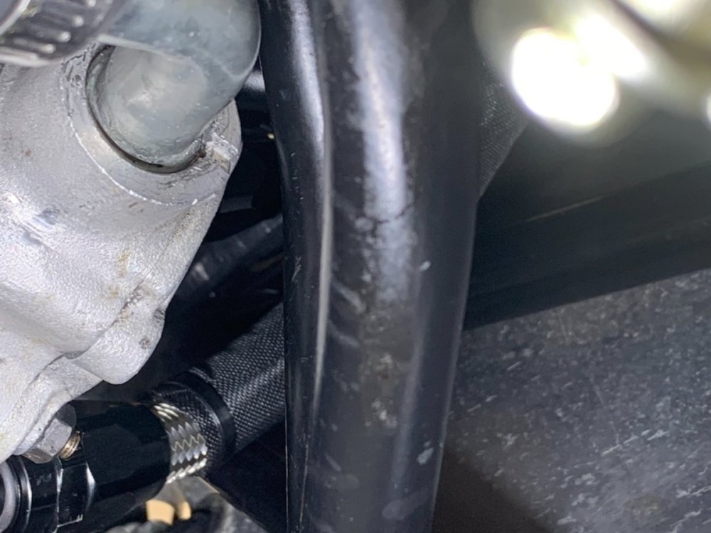

wdb Posted November 15, 2024 Posted November 15, 2024 On 11/14/2024 at 10:39 AM, wdb said: I'll get a picture of my oil pump vis-a-vis the engine mount. I don't recall it being a tight fit there. The oil line that arcs over it, up and back to the filter, was a bit of trick though. The hose ends are not fixed; they have a built-in swivel joint. I added a wee bit of length to the hose to encourage it to swivel upwards enough to clear the mount. (That was the hose I ended up making twice.) Here you go. Yep it's tight, probably 1/3" in there. But no movement of one relative to the other, so, enough. Second pic is of the oil line that needs to clear the same mount in my case. It's the oil pump high pressure inlet so if your tank is behind the pump you will likely have to deal with the same thing.
