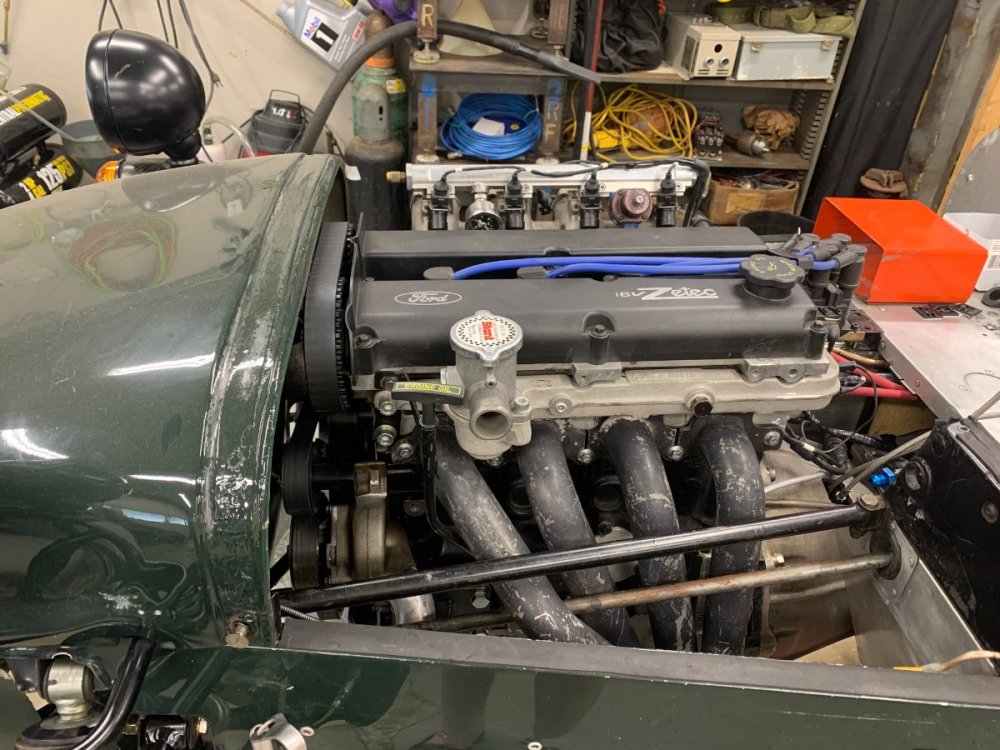

Gus and I finally got the engine dry fit in the car but we did discover two problems that we now need to address.
1. The new engine mounts from Raceline hold the motor 1/2" higher than the originals, this means the hood and the nosecone will not fit as they foul on the cam cover. The new mounts are beefier than the original Caterham ones so we have some work now to modify them to allow the engine to settle in properly :(
2. The Oil filler cap on the new Retro Ford cam cover (BDA style) sits quite proud and is touching the underside of the hood and is also positioned exactly at the intersection of the hood and nose cone, so does not work as is. The solution is to machine a lower profile oil filler cap similar to the one below that I knocked up in tinker cad to illustrate my thinking. The main question is does anyone know what the thread is for a oil filler cap to fit a Ford Focus SVT (which apparently is what the thread is)?

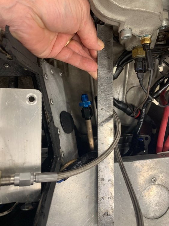

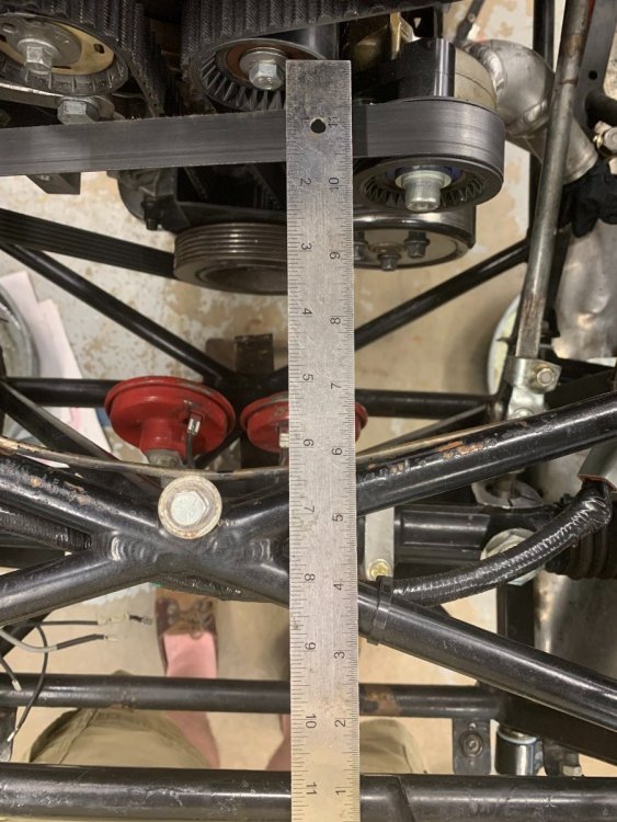

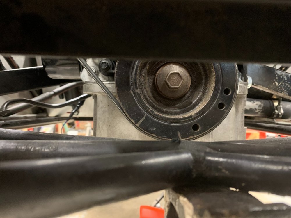

I have some pictures for you to look at from my car. I believe we have the same car. Mine is a 1999 or 2000 S-3 Zetec. I measured the oil cap on my car and got 3 treads in 7.64 mm. I think that is how you do it for metric. Imperial is threads per inch. Anyway, that would be 2.55 so I am guessing 2.5. Perhaps someone can jump in who actually knows how to measure threads. If your oil cap is at the intersection of the hood and the nose the engine might not be far enough back. Here are some pictures. The picture of the crank pully shows how low the engine should sit. I spoke to Gus yesterday about that. This picture was taken with a level on the camera, and the little tit sticking up in the picture is the jackstand the car is on. 2010657855_enginetonose.thumb.jpg.04a72c29ad30f4ac7dffbb745ac7139d.jpg43207720_frametoengine.thumb.jpg.d7e860ad6f0b0cdee349dd4d205eef66.jpg876098514_FrontPully.thumb.jpg.cc9f8261d60a82ba6a2087a4c119db48.jpg

Here are the measurements you were looking for and some pictures. The first measurement is from the back of the cylinder head to the fire wall 8 1/4 inches. 2124938394_Backofenginetofirewall.thumb.jpg.d92e8ff0c1094653fac92ce36ff0fdc8.jpg

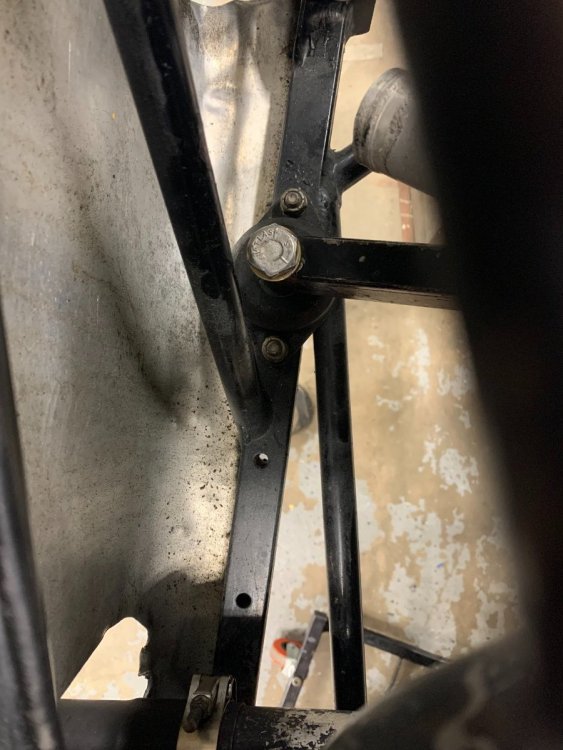

Here is a picture of the motor mount to the vertical frame member that has the lower rear control arm and the upper rear control attached to it. the distance from the vertical tube to the middle of the motor mount bolt is 7 5/8 inches
