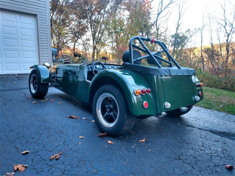

11Budlite Posted September 22, 2022 Share Posted September 22, 2022 21 hours ago, CBuff said: Are there other options that accomplish the same thing but maybe have a more traditional look? If you're really looking for something traditional there are many forms of rear lighting that were used over the years for Lotus and Caterham Sevens. These included Lucas, Wingard, and Thorpe. When I ordered my Caterham I had hoped that that the ugly fog and reverse lights were not going to be installed. That was not to be, so I did some careful measuring and came up with a plan to install some traditional Lucas L594 'Beehive' lights that would cover up the existing holes in the rear body and fenders and would not preclude installing the original Caterham lights in case I wanted to go back. There was a fair bit of wiring involved to utilize the existing Caterham connectors (forgot the name of them, Econoseal maybe?). It was also similar to what Caterham was supplying with their Super Sprint model from a couple years back. I also changed out the black plastic license plate light cover to a chrome plated version that I had in my parts stash from my first car, a '61 Bugeye Sprite. Here's a photo showing what it ended up looking like. Not for everyone but I like it. Even put LED bulbs in to brighten them up. Link to comment Share on other sites More sharing options...
