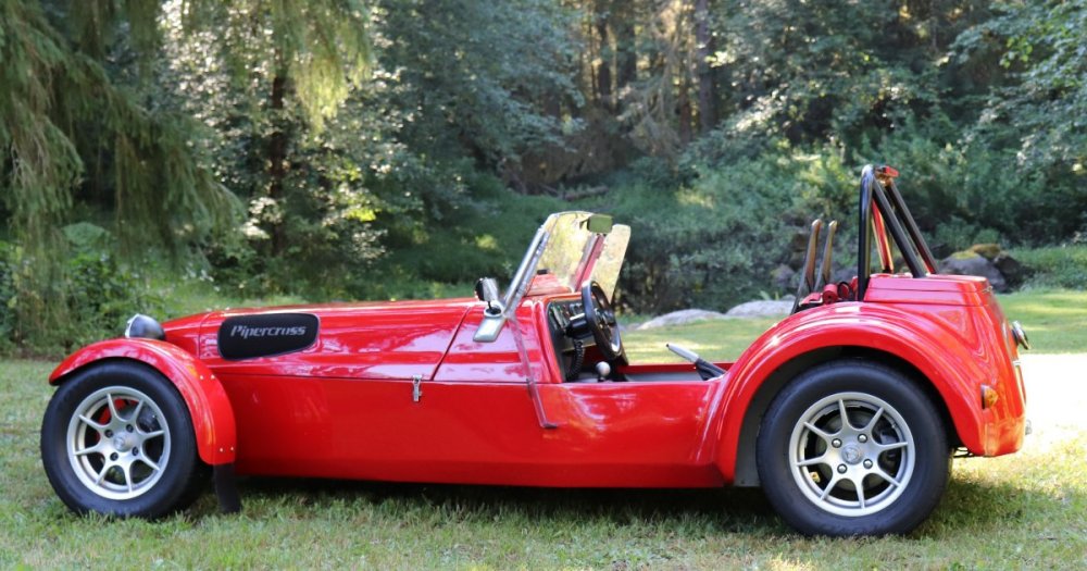

The first photo shows 14" Two Gates wheels, the second are silver 13" Caterham wheels from 2009.  I'm sure someone here can add more details on this wheel, either the model name or the years they were offered by the factory.

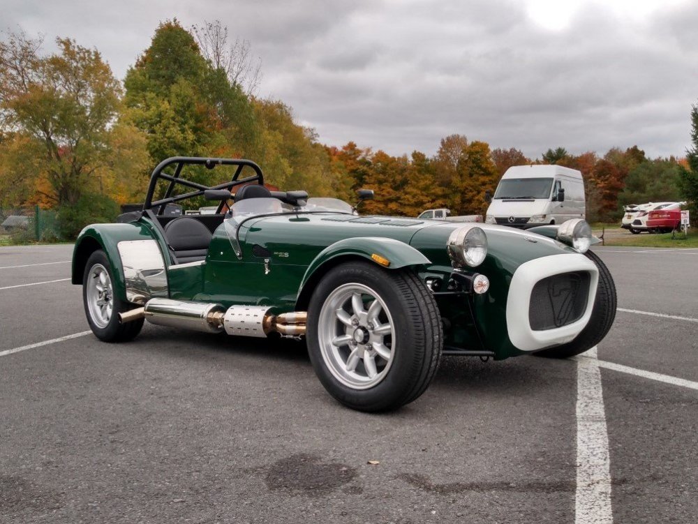

Stock 14x6" Minilite-type wheels on a 2019 Caterham.

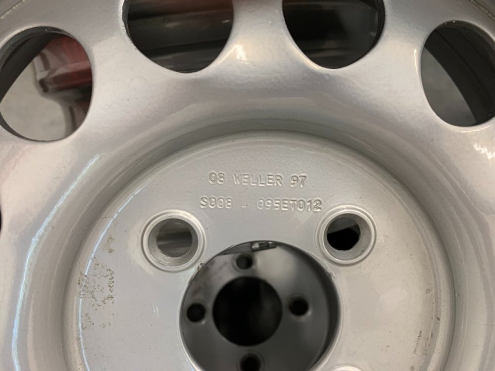

This is timely. I received 3 of these wheels with my Caterham and was hoping to find out more about them, possibly even procure a fourth. They're steel, labeled "Weller Racing". 13" x 5-1/2".
Stamping: 4 (lug) 95 (95mm/ 3.75" pcd) ET (offset) 12 (mm)
Try Triumph forum classifieds.
Standard spitfire 13x4.5 can be "rehooped" with new rims in whatever size, width, and offset. Ministock generally does not come in that bcd/pcd but probably could be ordered but again, would not match the oval holes of the three you have.
Larger 7/16-20 studs can also be fitted to the original 3/8 stud holes in the hubs without modification.

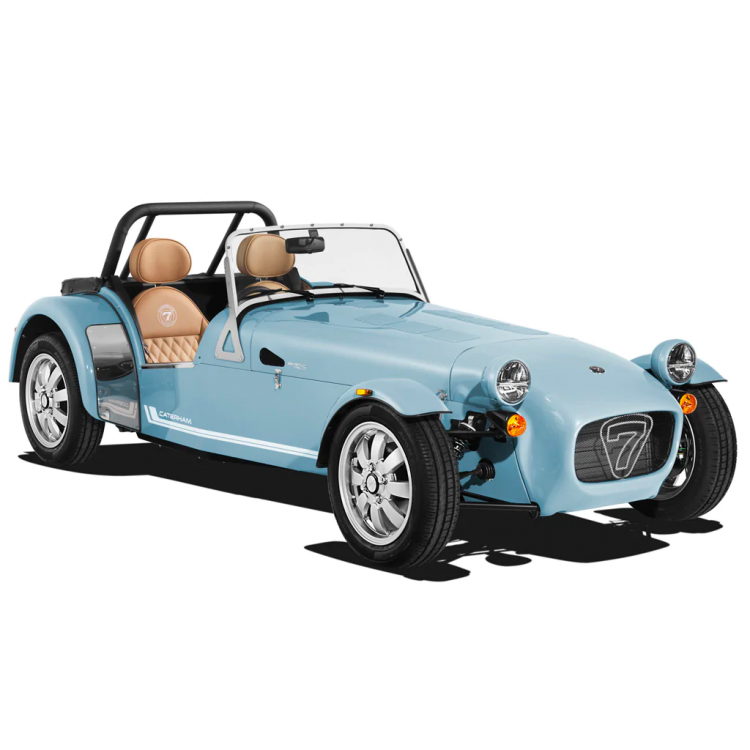

Those style of wheels were used on the first iteration of the Caterham 7 160.  They are much narrower than the standard Caterham wheel.  14x4.5 dimensions so different.  Not sure if Weller made the Caterham versions but they are similarly styled.
The latest version of Caterham 170 has this big spoke wheel.  Same dimensions as the Weller wheel posted above by WDB.

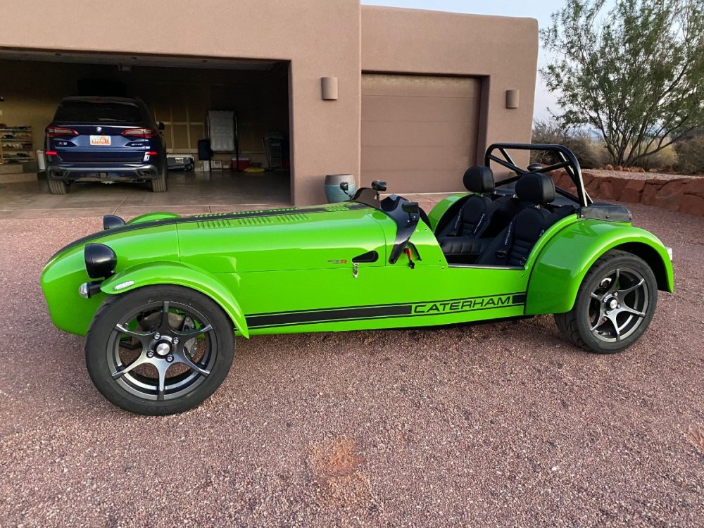

They were the Caterham Orcus wheels.  Offerred from around 2007 to 2014-15 area in both 13 inch and 15 inch sizing.  Widths were a 6 inch for fronts and lower hp rears plus a wider 8 inch rear for the higher hp cars.
Finishes were a dark gray plus the lighter silver in the photo quoted.
Once thing to note with the Orcus wheels is that there were two types - one where the spokes came out and extruded over the rim (look at Kayentaskier's lime green car photo early on this thread) and the other where the spokes were recessed behind the rim (like John's red Westfield above and my CSR below).

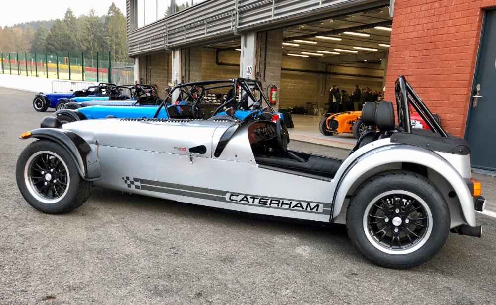

The standard chassis Caterham ran with the Apollo wheels from 2015 up until recently.  Two finishes - diamond cut outer rim with black inner and then an all polished silver look.
