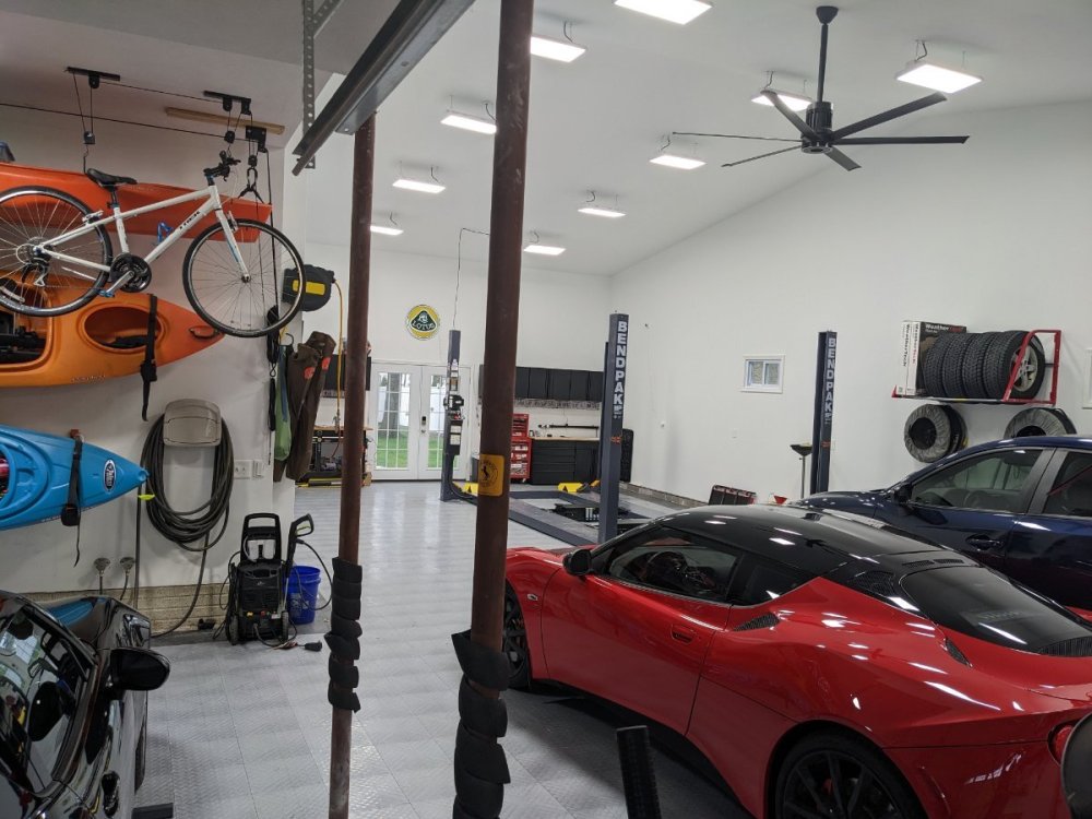

hyper7 Posted February 26, 2024 Author Share Posted February 26, 2024 Yeah, it was a big project a couple years ago - We had 3 cars (2016 Mazda CX5, 2016 Subaru WRX, 2014 Lotus Evora) in a 3 car garage, and my wife decided she wanted a Miata (2021 Miata RF) so we needed more space....after it was finally paid for, I got the approval from her to order the Caterham kit. Its been a part of the long game, finally paying off. We tore down the third bay and did the "new" portion of the garage - its 23' wide by 45' deep. 14' ceiling at the low spots. We've had my buddies full size truck up on the lift with room to walk around under it. I love my garage 1 1 Link to comment Share on other sites More sharing options...

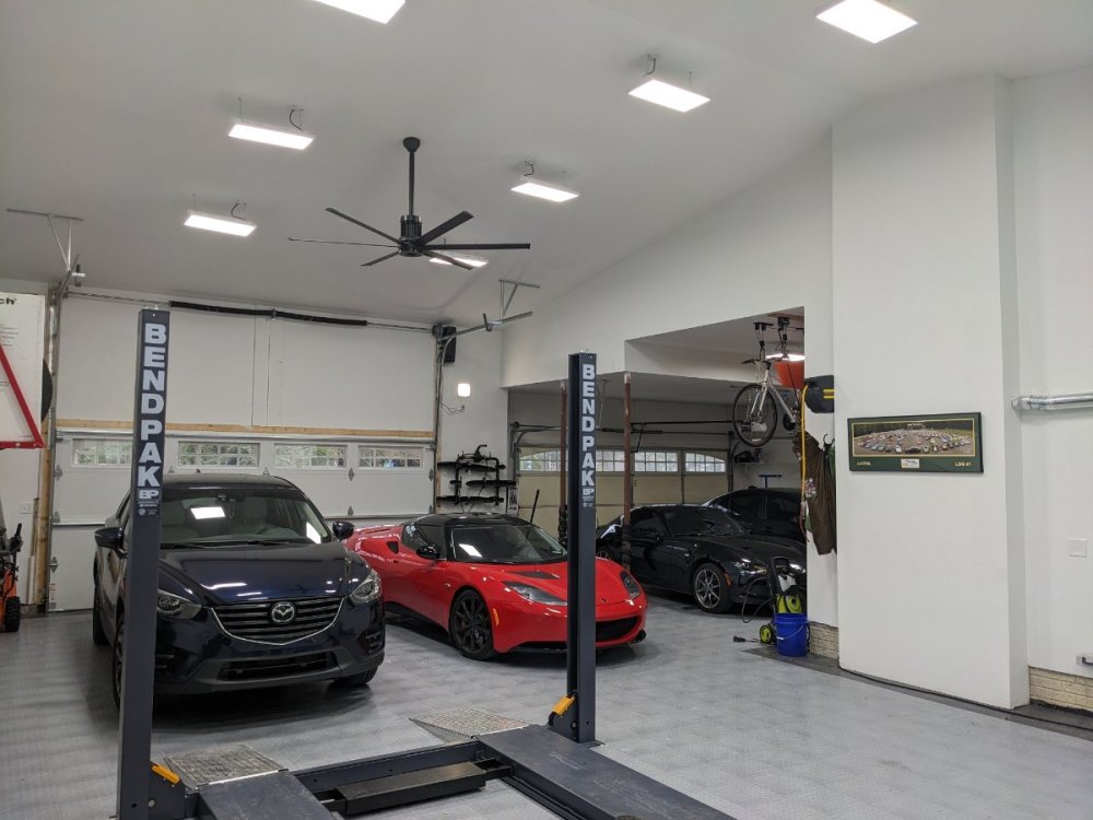

hyper7 Posted February 26, 2024 Author Share Posted February 26, 2024 The reverse view of the garage.. 3 Link to comment Share on other sites More sharing options...
Vovchandr Posted February 26, 2024 Share Posted February 26, 2024 I think your garage is bigger than my house! Congratulations. Good luck with the build. I've never build my own so I don't have much to contribute in that department. Link to comment Share on other sites More sharing options...

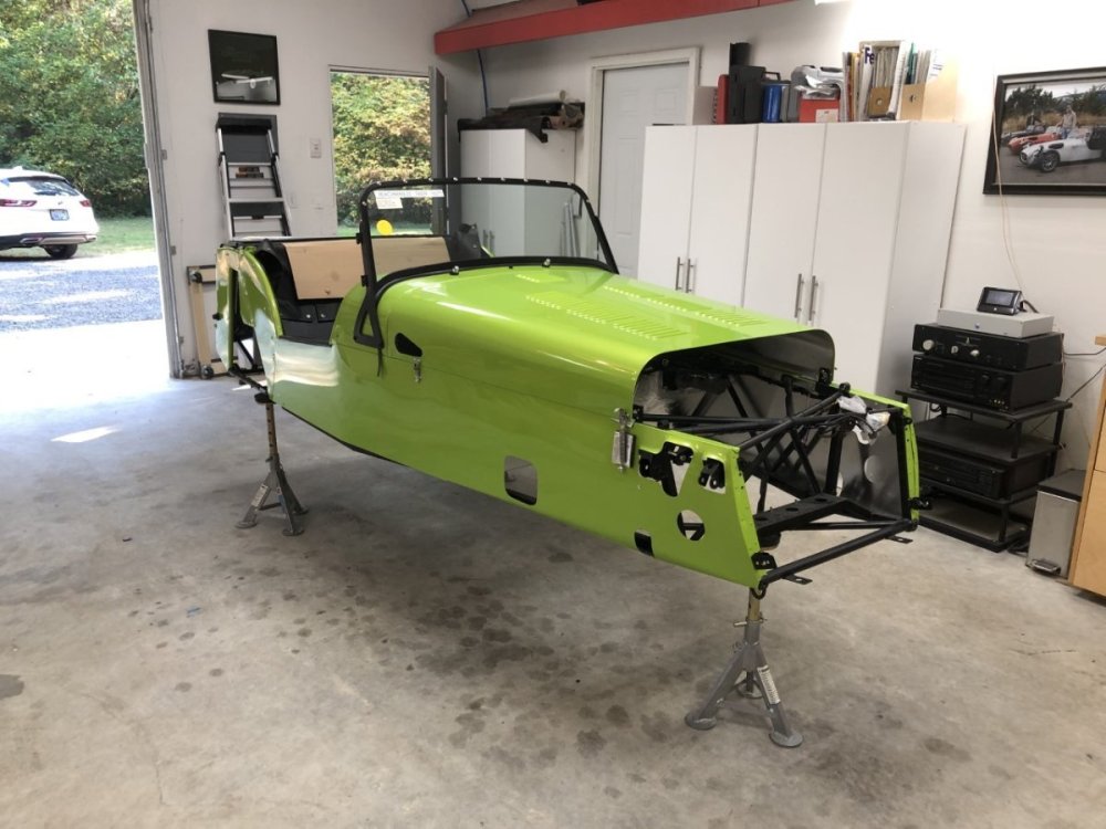

Mark IV Posted March 3, 2024 Share Posted March 3, 2024 We suggest sawhorses rather than jackstands, much more stable. Harbor Freight has some adjustable height horses that work well. Go to the dollar store and purchase some "pool noodles". Slit them and tape over the top bar of the horses. The noodles are also very handy for the bonnet; you can slit them and place over the end to stand the bonnet up or on the bottom edges to lay it down with no paint damage. "Road Wrap", the clear low tack plastic wrap is great to cover the paint work on the chassis and wings while assembling the car. It will prevent many "oops" that WILL happen during the build. Caterham shows silicone spray being used for hoses to allow them to slip on easily, it also allows them to slip off! We prefer some dish detergent and water to lubricate, it is water soluble, so it mixes with the coolant. 2 Link to comment Share on other sites More sharing options...
hyper7 Posted March 3, 2024 Author Share Posted March 3, 2024 Yeah I saw on one of the links that @CBuff provided they used "pipe lagging" which looks exactly like pool noodles. So you're recommending sawhorses over mobile stands? Does it make sense to make them mobile? Link to comment Share on other sites More sharing options...
JohnCh Posted March 3, 2024 Share Posted March 3, 2024 You'll get differing opinions on how to support the car during the build. If you are building it in a location that can't remain blocked for months on end, or doesn't provide enough working room around the car to easily perform all the jobs, including adequate space up front for the cherry picker, then mobile stands will create fewer moments of frustration. If those things aren't issues, then you have to ask yourself if you will ever move it if you have the option? Stands/sawhorses vs. jackstands is another one I initially debated. A desire for wheeled support basically eliminates jackstands from consideration. If you don't need that -- I didn't -- then it comes down to a few considerations: Height, stability, and access. For me, I didn't want the car so high that it forced me to stretch my arms unnecessarily when laying on my back under the car, nor did I want something that could potentially get in the way for some jobs. Given my jackstands provide sufficient working height, have always felt very stable when doing major jobs on the Westfield, and have the option of using either one or two up front thanks to the cruciform jacking location, I opted to stick with what I know. During my build, there was never a time I wished I had gone with a different setup. That doesn't mean they are right for you or for others, but things to consider. -John Link to comment Share on other sites More sharing options...
