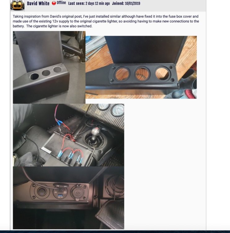

CBuff Posted September 10, 2024 Posted September 10, 2024 I was thinking of something like this over the winter.

Vovchandr Posted September 10, 2024 Posted September 10, 2024 On 9/10/2024 at 4:04 PM, CBuff said: I was thinking of something like this over the winter. Expand I have that 12v attachment metal part and for the life of me cannot figure out how to make it attach. Maybe early years dash setup was slightly different of the fuse box has different shape?
