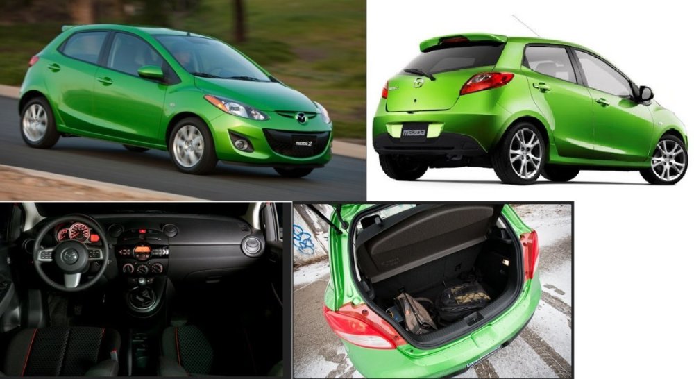

Croc Posted January 5 Posted January 5 13 hours ago, MV8 said: Mazda 2/Demio 5 spd. Every so often a post on USA7s stops me dead in my tracks. Genuinely confused here. What has you thinking this is a good choice for longevity over any other car? You are thinking outside of the box in a way my little mind cannot comprehend right now other than manual transmission is a good thing. Parts supply will be same if not worse as any other Mazda. Its chock full of plastic componetry, 50K mile mandatory replacement parts, emissions gadgetry, etc. Its genuinely a sophisticated little commuter car - quite a good one. Wouldn't this preclude it from @Vovchandr 's group of contestants? 1

MV8 Posted January 5 Posted January 5 (edited) 4 hours ago, Croc said: Every so often a post on USA7s stops me dead in my tracks. Genuinely confused here. What has you thinking this is a good choice for longevity over any other car? You are thinking outside of the box in a way my little mind cannot comprehend right now other than manual transmission is a good thing. Parts supply will be same if not worse as any other Mazda. Its chock full of plastic componetry, 50K mile mandatory replacement parts, emissions gadgetry, etc. Its genuinely a sophisticated little commuter car - quite a good one. Wouldn't this preclude it from @Vovchandr 's group of contestants? Where to begin... I bought the older Mazda2 2nd gen (07-14) to replace my last mazda econobox which had over 350k miles and was still going strong when it was totaled last year. It is a very basic car, with rear drums, traditional one-piece flywheel (versus dual mass), a clutch slave instead of a hydraulic release bearing, schematics are available, timing chain versus belt, etc. Think of it like a '90s Mazda 323 (funny that the wheels will interchange). It is so basic, it has no temp gauge; just a blue led for when it is cold and a red led for when it is too hot. Yes, I will be adding a gauge for personal comfort but the point is, it is basic, efficient transportation. However, my wife took it almost immediately, so I am driving the 30+ year old Mazda 323. I don't know anything about the 2015 and newer models. Edited January 5 by MV8 1
