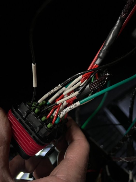

Thank You for putting this together. Can you tell us what tools and shrink wrap you use to make your labels?

I got this label maker that prints on shrink tube cartridge. It’s over kill but works well
https://a.co/d/c22XIey
I also got clear shrink tube that you can use regular labels and just shrink it on
https://a.co/d/1VQ5213
this was using the label maker printed on shrink tube.
I didn't know that exists.  How well does it work and how well does the heat shrink and printing hold up?  I was planning on using Dymo labels covered by clear heat shrink on my project, but this would save a lot of time.
It’s only be on for month so hard to tell the long term durability.  But I have wiped them down with solvent and it doesn’t smudge.
the smaller the wire the more it shrinks and the smaller the text gets. But still legible even on 18gauge tefzel which is prob equivalent to 20 or 22 gauge.
if it was really exposed (under the car) I might throw some clear heat shrink over it.
I tend to mark the awg on the label because the printed one on the wire is next to impossible to read.
Edited by CBuff
Thanks, I may give that a try.  Wrapping the dymo labels around small wire seems fraught with redo opportunities given my ham-fisted nature.  As you note, I can always top it with clear heat shrink.

I use a standard Dymo brand label maker with a 1/4 inch wide adhesive backed ribbon, to print the labels, and McMaster-Carr part number 73095K43 clear Polyolelfin (trade name Kynar) shrink sleeve.
My original plan was to use a shrink sleeve label printer, like others have mentioned. I had purchased a really nice shrink sleeve printer for this harness build, but somehow lost it when my wife and I moved houses.
