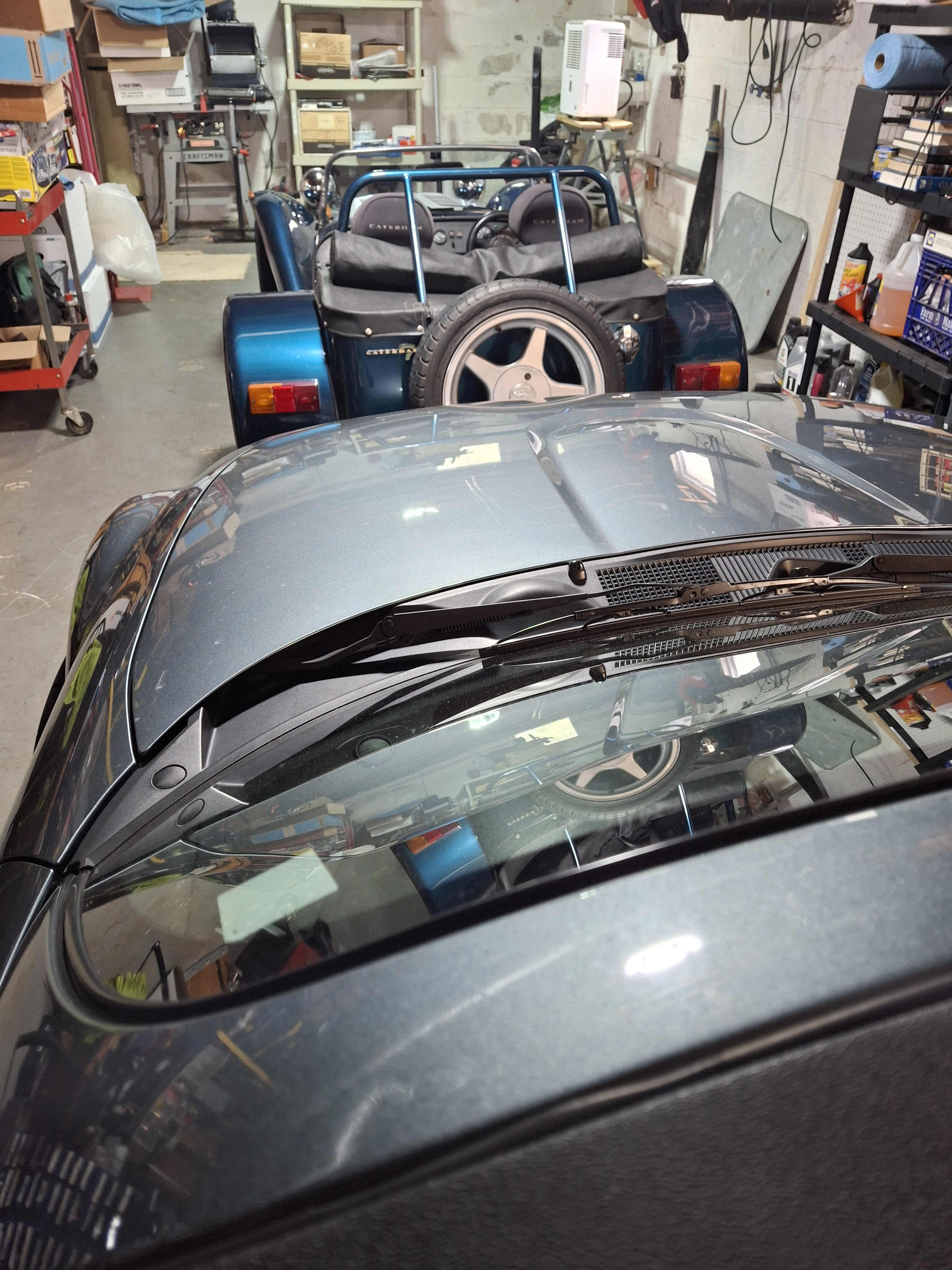

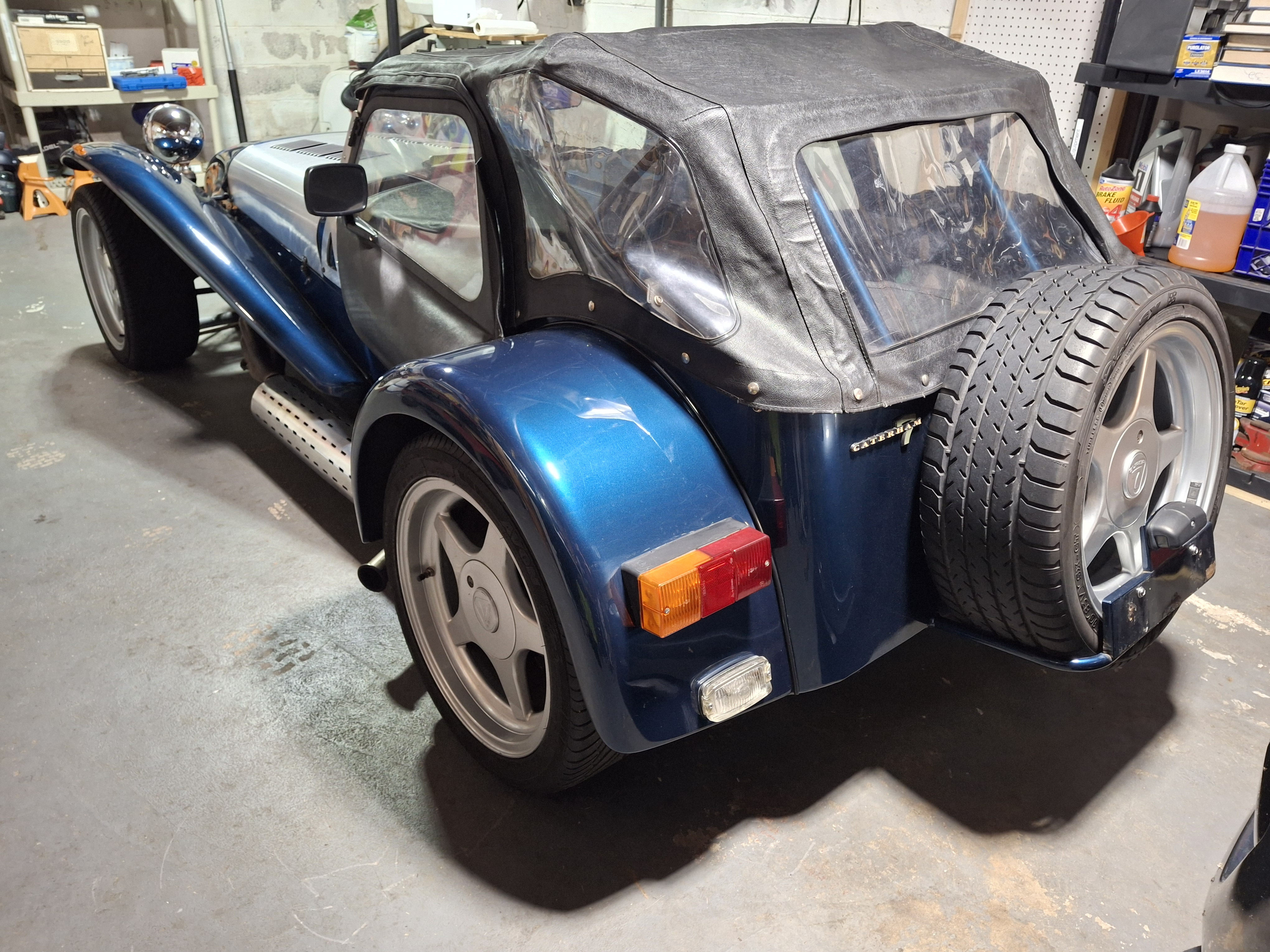

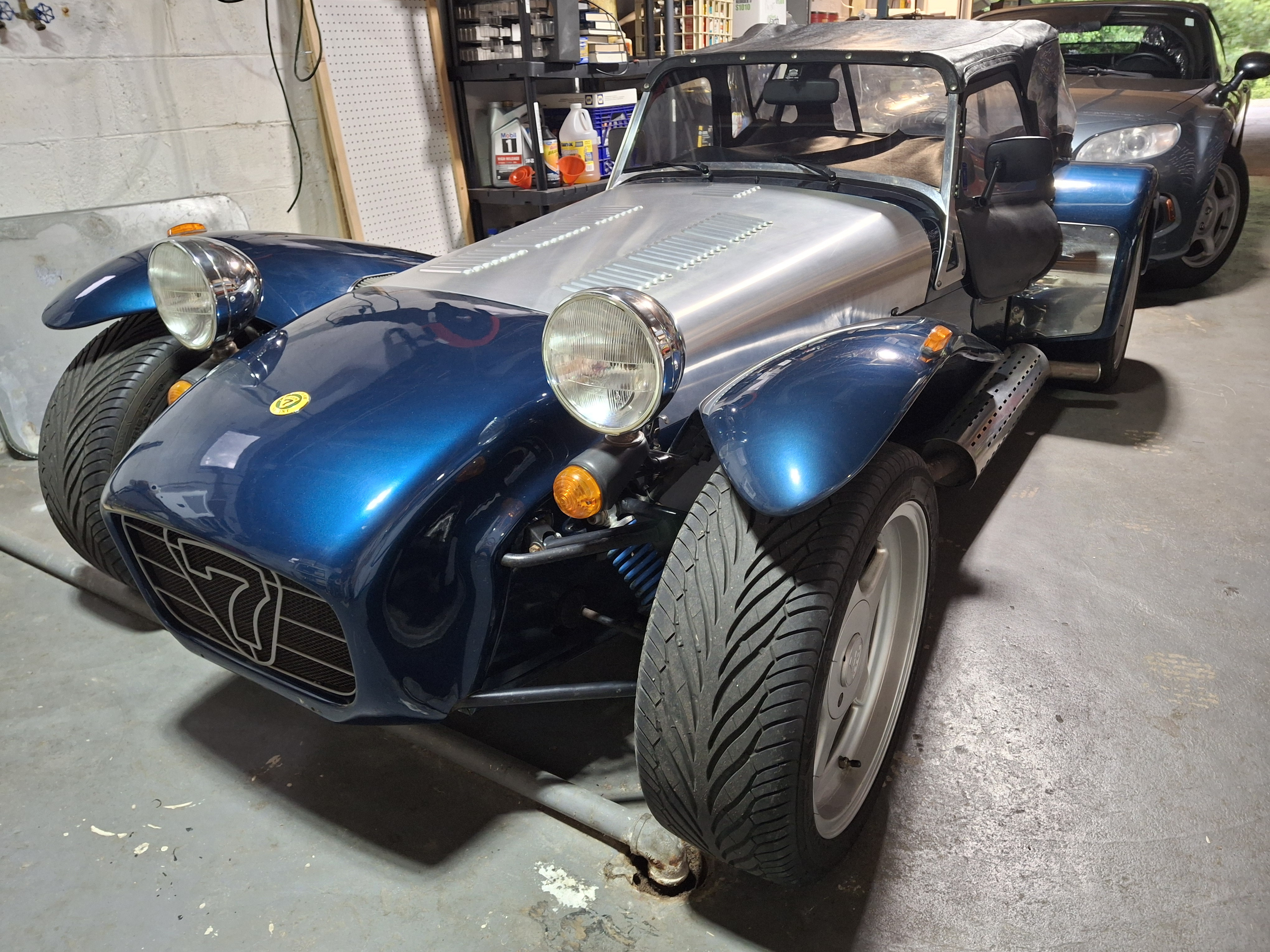

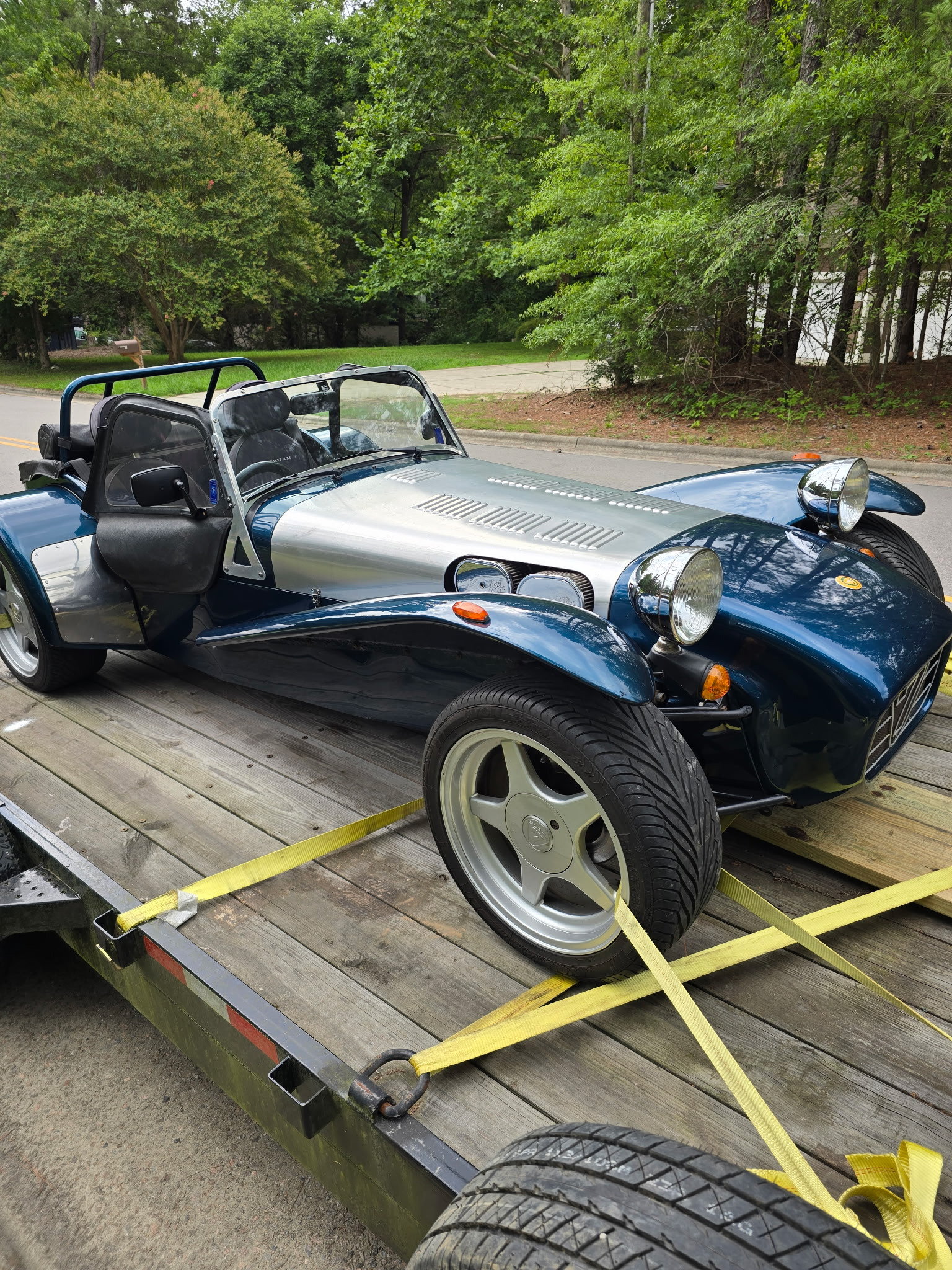

gde31ff Posted 13 hours ago Posted 13 hours ago I picked up a BAT auction car today & my first impressions are really good. The car is going to live in Piedmont Triad NC. Based on my limited knowledge, the car looks quite stock. I'm really no fan of 16" wagon wheels, but I don't have any $$$ at this point, so I'll live with them (unless you want to trade your 13" minilites!!!) Want to hit me with some advice?? I need a top 10 list of items you'd think about addressing first just to get the car reliable for some Blue Ridge blasts. Things you wish you didn't put off when you became an owner? Somewhat related - gentleman who arranged sale regularly imports European cars in Durham, NC. He said it's about a $3000 project these days with tarrifs & fees. He's a TVR guy himself - but he had the car I bought imported a few years ago. Appreciate the help I've already received here. Looking forward to crossing paths out in the wild someday.

CBuff Posted 12 hours ago Posted 12 hours ago I would do a full nut and bolt check. I believe there are torque specs in the files here. Or I just saw mentioned @SimonRogers built an app that outlines torque settings by car bat listing says brakes were flushed in May 2026. But maybe check other fluids. Trans, diff, oil, coolant. Replace if suspect or unknown. i am limited in my mechanical knowledge. And carbs are down right voodoo to me. But I would think going thru the carbs would be prudent. checking all hose connections and conditions. tires seem to be date coded 2012 so you should replace those even if you keep the wagon wheels. After the above are done just drive it. Other items will make themselves known. 2
