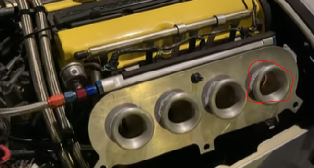

In the meantime, Borla/TWM got back to me with some interesting information
There is no TPS adjustment on the ITB's. Confirmed.
They also said that 10% voltage at idle and 90% at WOT are normal. 10% at idle I can see, injectors need to be firing at least some fuel without IAC to keep engine spinning. 90% at WOT as normal was surprising to me.

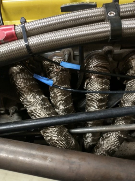

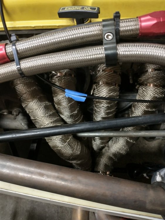

You know how all great aviation failures are a combination of multiple events gone wrong?
Well I'm discovering that besides my out of control revving yesterday I've discovered that my throttle is getting stuck as well. Different symptom different fix. Occasionally upon coming to a stop my throttle would need a hard push on the pedal to "break lose". Yesterday driving home my throttle would get stuck while accelerating and I would have to hard blip the throttle to let it settle back down.
This is on a brand new cable/housing.
I've taken the whole thing apart and measured out the location where it gets tight/stuck. It's right above the exhaust.
Compared it to the old throttle cable I replaced and it would get tight right around the same area (marked with tape).
Not sure what my current solution would be for this. Cable seems fine in a new housing. These have a plastic liner inside to help them glide easier being motorcycle cables.
I'll either have to have a cable set without the liner or find a better routing.
As of right now since only replacement I have on hand is with plastic liner I'm going to try a slightly different route.

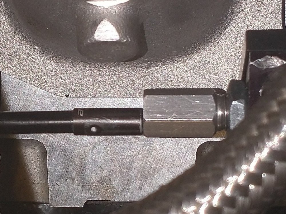

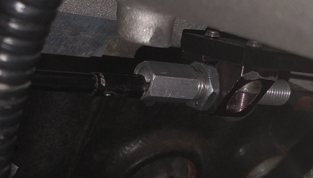

I think I just solved one problem. The partial throttle input is likely caused by my cable shield popping out of the housing and getting stuck on the housing. This is the first time I've gotten to observe it and catch it.
Checked the ecu and it's reading 20% TPS when it gets stuck, which explains at least some things.
It's the black shield stuck on silver bung. Will fix tomorrow and continue texting.
