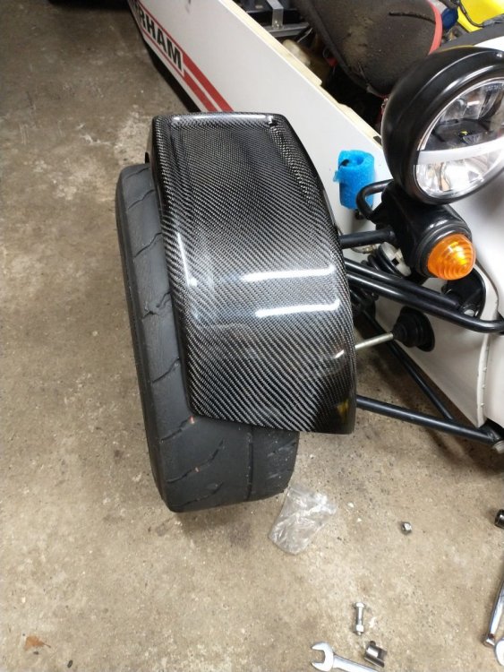

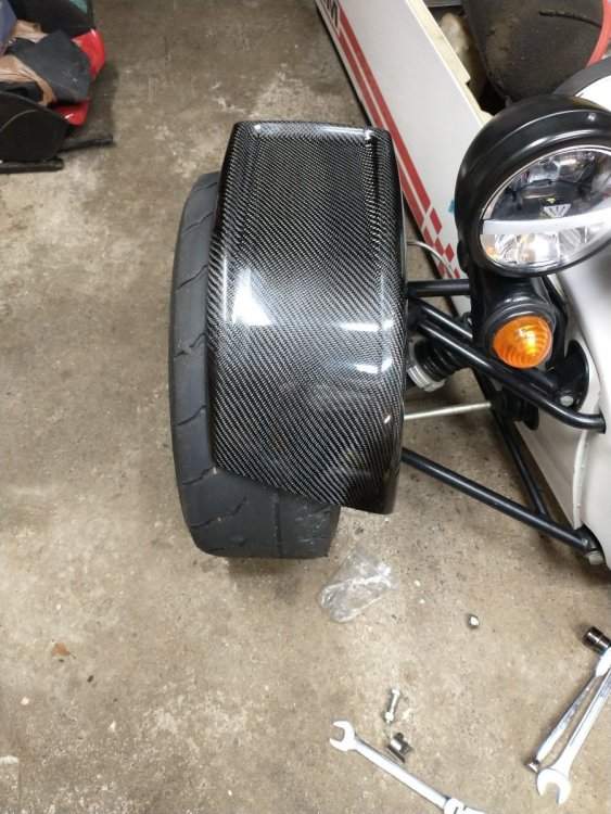

Vovchandr Posted October 12, 2021 Author Posted October 12, 2021 (edited) 22 hours ago, ashyers said: If you decide to give up on the Pectel unit don't bin it, I may be interested. Andy I'd think about it, but fore-warning. I get rid of very few parts... In other news I got hit with a nice case of hindsight being 20/20. I knew that CSR has a different offset but for some reason I expected the CSR cycle wings fit with CSR wing stays on an S3 just fine. Quickly learned thats not the case. Westermann sells appropriate lighter wingstays and I might end up going that route instead of bending what I have now. Still debating. They aren't the cheapest thing on the planet https://westermann-motorsport.com/en/produkte/superlight-cycle-wing-stay-csr-type-wings @SK400 - I assume you got westermann stays too or did you use existing Caterham ones and make them work? Edited October 12, 2021 by Vovchandr
SK400 Posted October 12, 2021 Posted October 12, 2021 Yep - Got the westermann wingstay. saved 1.4 kg of weight from original wingstays.
Vovchandr Posted October 12, 2021 Author Posted October 12, 2021 1 hour ago, SK400 said: Yep - Got the westermann wingstay. saved 1.4 kg of weight from original wingstays. That explains a bit. I'll likely try to bend these over the winter as there really isn't an existing second market for CSR stays in US, or otherwise also order the aluminum ones. They also lighten the wallet too! How did you end up securing the front/back? I assume you likely glued the back but did you actually use the bolt for the front?

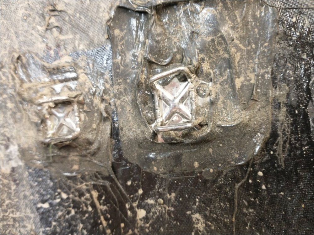

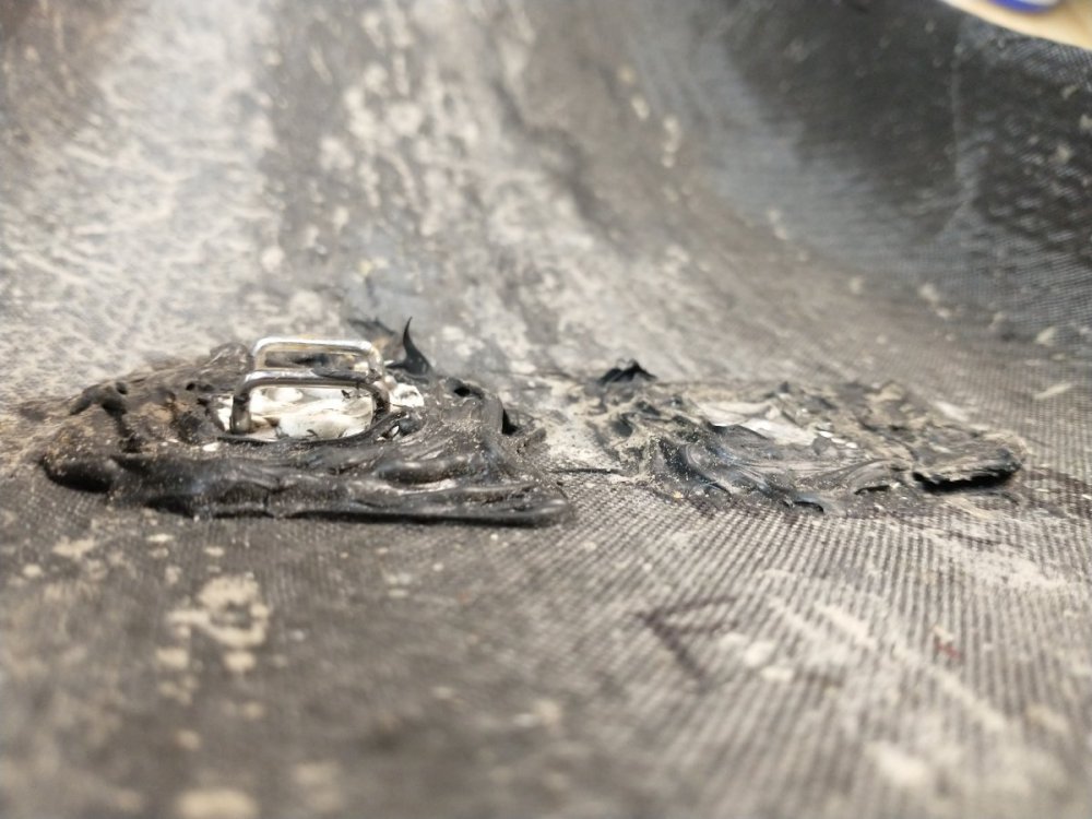

Vovchandr Posted October 13, 2021 Author Posted October 13, 2021 (edited) Another track year, another set of failing BigHeads fasteners. This time around im going to see if some reinforcement welding can be added in weak failing points at the bends. The glue held fine so far for year 2 and 3, the actual metal fatigues and fails. Glue is so strong it's actually a bear to remove. I refuse to hard mount the fenders. I only imagine that the situation would only cause more trouble in the future and I like the ability to swap over fender mounts as needed due to different tire and wheel sizes (I have high and low fender mounts now) Edited October 13, 2021 by Vovchandr
Vovchandr Posted October 15, 2021 Author Posted October 15, 2021 Reinforced some of the existing mounts with JB wild as an attempt to make them better. Couldn't have them welded while mounted due to likely damage to CF and wasn't going to remount all of them. Will get replacement units reinforced in meantime. Also discovered that there is always something new to find. My left and right fairing stays are different. Not sure why or how but they have different width spread and aren't interchangeable. Luckily I have new race mounts to make it all work. Race mounts march one side but not the other
