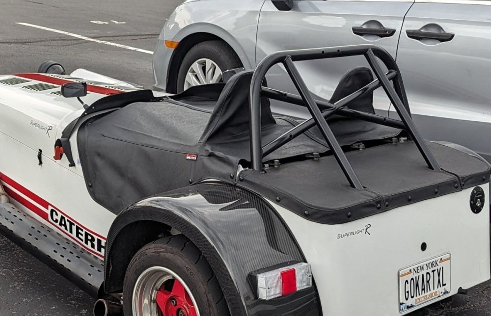

CBuff Posted August 15, 2024 Share Posted August 15, 2024 Looks sharp. Four years before you used it - that makes me feel better about not using all my pieces yet. I had the full hood on last weekend for pending rain for the first time. Didn’t drive it with it on. But got some practice putting it on. Still prefer the half hood 1 Link to comment Share on other sites More sharing options...
wdb Posted August 15, 2024 Share Posted August 15, 2024 But now you know it fits. Silver lining. Link to comment Share on other sites More sharing options...

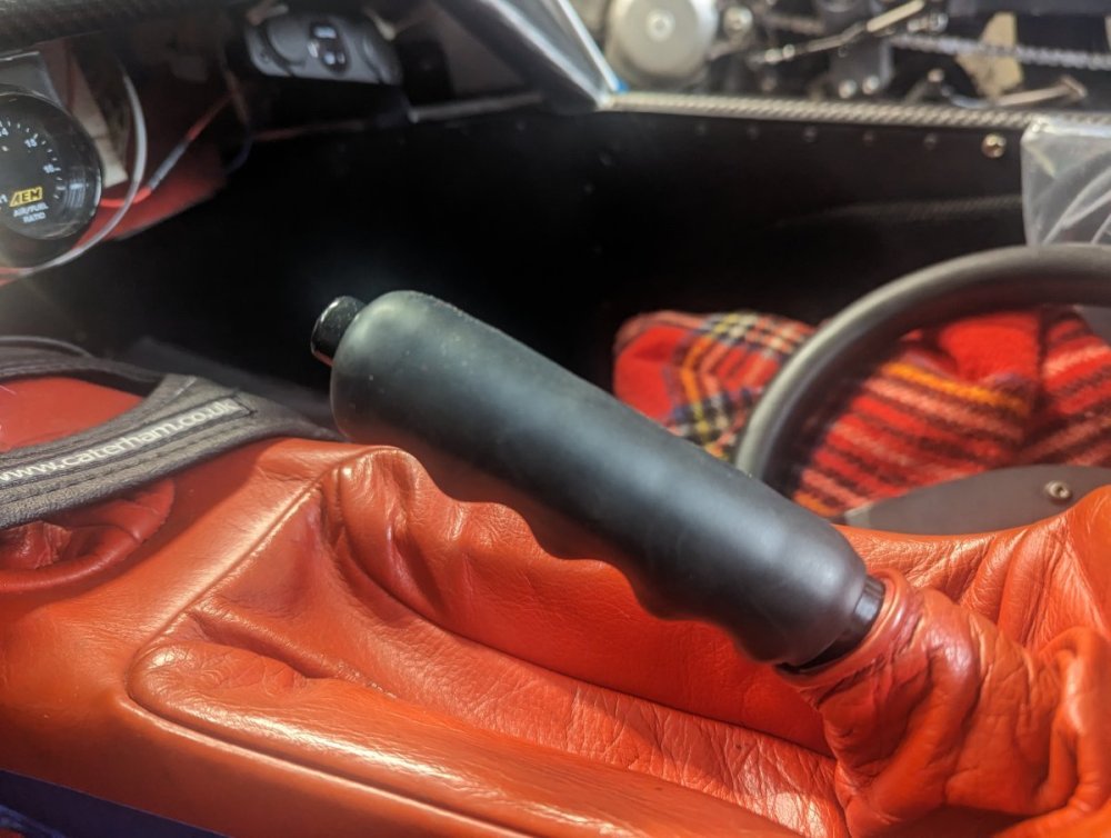

Vovchandr Posted August 20, 2024 Author Share Posted August 20, 2024 (edited) Changed my plastic handbrake to the R metal one today Edited August 20, 2024 by Vovchandr Link to comment Share on other sites More sharing options...
Vovchandr Posted August 20, 2024 Author Share Posted August 20, 2024 On 8/14/2024 at 7:40 PM, Vovchandr said: There was a storm pending coming to our area today while I was at work. Decided to try out tonneau cover for the first time after owning it for about 4 years now Naturally the rain missed us. Does anybody know how to fit these tonneau covers back into OEM bag properly? Link to comment Share on other sites More sharing options...

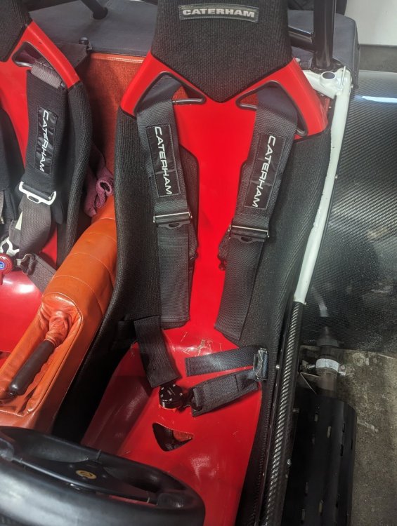

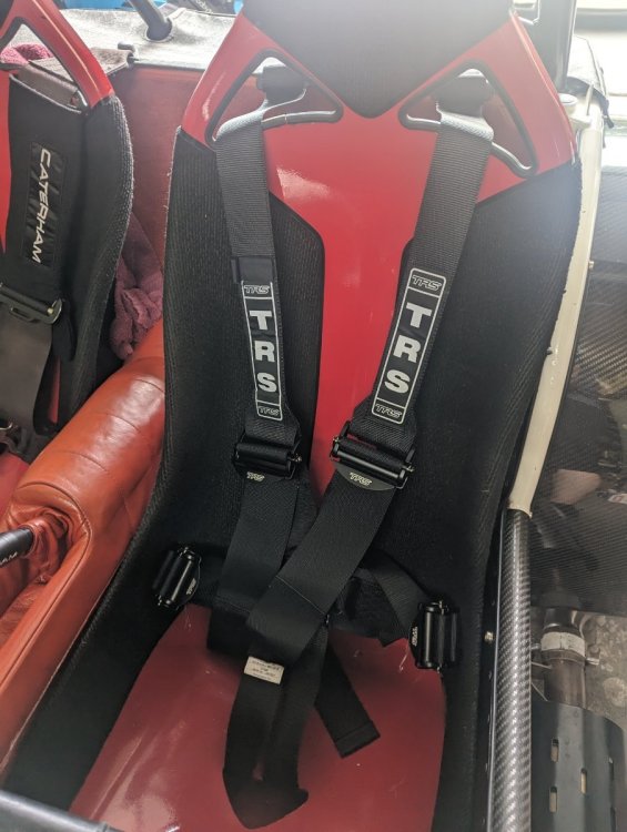

Vovchandr Posted August 20, 2024 Author Share Posted August 20, 2024 (edited) With that said new belts are in for the track day after using up me entire vocabulary of swears Pre TRS installed With the "Scooby Do" mask of "Caterham" label overlay Edited August 20, 2024 by Vovchandr 1 Link to comment Share on other sites More sharing options...

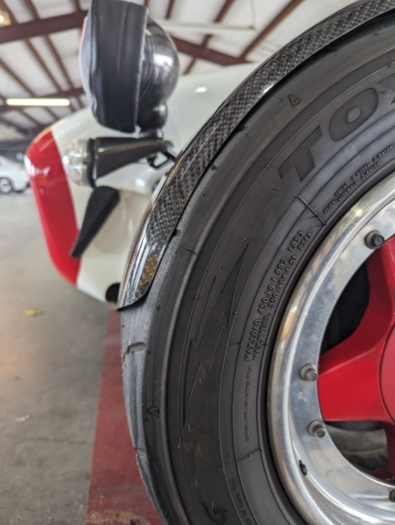

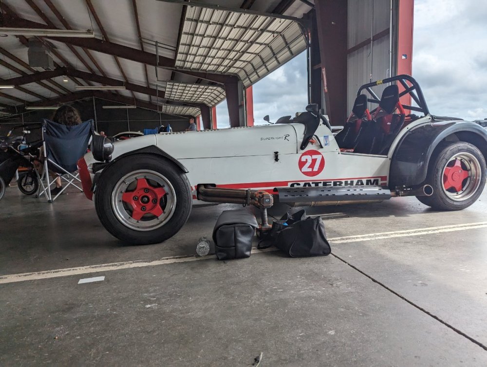

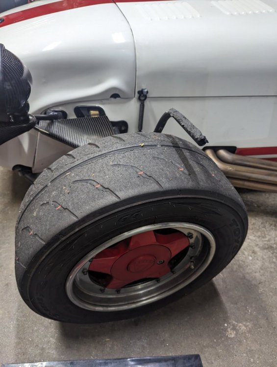

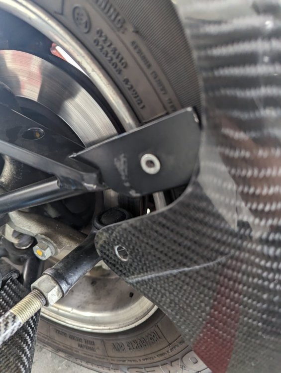

Vovchandr Posted September 11, 2024 Author Share Posted September 11, 2024 (edited) Back from the track day Car did great overall. Only things that failed are aftermarket components. Westermann CSR aluminum wing stay failed on driver side and I was battling through bad throttle mapping in the ECU throughout with lean conditions causing misfires. I think there is some bad juju on the driver front wheel. Original owner had his bolted fender fly off on driver side, I had first round of Sika flex fail when I glued fenders first time, then I had rivcerts fail out of the stay on the track day same day, next track day I had driver fender issues and now this year with a new stay and new fender failures again. Could be that side is generating more heat due to bad bearings or dragging calipers or something. Maybe I'll just go open wheel next time entirely? Time to send my oil for analysis to Blackstone to check whats going on with engine and do an oil change. It's been in there about 2 years. Very surprised that people don't know about this. @NSXguy @Croc Blackstone https://www.blackstone.com/ slight bend... Had to cut off Sikaflex in the back. Held on strong! All the tools brought came to use (of course couldn't find my ball joint breaker tool specific for Caterham before I left ) Bent that far, no easy way to remount Hella flush! Edited September 11, 2024 by Vovchandr Link to comment Share on other sites More sharing options...

Vovchandr Posted September 11, 2024 Author Share Posted September 11, 2024 (edited) Original fenders had a failure with previous owners. You can see the fixings in the fender Then 2019 NJMP. Again driver front. I believe Sikaflex failed (good picture, fond memories @wemtd) 2020 - NJMP here is my quote Emphasis mine Quote "Discovered one mechanical failure towards the end of the day and it was not what I expected Big heads fasteners failed on the fender. Not the glue like last year. The actual fasteners. Same fender as last year btw. Not sure what's causing extra stress on that side. Last year glue failed AND hard mount/screws have failed. This year metal failed. Right side is fine. Strange." In 2021 I had another failure, this time hardware failed My quote at the time Quote Also after the last track day I also discovered that my left hand cycle fender had issues... Again. Second time it doesn't want to survive a track day. Last time sika flex failed. Then hardware bolts failed. This year the actual metal of the bigheads has failed on 3 out of 4 fasteners. I only have 2 spares on hand so will have to order more. I have a feeling there is something wrong with the fairing stay so I will also be replacing it. Lucky I have one on hand. ' The next two years (2022/2023) I wasn't on the track and now that I went this year another driver failure on completely different components. New wingstay and fenders. very peculiar. That makes my batting average 1.000 as I'm 4 out 4 for driver failures on track days in many different flavors for mounts and fenders. Edited September 11, 2024 by Vovchandr Link to comment Share on other sites More sharing options...
CBuff Posted September 12, 2024 Share Posted September 12, 2024 Maybe the clockwise running at the track. Ie more right turns than left. Heavier compression on the left side the car ???? 1 Link to comment Share on other sites More sharing options...
slowdude Posted September 12, 2024 Share Posted September 12, 2024 5 minutes ago, CBuff said: Maybe the clockwise running at the track. Ie more right turns than left. Heavier compression on the left side the car ???? i'm with cbuff. Next time run the track opposite direction and see if the left side still falls off? Link to comment Share on other sites More sharing options...
IamScotticus Posted September 12, 2024 Share Posted September 12, 2024 Looking close there 1 Link to comment Share on other sites More sharing options...
Vovchandr Posted September 24, 2024 Author Share Posted September 24, 2024 (edited) On 9/11/2024 at 9:34 PM, IamScotticus said: Looking close there Good eye! It was pretty close but since the fender floats with wheel it never contacted. Either way that's the first iteration of my mounts/fenders that came with the car. Since then I've switched 2 or 3 times. (New fenders/new mounts/another set of mounts/CSR fenders and mounts) Here's what it looked like before CSR mounts Edited September 24, 2024 by Vovchandr 1 Link to comment Share on other sites More sharing options...
Vovchandr Posted September 25, 2024 Author Share Posted September 25, 2024 Looking at the track pictures On 9/11/2024 at 9:34 PM, IamScotticus said: Looking close there Looks like some years it was closer than others The one in your screen shot is the fender that's held on by the bolts so it must by the original stay This picture is from 2022 and is another factory stay with a glued fender yet very similar Link to comment Share on other sites More sharing options...

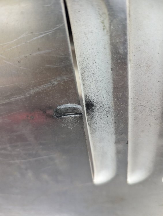

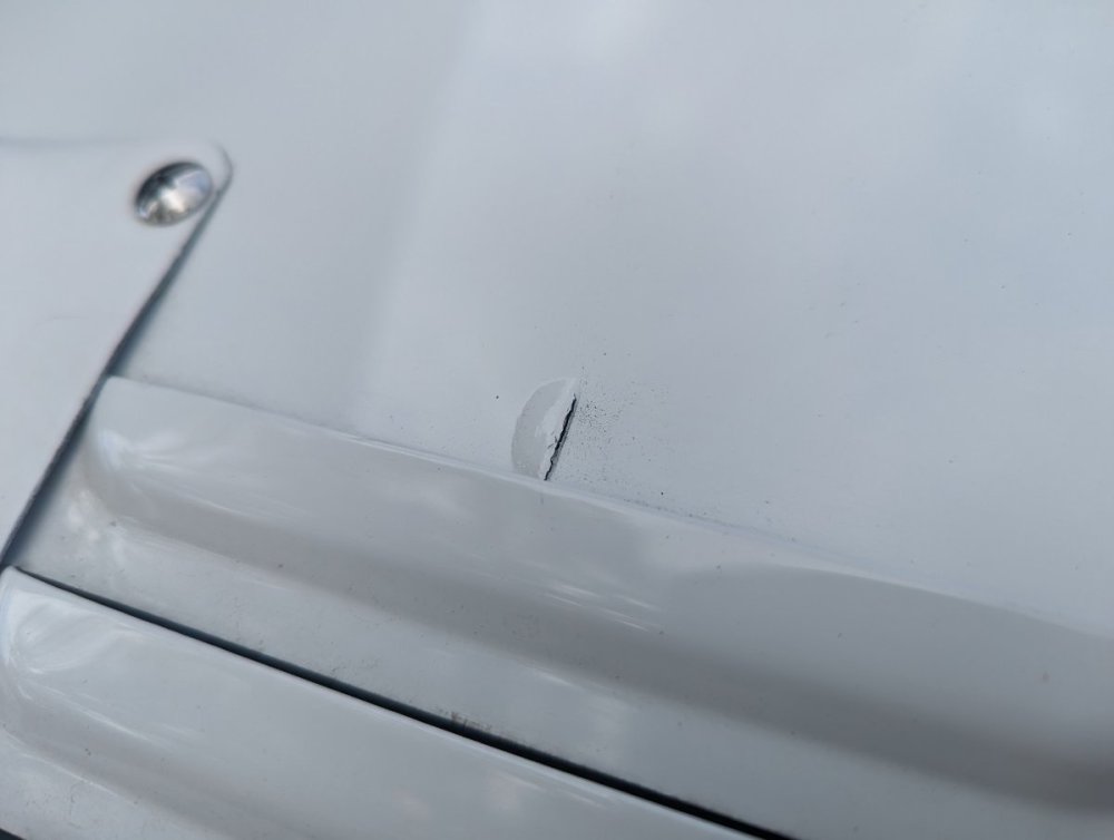

Vovchandr Posted October 2, 2024 Author Share Posted October 2, 2024 A few updates Discovered a strange bump in my hood with cracked paint and found the root issue.. Link to comment Share on other sites More sharing options...
