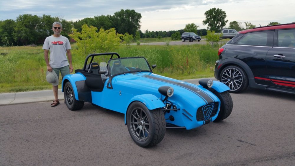

Here is my only audience/encounter with a Seven, at a local meet. Wish I met the owner! It was a love at first sight....!

11 hours ago, BlakeJ said:
My experience with 420 power in an SV chassis has been nothing short of fantastic.
It starts and runs reliably, ............
I'd echo what others have said about the LHD 420; it's the ambient air temps/humidity/sun that make it uncomfortable sometimes, not the heat from the car.
