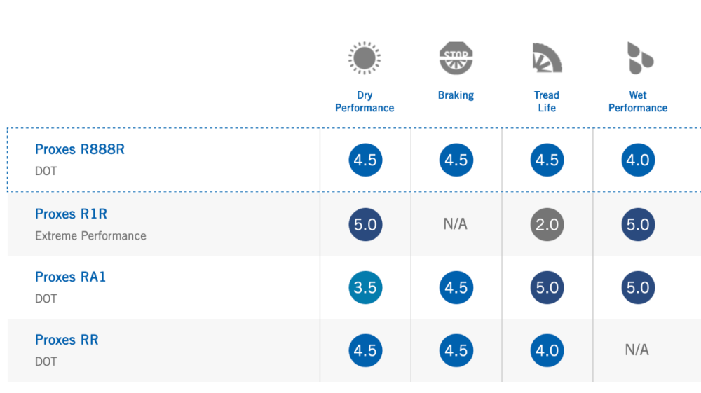

KnifeySpoony Posted May 14, 2024 Share Posted May 14, 2024 5 hours ago, Croc said: Toyos - graduated grip levels for the various series. Which tire in the top class? Link to comment Share on other sites More sharing options...
Croc Posted May 14, 2024 Share Posted May 14, 2024 I understand it to be the R888. They will be my new set for next week’s events. Link to comment Share on other sites More sharing options...
