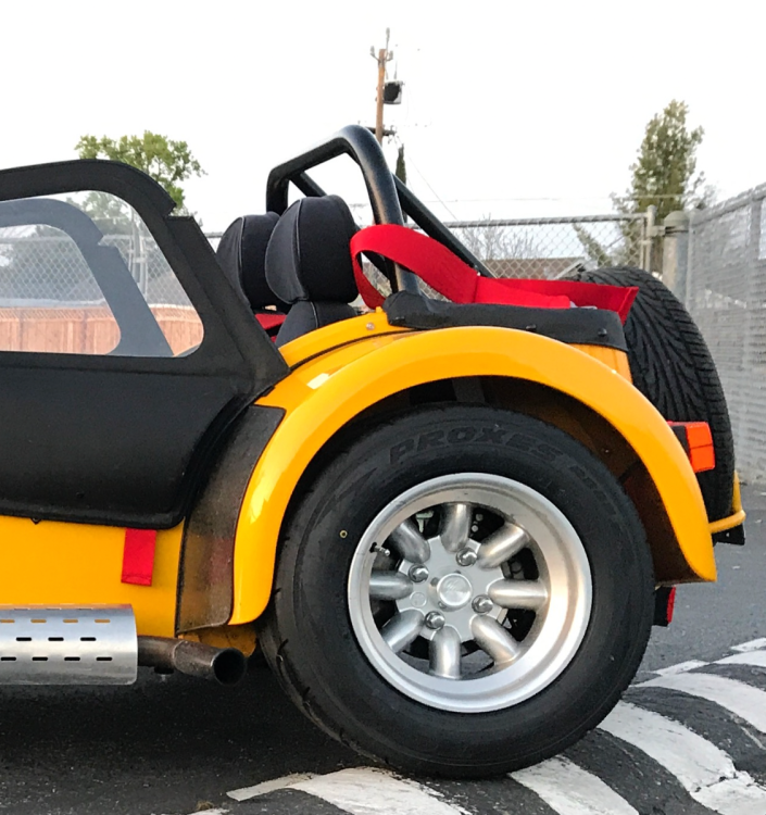

Oh, thanks! Somehow I had overlooked the existence of the 225/45R13 size when shopping for my current set of tires. I've got the 205/60 and the diameter is large enough to cause tire rub on my driver's side rear fender. Thinking the 225 might actually do the trick even with the slight aesthetic hit due to the overall smaller diameter.
Of course the other solution that would work is a wheel with less negative offset (or a fender that doesn't come back so far at the outer edge?). When I bought the car it had Kumho slicks on it with a lower profile and it wasn't an issue.
Also, apologies for the post spam. The page didn't refresh after hitting "reply" and... well, I posted about ten times. Hopefully the mods can clean it up and hide my shame.
Edited by Slonie
Added photo

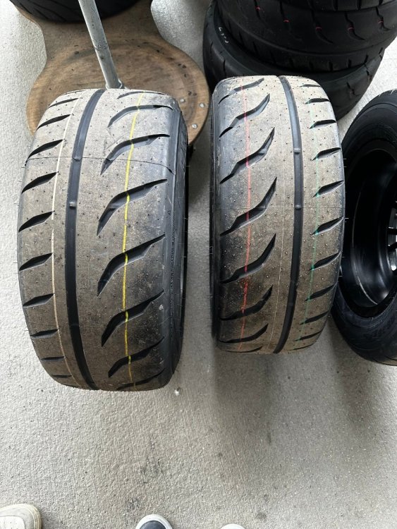

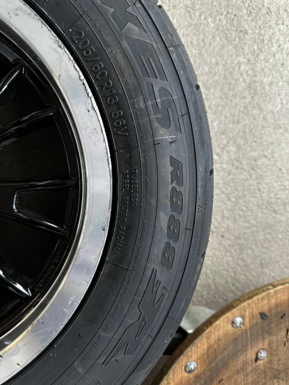

The Caterham for this exercise was a 2018 420R SV.  The Toyo R888R were 205/60/13 used on all four corners.
Interestingly, I have a stagger wheel set up - 6x13 on the front and 8x13 on the rear.  The same Toyo tire size was used on both wheels.   The end width result looks like this.
I was running at cold pressures of 17psi with the objective of 22-23psi hot.  I did not get the opportunity to experiment much with pressures to see if they responded better with variations.  I strongly suspect (when you read my impressions below) that a lower front pressure will work better.
I don't have a set of final suspension set up numbers.  I was running the traditional ZZR set up with a little more neg camber than what Caterham publish in their build manuals.  I think that is too much when it comes to the Avon ZZS use and for the Toyos as well.  I have asked for my car to have its suspension reset to standard Caterham manual track use when it gets back to the UK from France.

I’m surprised the 205 fit both the 6” and 8” wheels. Do you see any advantage to running this square on staggered setup?. Or would the 185 on the 6” be better?  Assuming these can be sourced.
I don't think it changes the end result to be honest.  The size choice on front might improve the sidewall flex which is a clearly something to be considered for front end grip but it would have zero impact on the grip degradation over time as that is a rubber compound issue.
The fact that everyone is doing the same thing for the race series in the UK tells me that it is likely the best option.  TFL are supporting 40 something Caterhams in race and track days and the do talk with the other support outfits, McMillian being the next biggest.   What I was given is the best consensus in UK Caterhams right now.  Not really a great answer for you tbh but I did not have unlimited time to experiment.
6.5" can fit up to 245 I believe. Definitely 225.
The fast knowledgeable turbo Miata guys running time attack and super Miata racing really stress the idea that wheel width needs to match tire width for a racing tire to work optimally.  I imagine that 205 on a 6" rim may have impacted the front tires ability to do their job.
Yet the entire fields of Caterham UK race series competitors are doing exactly that when running this tire. A lot of people are wrong - its not going to be you or I to say which ones are.
Logic to me says go down a size but then I see some very fast drivers who I am on track with say its not the right way.  A conundrum eh?
But it misses the point - the correct decision is to choose a different tire
