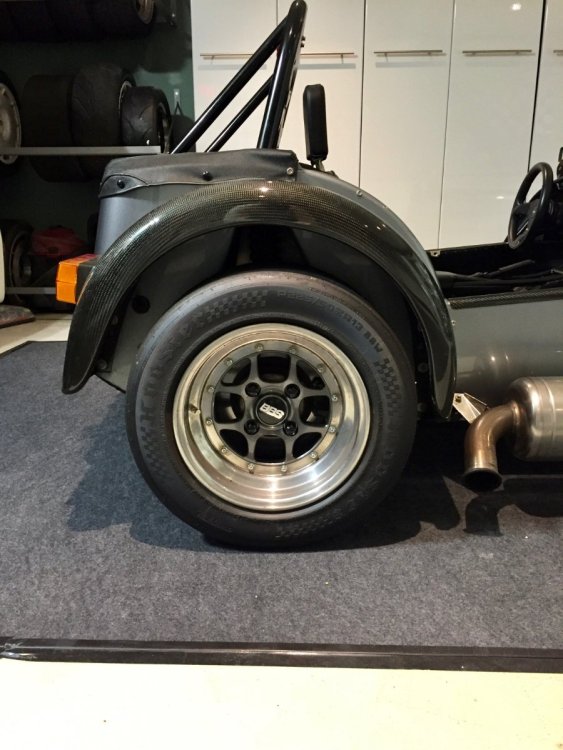

Those rear tires look meaty! how do they fit on the fenders? whats the width and offset of those WESMO BBS wheels?
They are custom dimension 3 part wheels for the CSR - the BBS center is not unique to Wesmo.  I ordered bits recently from BBS for new wheels for another project.  They are off the shelf motorsport pieces you can order direct from BBS if you know what you are doing.   My wheels will not fit an R300 or any de Dion chassis.  Thats ok as you can just show the center to BBS to order it and then ask for the inner and outer barrel pieces to get your custom offset and width to suit your car.
For the record my wheels are:
Front: 7x13 ET40
Rear: 9x13 ET8 (not sure about this offset as I am traveling and I really need to find my paper BBS order files at home) - either way it would be wrong for your car.
The 13 inch wheels always look a little lost in the rear guards of any Caterham - mine is the same.  This is a photo of it wearing the Hoosiers, which I used before I shifted to the P-Zeros.  The P-Zeros fill out the rear guard a little more.  About the same on the front as the Hoosiers.    Width is perfect.

Looks great!
Slicks and rollbar at the track.... Spicy!
