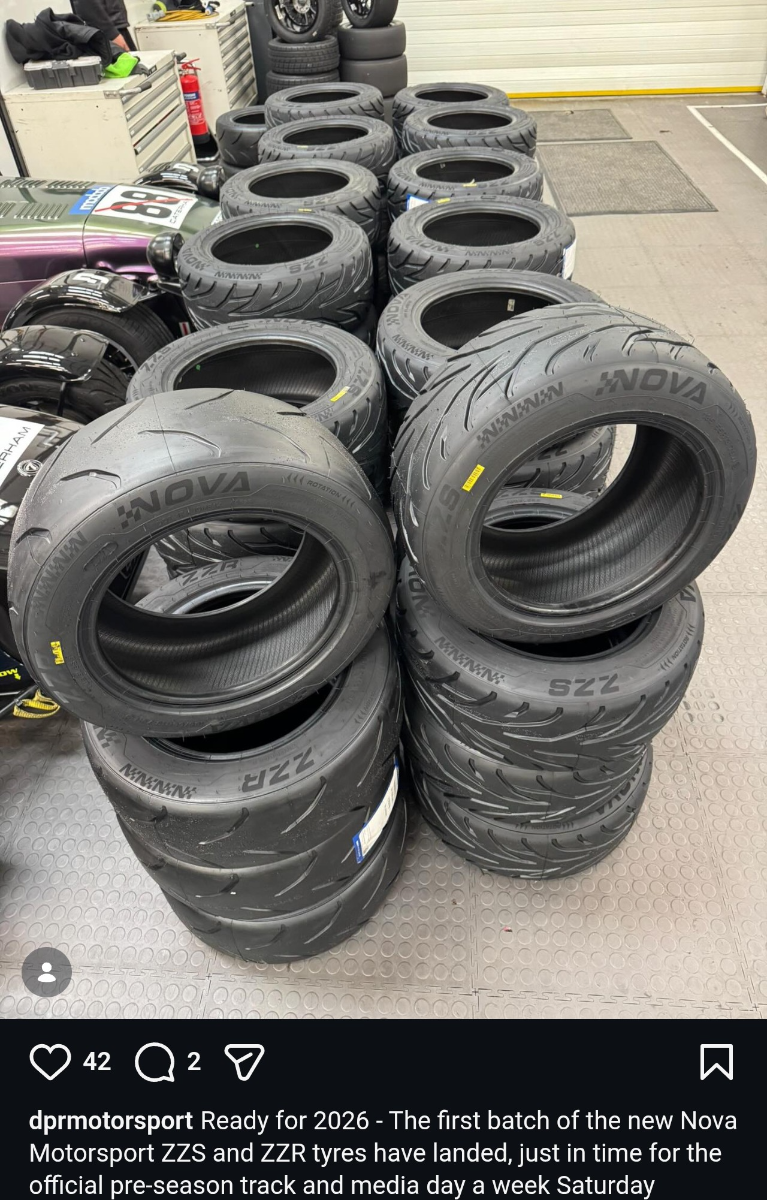

Clearly I am chomping at the bit for the Nova (Avon) ZZS or ZZR. I reached out to nova UK and their US rep circled back today. They are in the process of signing off on the DOT compliance for the ZZS and ZZR range. I asked the best case scenario for tires in hand. Ken said maybe 4 months - but I am guessing there is a lot of maybe/possible in that.
Ken Payne is the Nova contact who was very nice and told me to he was happy to connect with anyone interested. I will update if he gets back to me with any more updates.

Great! Can you ask about the 215 availability? Apparently only 185s are on plan for now
