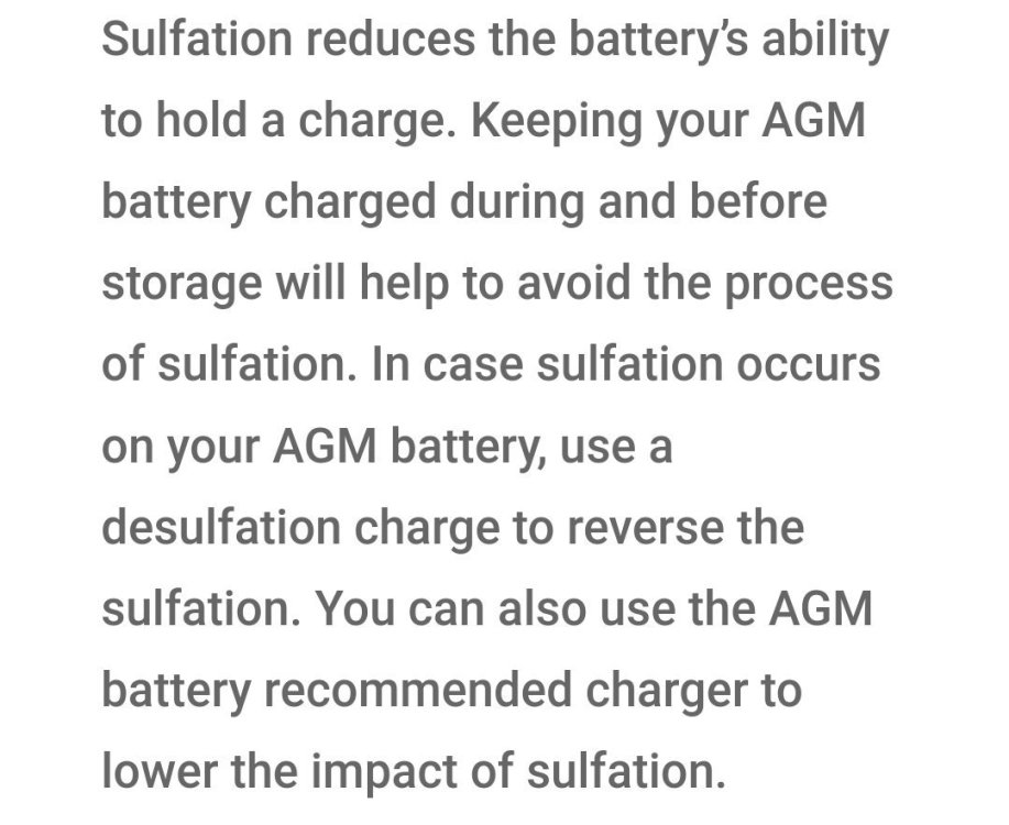

Know what kind of battery you have.  If it's an AGM type, not MUST use an AGM charger or one with an AGM function. Use the correct charger for the battery you have.  The days of lead acid battery and one charger are over.
A good smart charger is the NOCO Genius series.
Next, if a battery becomes fully discharged,  you can't simply jump it and run.  It needs a full deep charge.

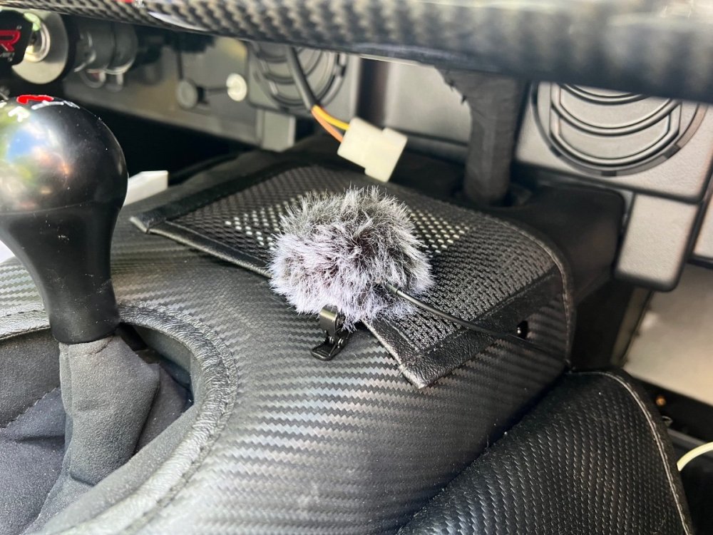

I also have the Caterham tunnel bag like below. I put my phone in it, keep my ear plugs in it, and i tuck my insurance papers underneath it. (not in the mesh, but between the tunnel bag and the top of the tunnel. Works like a charm

and tunnel bag from soft bits
https://www.softbitsshop.co.uk/the-touring-tunnel-bag-x28vinylx29-80-p.asp
it’s been great.  But like @IamScotticus
Idea of sliding insurance and reg underneath it.

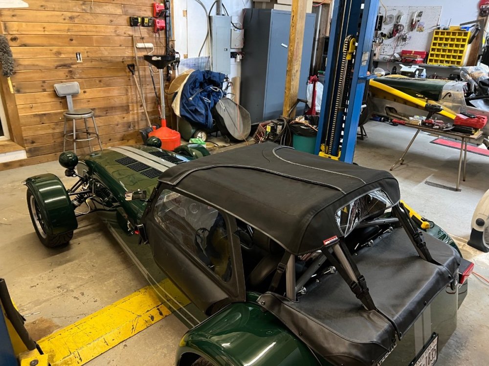

I also got the half hood from soft bits with ez in zips. Haven’t needed to use it yet but I like that it’s in the boot and quickly deployable.

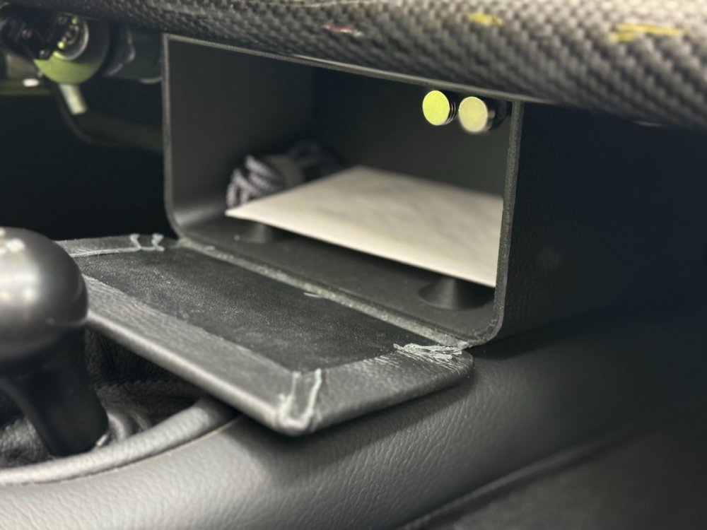

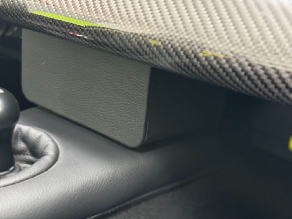

If you are comfortable with simple fabrication, you can build a small glovebox to fit over the transmission tunnel ahead of the gear lever.  I've done this for both the Westfield (sheet aluminum) and Caterham (3D printed).  It makes it very convenient to store paperwork, ear plugs, and other small items and is relatively hidden so not a magnet for casual thieves.
