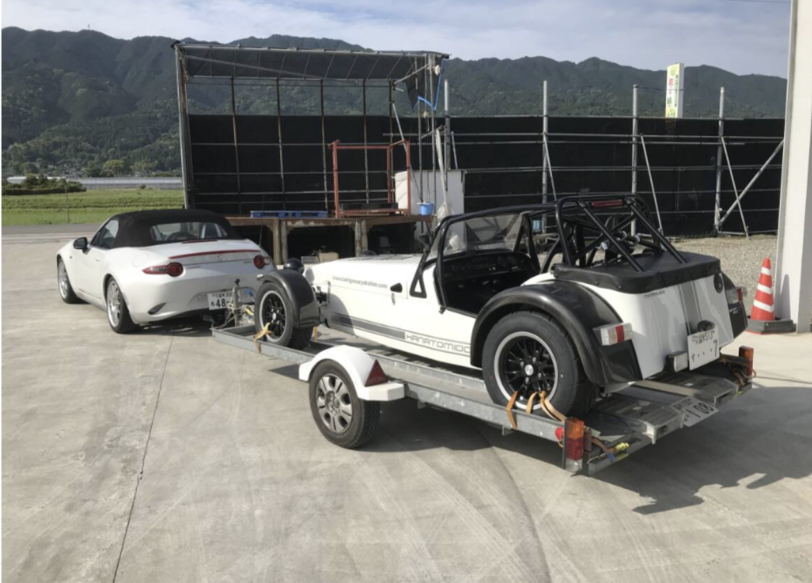

Towing a Seven with a Miata might put the Miata's clutch at risk, but whatever floats your boat. Yes, an open single-axle utility trailer (6x12, very common) is the cheapest and lightest way to go. Rigging up tie-downs is one trip to Harbor Freight. Weld a little winch on the tongue and replace the very heavy tailgate with aluminum ramps. That's what I did and it works.  I do know how much each trailer and car weighs, and that's important, but I have no idea what the tongue weights are other than they 1. are substantial, and 2. do not interfere with the handling of the towing vehicle.
Vovchandr is right. Don't overthink it. Buy a trailer the car will fit on/in and work out how to load it and tie it down.
Full disclosure: Miata above is for funnies. I believe the source of the image said its AI, and even if it isn't, its likely just a Miata just backed up to a trailer for a staged photo.
