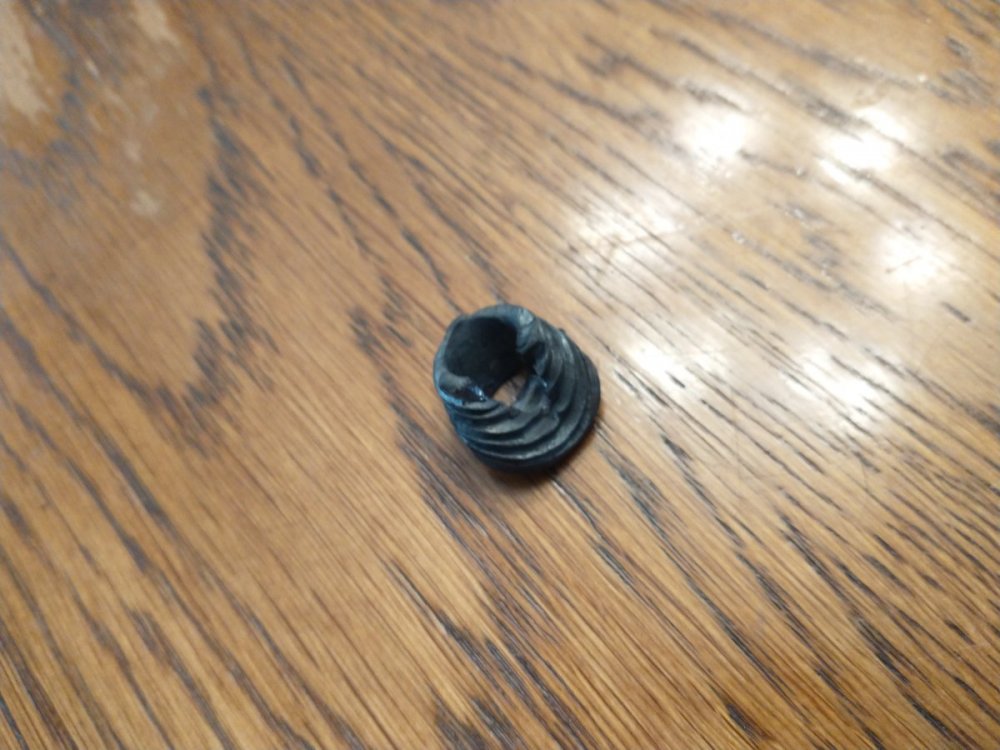

Vovchandr Posted June 13, 2021 Author Posted June 13, 2021 (edited) You guys are right, spark plugs aren't a good way to tell running condition so I installed a wideband after getting the stuck bung out with a lot of persuasion. At the moment car is still a bit of a drivability mess. I'm not confident in cooling system or my idle/AFM situation. Current status. 1) Wideband installed and keeping an eye on it. Strange thing is from what I see I should go lean when off throttle but I go rich. Otherwise it's a bit all over the place 2) IAC is connected back. It still doesn't hold idle by itself for likely one of two reasons. a) it's bad b) TPS never gives it a hand shake to take over *pending testing* 3) Coolant is still a problem. I drive fine and at temp on highway but as soon as I slow down into traffic I run hot 4) While driving around yesterday I started to get an electrical issue in the tach/speedometer unit. Shift lights would flicker when shifting up or down and then towards the end of the drive when it got hot in traffic it started to be even more buggy. RPM was off and lights were triggering at random. Not too concerned with this as it seems to be a slave from other issues. 5) Rented a coolant system pressure test Plan is to go back a page and follow Crocs list in detail. Remnants of the bung Edited June 13, 2021 by Vovchandr

Vovchandr Posted June 13, 2021 Author Posted June 13, 2021 11 minutes ago, Anker said: #4: Bad ground connection! That's a good idea. I did mess with a ground when I installed the wideband. I'll double check. Thanks!

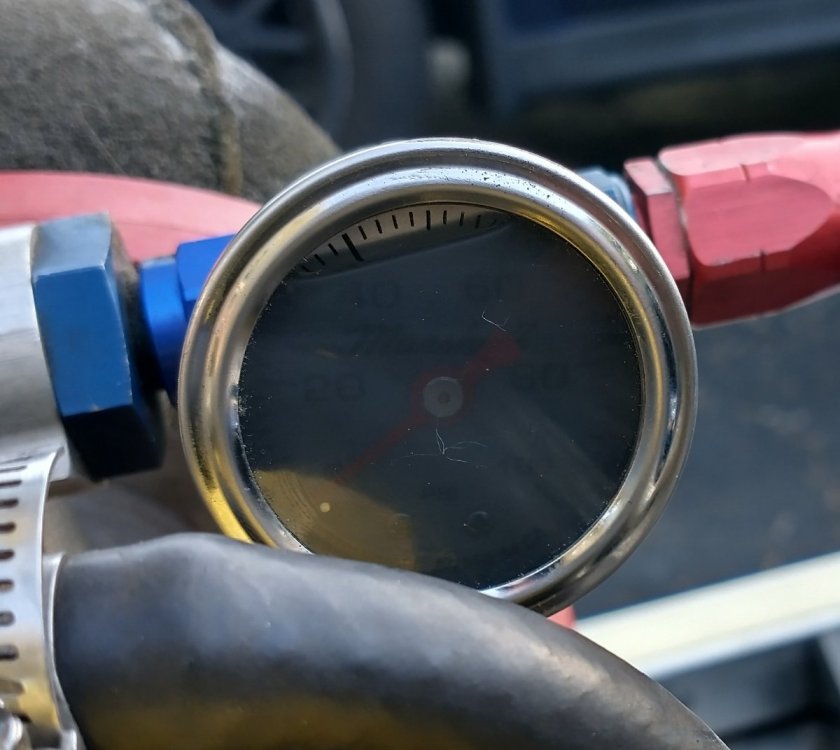

Vovchandr Posted June 13, 2021 Author Posted June 13, 2021 Anybody know what could have happened here? Fuel gauge spontaneously blackened/fogged.
Croc Posted June 13, 2021 Posted June 13, 2021 15 minutes ago, Vovchandr said: Anybody know what could have happened here? Fuel gauge spontaneously blackened/fogged. At the risk of being Captain Obvious, your gauge is full of fuel. See the level towards the top.... Next observation - why is that fuel so dark? Grease/dirt from the gauge/internals? Lack of in-line filter? Mixed with oil? Dude...what are you doing to that poor car of yours?
Vovchandr Posted June 13, 2021 Author Posted June 13, 2021 (edited) 10 minutes ago, Croc said: At the risk of being Captain Obvious, your gauge is full of fuel. See the level towards the top.... Next observation - why is that fuel so dark? Grease/dirt from the gauge/internals? Lack of in-line filter? Mixed with oil? Dude...what are you doing to that poor car of yours? They are full of fluid from the getgo - https://www.amazon.com/gp/product/B01GQNVDDW/ref=ppx_yo_dt_b_search_asin_title?ie=UTF8&psc=1 Marshall Instruments LS00100 Silver Dial Fuel Pressure Gauge Pretty sure my actual fuel should never be directly in the gauge. It should be separated by a diaphragm or similar (somebody will surely correct me if I'm wrong) 10 minutes ago, Croc said: Dude...what are you doing to that poor car of yours? Just driving it. I swear I'm pretty sure I'm testing theoretical limits of the Murphy's Laws in regards to everything that can go wrong.. Edited June 13, 2021 by Vovchandr
Croc Posted June 13, 2021 Posted June 13, 2021 Ok I assumed you were using a dry-type gauge and it became a wet-type gauge based on how you described it. The wet gauges do go cloudy when the liquid within is contaminated. The liquid is usually a silicone, clear light oil or glycerin - not sure what Marshall use? That happens when the little pressure seal goes "poof" and fuel invades the gauge liquid. I bet it reads low now? At least you are retaining some sense of humor!!!
JohnCh Posted June 13, 2021 Posted June 13, 2021 This raises the question if the gauge failed due to age/vibration or if something wonky happened with your fuel pressure to pop the seal? Have you been monitoring that during your diagnostic sessions? -John
Vovchandr Posted June 13, 2021 Author Posted June 13, 2021 (edited) 1 minute ago, JohnCh said: This raises the question if the gauge failed due to age/vibration or if something wonky happened with your fuel pressure to pop the seal? Have you been monitoring that during your diagnostic sessions? -John It was good just a day or two ago. Only thing that happened is that I ran "hot" again. Closer to 100c during test driving and parking. Was very surprised to find it like that. I think I'm not going to put too much thought into it at this moment. Cooling troubleshooting is still priority. Thought it was interesting however. With the current - reinstalled old/OE thermostat I average just below 80 degrees and my fan turns on right before 80 as well. Edited June 13, 2021 by Vovchandr

Vovchandr Posted June 13, 2021 Author Posted June 13, 2021 5 minutes ago, Croc said: Ok I assumed you were using a dry-type gauge and it became a wet-type gauge based on how you described it. The wet gauges do go cloudy when the liquid within is contaminated. The liquid is usually a silicone, clear light oil or glycerin - not sure what Marshall use? That happens when the little pressure seal goes "poof" and fuel invades the gauge liquid. I bet it reads low now? At least you are retaining some sense of humor!!! Not sure what they use either. Obviously some kind of failure. I think it reads on par. I'll double check during next testing. Notably I was spot on 40 for longest time and just a few days ago I was at 38. I'm laughing about it. It's maniacal and hair pulling but still laughter.
