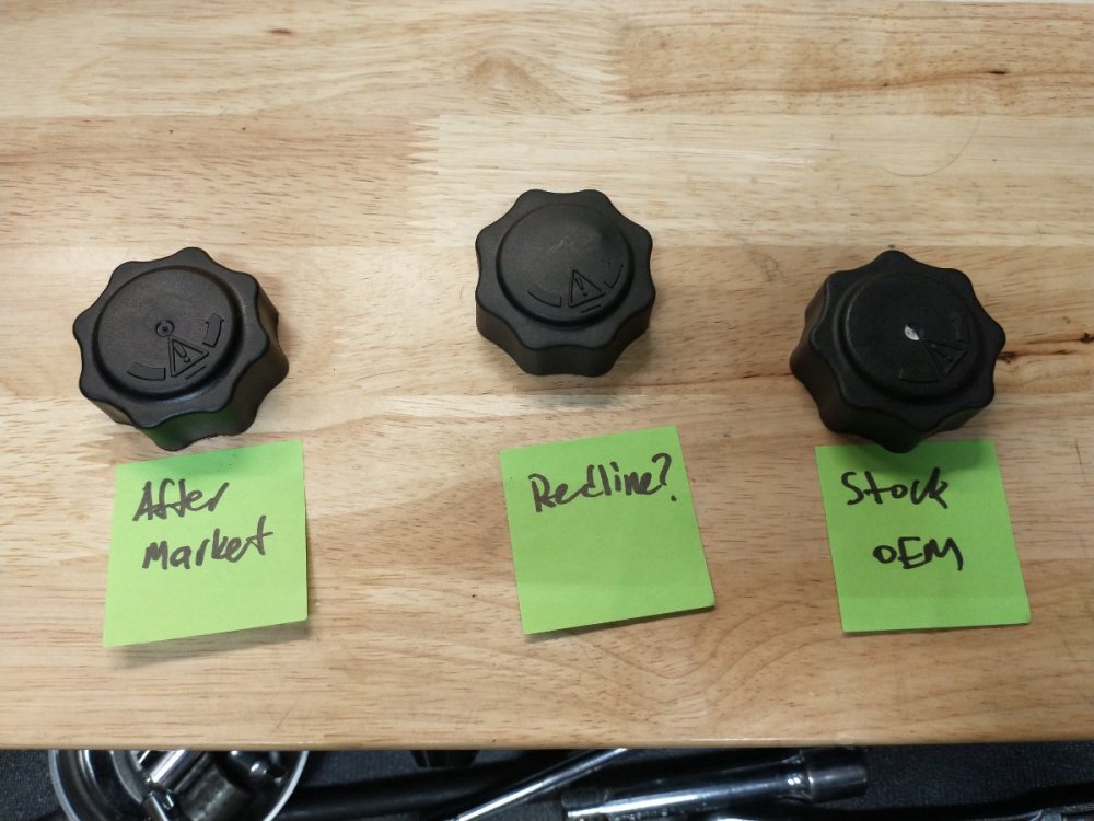

Used tester today. New data! Who doesn't like data.
I discovered that you can use radiator pressure tester can be used to test caps as well.
Due to a plethora of reasons over my ownership I ended up with 5 total radiator caps. One from redline melted into a blob after being lost/left on headers. One what I think is after market got butchered to make the bleeding funnel attachment so that leaves me with 3. OEM came with cae, replacement redline and one more aftermarket?
Only one of three has passed the pressure test to 12psi. I believe it's redline one.
My last run out was on OEM which currently tested either 5 once or 0 after that. Regardless no good. Will continue with the 12psi one.

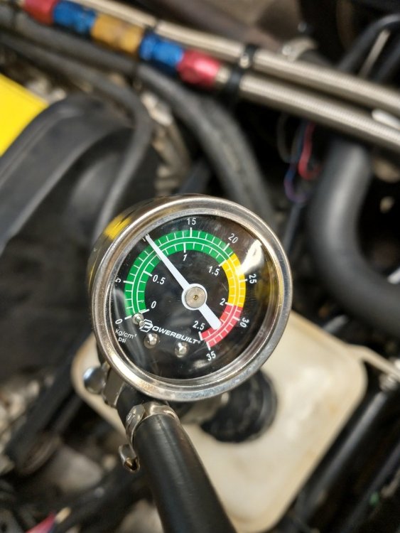

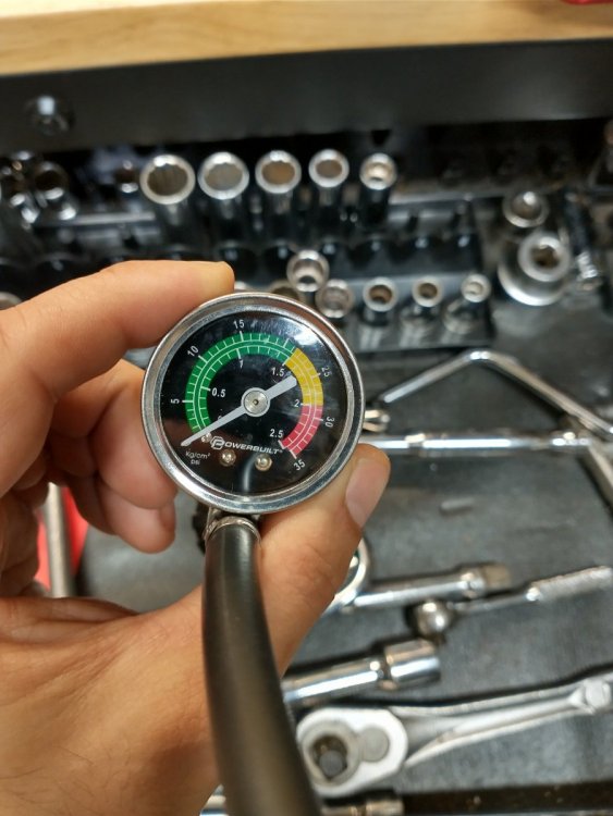

Car system is holding 10psi. Is that good enough for Zetec? Anybody know oem pressure? Haven't found that definitely yet online. Some places said 18psi
Redline I believe. ~12psi
Aftermarket
OEM
Car is holding around 10psi

I have never seen a number to use for testing. I use 15 pounds because it is in the middle of the yellow zone on the gauge I have.  I generally look for it to hold pressure for 15 minutes. If I t will do that when it the engine is cold, you do not have a leak.

If you can only achieve and hold 10psi you have a leak somewhere. That system should hold  at least 15psi w/o issue for a LONG time. Hopefully you're able to track down an external leak. Time to get a flashlight start hunting. If you can't get the pressure over 10psi it's not going to take too long to find out where the leak is coming from.
I'm not surprised you had a cap issue. I had the same experience and ended up replacing the cap and tank to get a proper seal. I had caps that would not hold the rated pressure and a cap/tank combo that would not seal well at the interface. I finally purchased a new cap/tank combo that had a newer cap design and that took care of that!
Hopefully you'll find a leak and once that thing holds pressure you can move forward.

Found a few small seeps from hoses and tightened them up. Holding 16 right now steady for a long period! Do I need to shoot/check for higher?
Also do I need to find a cap that holds more than 12 psi?

I'd stick with 15psi. There's no reason to go much higher than that, you may do more harm than good. If you're holding 19psi for an hours you're better than fine.
The 12psi cap will kick up your boiling point to about 250F. This should keep the car from puking water when it heat soaks on a hot shutdown.

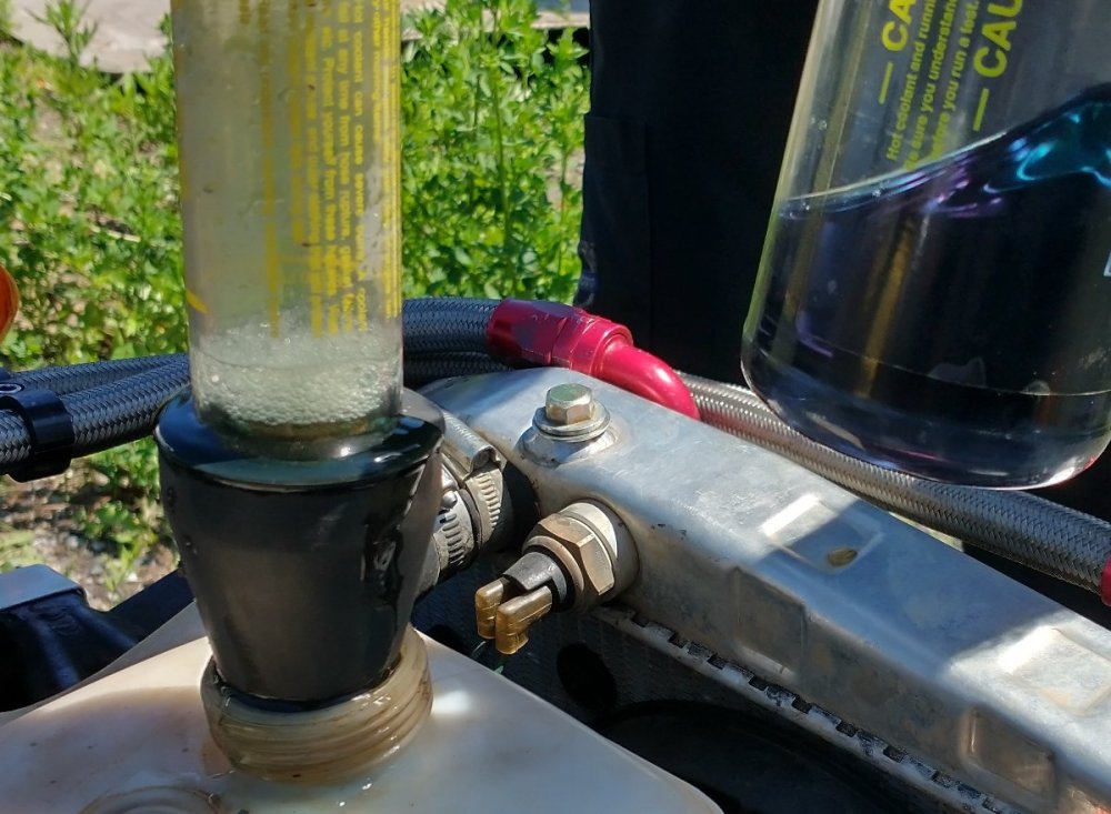

I believe we got a positive ID on exhaust gasses in coolant but I'll double check to make sure it wasn't a false negative.

I did the coolant test strips but not sure if they really reveal anything while testing water.
Gunk in reservoir doesn't look pretty.
@CarlB @Renottse
It started to turn yellow/green. Lots of bubbles going through it throughout the experiment while getting hotter. Started to turn towards the end before overflowing.

There are two types of head gasket leak.  Coolant galley breaches and Exhaust rings.   Test again another two times on the exhaust gasses - a day apart.  You are right to be suspicious of a false positive.
Coolant strips should still react - they are supposed to react with the presence of oil.
That gunk in the coolant is key to the diagnosis as it keeps coming back when it should not.  There are only two things it can be but you need to prove which one.
Also, please don't look to others and assume you have what they had.  Leverage their decision process to diagnosis your problem but don't jump to the end step without going through the intervening steps.    You may both have head gaskets fail but the reasons for failure are radically different and so the cure will have some subtle but still critical differences in the rebuild approach.  For example a coolant galley breach means I always test for a block that may have gone porous before the rebuild commences.
