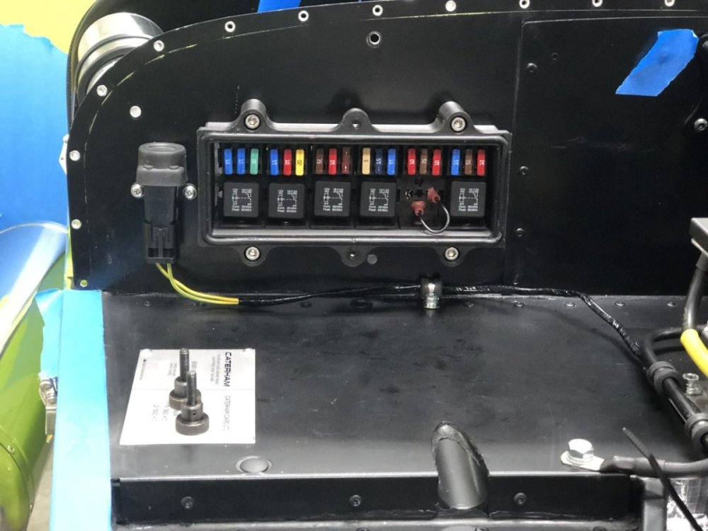

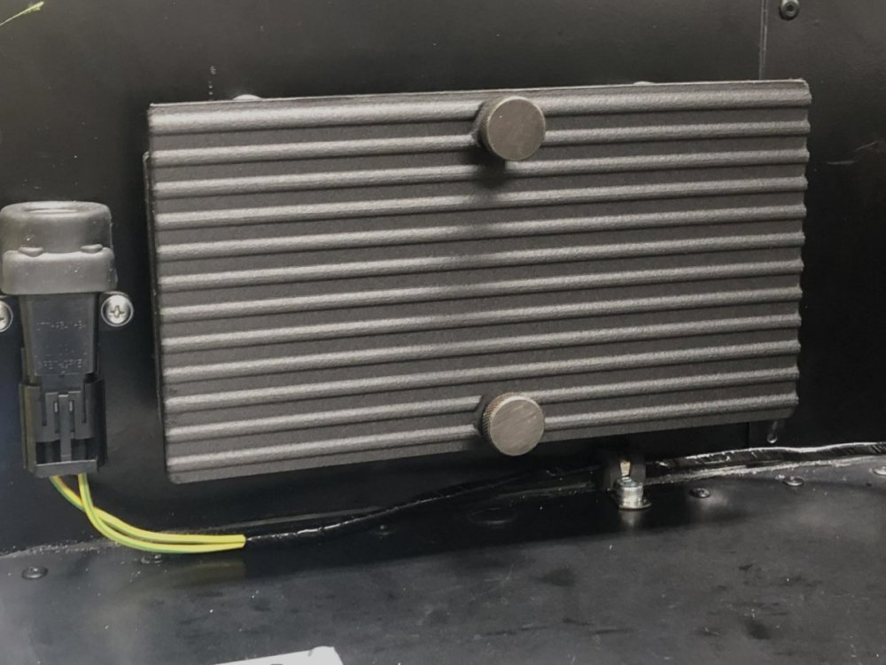

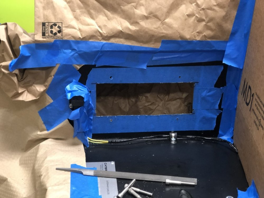

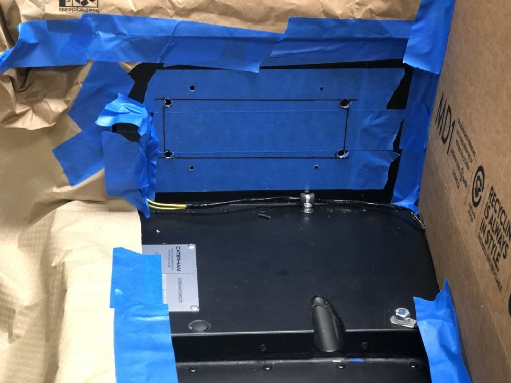

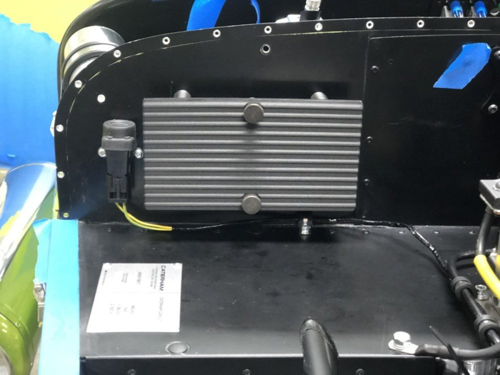

With that out of the way, I decided to finish the fuse box install.  That required cutting a hole in the firewall.  It's the kind of job I always approach with trepidation because it's an opportunity to showcase my spastic tendencies.  Fortunately, it come out great.  Very pleased with this and it will make changing fuses and relays a lot easier.

John - Your build is looking good, I really like what you did with the fuse box!
One of the things that I'd like to see Caterham improve on is the wiring under the scuttle, and the hose layout and wiring in the engine compartment. Maybe the RHD versions are better but what a mess on the LHD versions. I'm hoping to retire (again!) in the next couple months and hopefully I can do some improvements on my car then.
Thanks Bruce, I'm pleased with how it came out.  I agree about the harness.  It's a mess.  To be fair to Caterham, it appears they have a single loom made for all cars and all markets.  I'm sure that helps with the cost, reduces risk for a specific loom being out of stock, and eliminates another opportunity for them to install the wrong part in the wrong car :)  Of course it also means there are a lot of unused wires and connectors for a given car.  At some point in the very distant future, my plan is to rip out the harness and replace with a PDM.

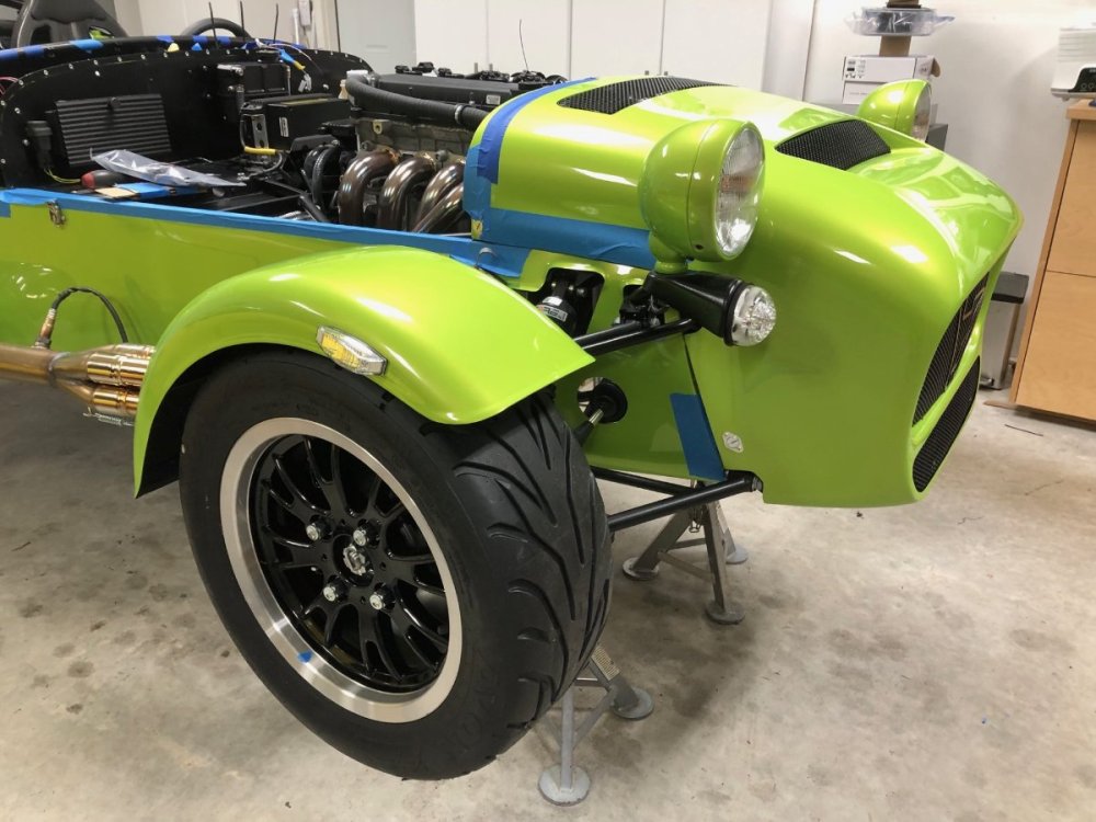

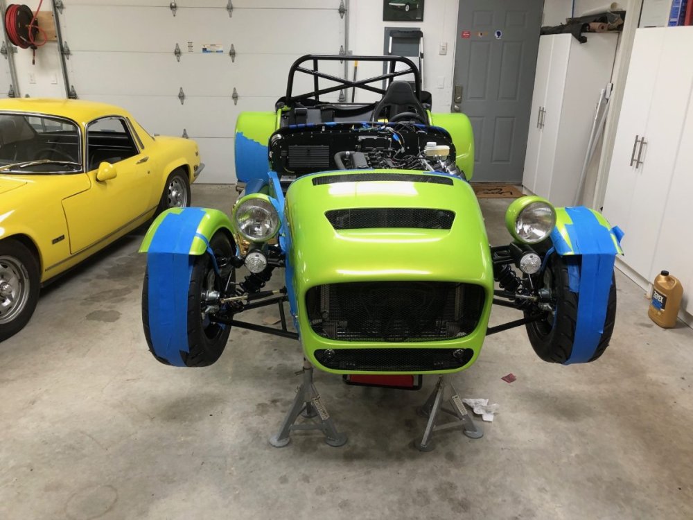

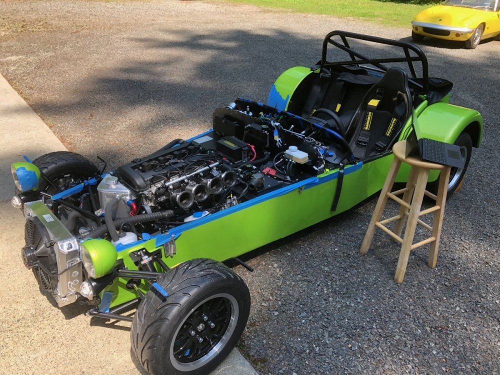

The front wings are on and repeaters installed.  I opted to use 3M Epoxy and followed Pokey's excellent writeup here.  Of course, it they fly off at speed, that credit turns to liability :)

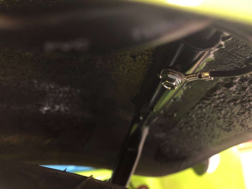

When attempting to attach the repeater ground to the underside of the stay tube, it was a little bit of a struggle.  Very tight and the screwdriver was beginning to slip.  Not wanting to take a chance on stripping the head, I replaced them with hex head sheet metal screws that were shortened on the grinding wheel to avoid damaging the 12v+ wire that runs in the tube.  It seemed a better approach and allowed me to safely torque the screw.

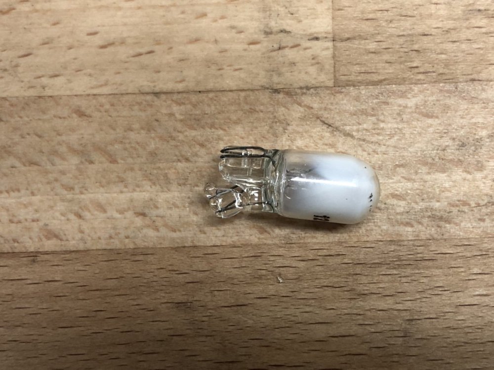

I also discovered why the side light bulb in the driver's side headlight never worked.  It arrived in the socket looking like this.  Easy fix.

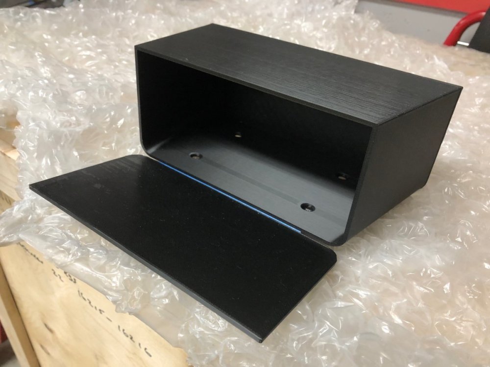

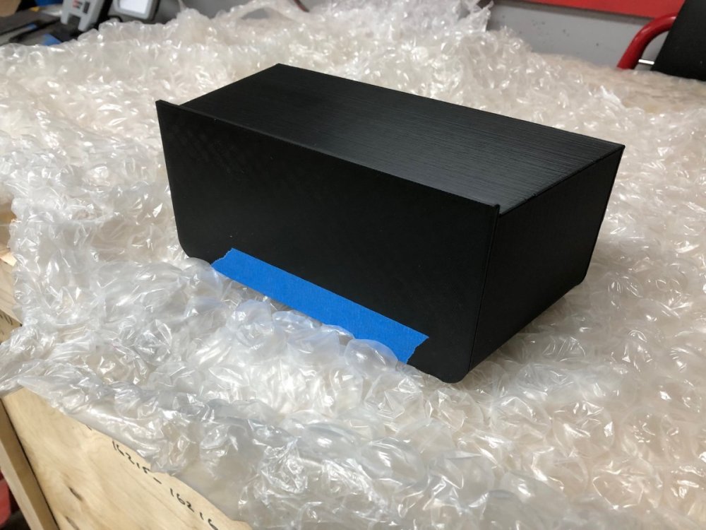

My original plan was to hang the glove box above the tunnel cover from an under-scuttle shelf, but given all the wiring, I wasn't able to find a good location so I've decided to attach it directly to the tunnel cover.  Aesthetically, I still want it to appear as if it's floating about 1/2" above the tunnel.  Short legs through which the screws pass should do the trick and wont' be visible.  Here are a couple of pictures of the first attempt.  The whole thing will be covered by black leather that matches the tunnel cover and will hopefully blend in.  I need to alter the dimensions just a bit for the final version but it's close.

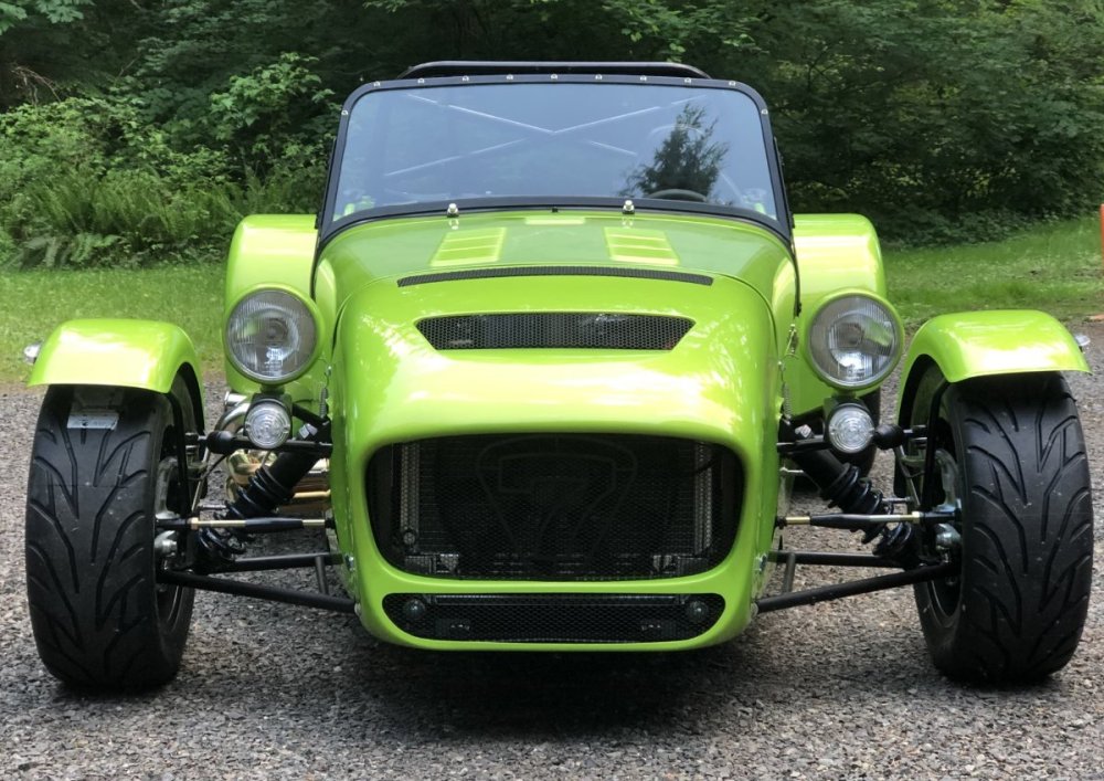

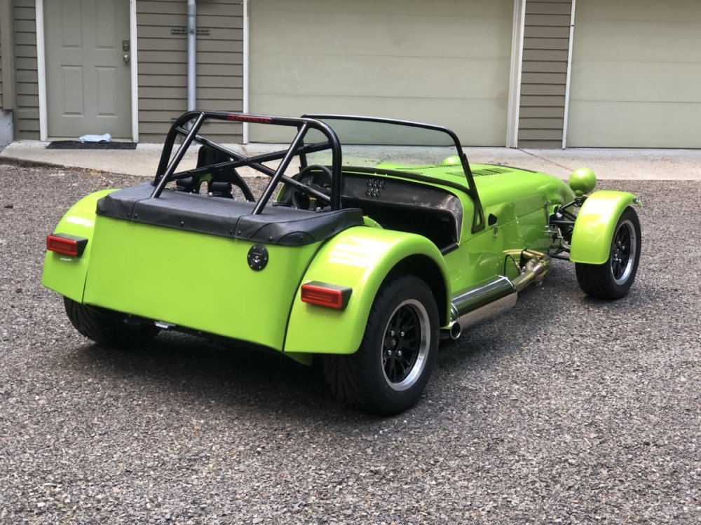

The car drove and stopped under its own power on Saturday.  However, with no air filter, it was only a 200' round trip drive up part of the driveway.  The special order, no-logo ITG air filter ordered in mid-March was supposed to arrive in April or May.  It arrived at Pegasus last week, but apparently it was the wrong filter.  I'm waiting to hear back from them on next steps, but unless ITG can turn things around this week, it looks like I'll have Pegasus send the logo filter tomorrow or Wed.  In the interim, I need to spend some time learning Easimap.

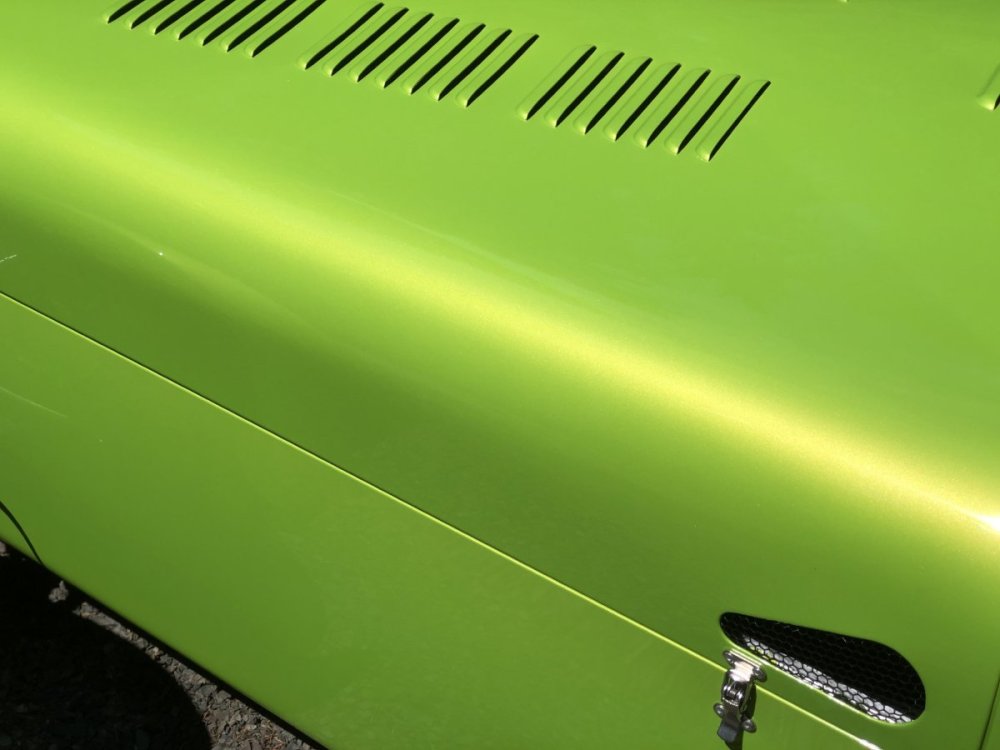

As I've written before, this color is really hard to capture in photos, but this one is pretty close.  You can really see the yellow highlights on curved surfaces:

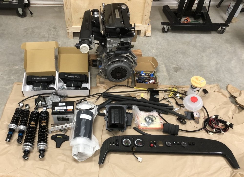

Now that the car is nearly done, I started to go through the leftover parts and throw away some boxes and packaging.  The photo below shows what I found.  Missing are the oil pressure gauge and ECU, both of which are with local USA7s members for troubleshooting purposes.  At some point, most of this goes up for sale.

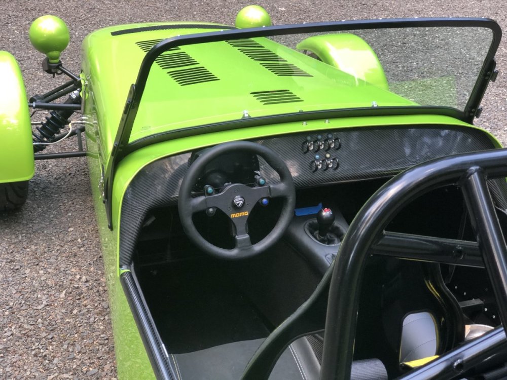

Congratulations John, all your skills and determination paid off well. Your dash is something that keeps drawing my attention. So clean and uncluttered. Nice job, Enjoy it…🍻

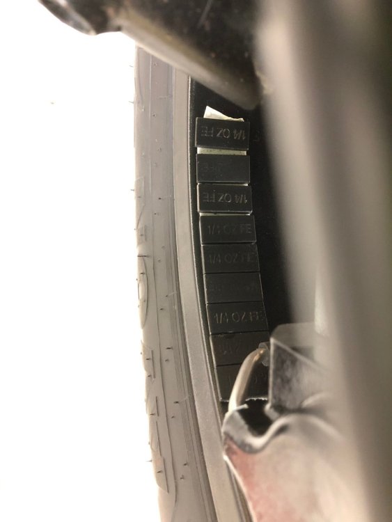

When I got the wheels and tires mounted from Caterham, the same thing happed. Aka the weights felt. The position inside the wheel was obvious so I've glue them and but some thin foil aluminum tape over them. (Painted black) clean and "permanent" :-)
John, at least with my 13” wheels none of the adhesive wheel weights that I had curved enough when attached like in your picture - they all fell off. One has to cut the weights into individual piece before sticking them on. Congrats on the first drive!
I just took a look at the Westfield's 13" wheels -- also Caterham wheels BTW -- and it looks like the weights are slightly different than what either Caterham or Beachman's shop used.  It could very easily be an optical illusion, but the both the weights and the foam appear to be a little thinner and you can see a comfortable triangular gap between each weight indicating they are conforming to the circumference.
I just checked the other wheels on the Caterham.  The rears both look fine, but the other front wheel...not so much.  I'm no expert, but that doesn't look right to me.
Looking at the weights from above, it appears the foam is stretched between the weights due to the tight circumference and potentially from forcing the weights into position, and that tension popped the middle section away from the rim.
-John
The wheel was not clean and/or the weight installer was in a hurry.
You can mark the center of the weight strip on the wheel, remove the strip, scrub (fingernail, plastic scraper, sharpened tooth brush "shank") and wd-40 to soften the residual tape (safe for the rim paint), cut a strip or replacements with the same total, clean the wd40 off with a good cleaner that won't remove paint, and align the center to the strip. You could completely clean the existing weights then apply to a strip of 3m body molding doublesided tape to reinstall. No rebalance needed if it was right to begin with. You will likely do a better job than to take it back.
This is exactly what I tried to write - when reapplying, just attach the strip back in place as individual pieces and there will be no tension. The weights are not designed to have the needed spacing for 13” wheels.
