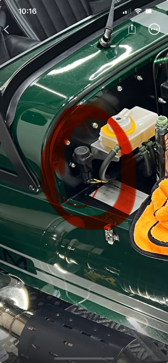

CBuff Posted September 5, 2025 Posted September 5, 2025 (edited) Inertia switch ?  When I change the oil I unplug it to cycle the engine without starting. Sometimes when I reconnect it doesn’t quite jump into action without some fiddling. Once it’s working it’s fine.  Mine is mounted next to brake reservoir. On firewall. Edited September 5, 2025 by CBuff 1
MV8 Posted September 5, 2025 Posted September 5, 2025 (edited) Inertia switches traditionally control the pump only. Not the injectors or ignition. Â I'd look for battery voltage (with a light bulb or dvm) at the coils and injectors DURING cranking. Edited September 5, 2025 by MV8 1
pickles Posted September 5, 2025 Author Posted September 5, 2025 (edited) 2 hours ago, MV8 said: Inertia switches traditionally control the pump only. Not the injectors or ignition. Â I'd look for battery voltage (with a light bulb or dvm) at the coils and injectors DURING cranking. That is correct the inertia switch controls the fuel pump, and this does prime, if I disconnect the inertia switch the pump does not run. Thus I eliminated the inertia switch as an issue. Edited September 5, 2025 by pickles
