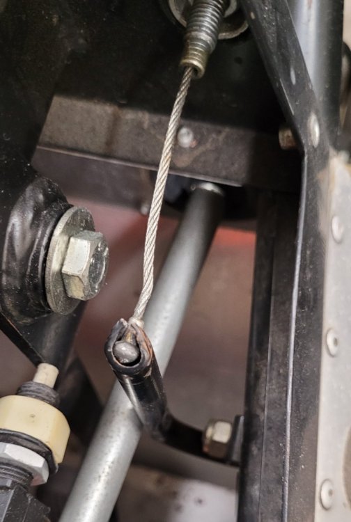

Replace. What are the lengths and diameters?

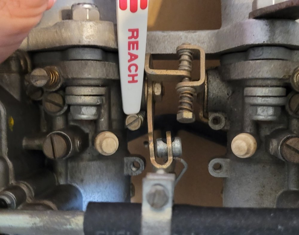

You should see the rest of the car! That crimped lever end wasn't my doing. I do plan to clean it up with the proper clip. Those DCOEs aren't on the car anymore. Next carb will probably be a DG.
We can't really know you from the other side of a keyboard. We just try, that's all.
The armature is actually bent around the shaft with a papers width clearance. My pedal is stiff, and I thought was rubbing, but it's in the axis.
Looks like cable, throttle and linkage stuff. These Xflow cars are all thirty years and older. All the joints, cables, etc are gumming up. I have heard of the throttle pedal pivot being a problem and if you unhook the cable and try moving it you may be surprised how stiff it can be. It could possibly be rubbing on the steering shaft if LHD. Check our your pedal and cable.

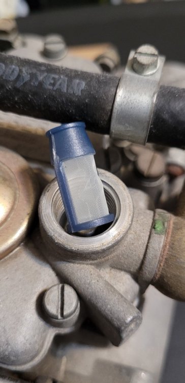

This is your idle speed adjustment screw. As you climb up, and have the chokes off, turn this screw to adjust the idle speed. You likely need a full rebalance and idle adjustment, but this is a start. Don't forget you have fuel filter screens under the brass caps.
When you do this, does the idle go down to normal? You don't say. I understand the link doesn't stay there, but you don't say that this changes the idle.
