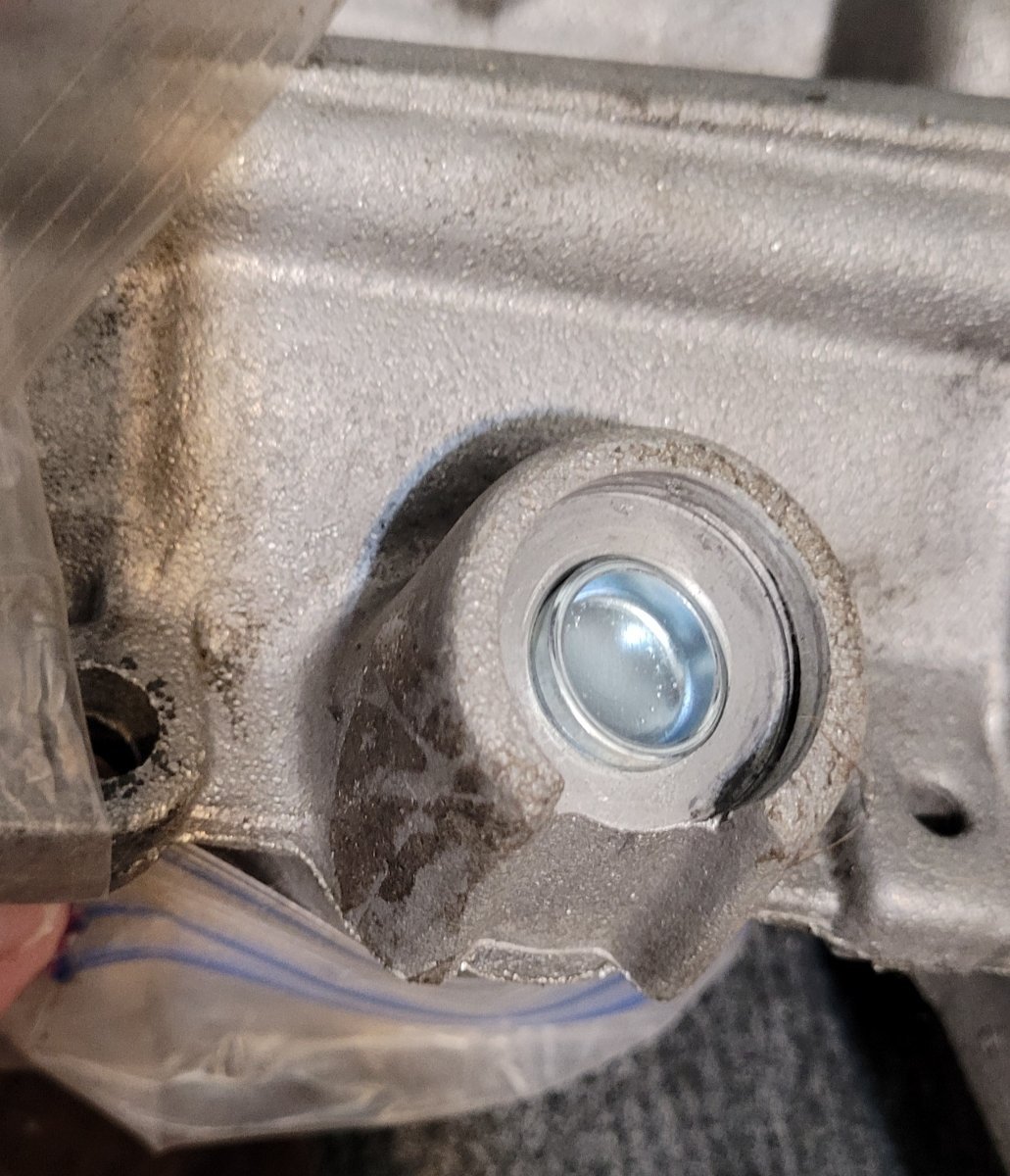

  14. Looks like it's on there And, if you got brake flooid sprayed all up in that clutch? I dunno. Can the disc be cleaned up? IF you have to remove the clutch cover, turn bolts a little at a time in a cross pattern so the cover doesn't warp.
  15. I looked on line (CC) to review the Duratech assembly. IKEA manual style. Not much there but bolt the bell to the engine. I don't believe the CSC needs to be installed by the buyer. Both bleed nipples run to the too for ease of access and air purge. One question remains, and I'm willing to ask it... Was a clutch cover installed on the flywheel?
  16. Omg... You're a saint for doing this work and sharing. For the bringing a photo of the car you are replicating, bring Tony Weale's book for pictures. Since his coverage stops mid 90's, you won't be showing a trail to current production. Tony's book isn't very applicable to current production but you should have it anyway.
  17. Well, then I'm suspicious a line disconnected or a seal popped. A good use for a fiber optic scope to look in there. Yes, engine and transmission come out together so you don't damage the shaft or spigot ( pilot) bearing in the separation.
  18. My worthless opinion. Something popped? Do we know if this is a bad thing? Maybe something popped into place? Try more bleeding to see if you get pressure. If you get a puddle of fluid, then you know you have a problem.
