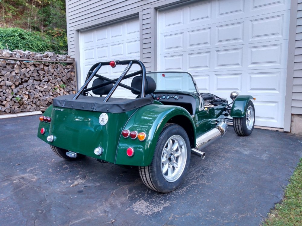

Great minds must think a like.  I did the same on my 310S.  Love your Seven Geoff!

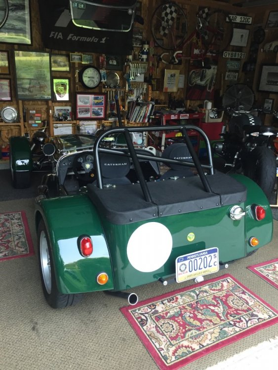

Here’s what I did with my taillights.  I removed the ugly rectangular trailer lights and replaced them with Wingard lights which provide running and brake lights and  mounted separate stock beehive lights for the turn signals.

As an added measure of safety I added the LED bulbs to my tail lights.  The Thorpe PT675 lights are extremely difficult to find and would be ruined if the standard incandescent bulb overheated them.  Of course the benefits of the LED lighting are also a consideration.  I find the LED bulbs in the vintage assemblies to be a win win option.     Thanks,   Tim
