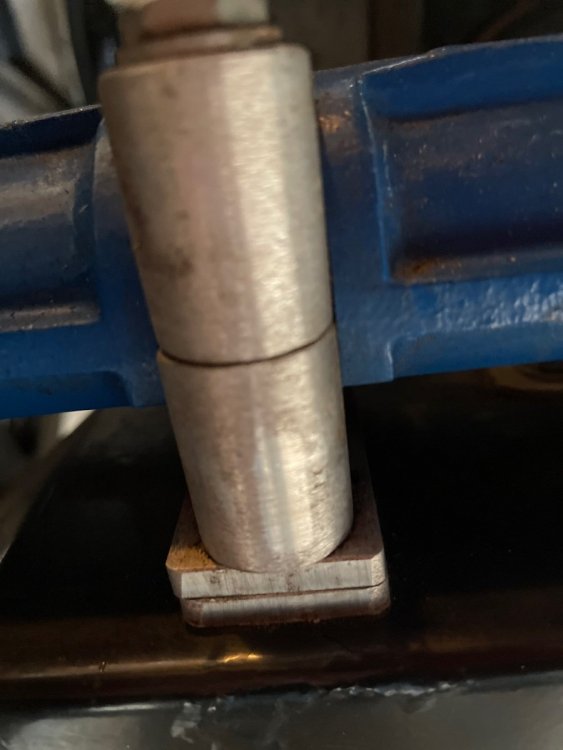

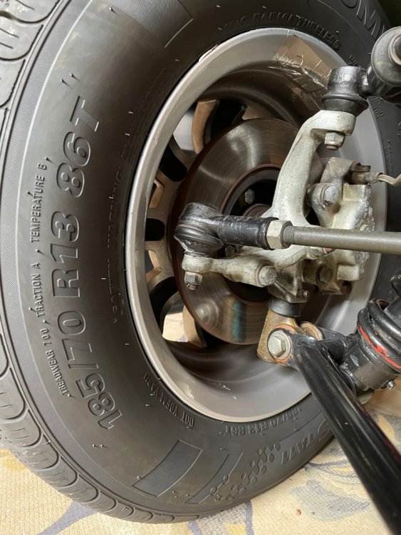

Sevins7 Posted November 23, 2021 Share Posted November 23, 2021 I have just received my newly purchased 1995 Caterham (1600 X-Flow, solid axle) and the steering is super heavy with zero centering. I have owned a Caterham BV Twin Cam before and the steering on that one was normal. This one has an 8% rack I believe. While it's quite heavy driving the country roads around here the main problem is keeping it straight on the highway. The car just wants to hold whatever line i set and getting it straight requires a huge effort and constant nudging of the wheel. It is really unpleasant and feels a bit dangerous. I cannot relax for one second. And after a short 40 mile drive into town and back my arms and hands are toast. The seller insists the wheels were correctly aligned. Its running 13x5 rims and 185 tires so not much issue there. I jacked it up and there is a bit of friction. It also feels a tiny bit heavy when standing still but this is down to the small steering wheel i think. It all goes wrong as soon as it's moving. Any help would be gratefully received. The seller thinks it is just down to the 8% rack and wants me to buy a new standard version from Caterham. I am not sure i agree with this at all. I need to get it registered in the next 10 days so any help will be gratefully received. Many thanks. Aloha! Link to comment Share on other sites More sharing options...

JohnCh Posted November 23, 2021 Share Posted November 23, 2021 I'd start with the easy stuff. Do a visual check on the caster washers to see if a previous owner set that up with a lot of negative caster. Also closely examine the various ball joint rubber boots for tears. Next, with the front end jacked up, grab a front wheel and move it back and forth to get a sense for what the friction feels like with the system intact. Movement should be pretty smooth. Next remove the steering shaft from the rack. Rotate the steering wheel and confirm there isn't friction in that assembly and it rotates smoothly. Now try moving the wheels again and reconfirm smoothness. If something doesn't feel right there, reattach the steering shaft, remove the tie rod ends from the uprights and check steering rack and both wheel assemblies to see where the problem resides. Positive caster creates more self-centering and increases steering effort. Negative caster, just the opposite. Given your symptoms are heavy steering (positive caster) and lack of self centering (negative caster) I suspect stiction in the ball joints, steering rack, or steering shaft assemblies is at least part of the problem. One caveat to all this is that what you consider heavy, others may consider normal. However, given you've owned a Seven before, it does sound like something is amiss. -John Link to comment Share on other sites More sharing options...

Sevins7 Posted November 24, 2021 Author Share Posted November 24, 2021 On 11/23/2021 at 4:15 AM, Davemk1 said: It sounds like a sticky or seized ball joint/rod end or that the lube in the rack lube had dried up and gotten sticky. In any case it sounds like a friction issue. dave I jacked the car up and there is some binding going on especially in the center where it sticks quite hard and requires more effort to get it past that point The car is a 1995 with just 950 miles on the clock and I’m wondering if the rack has dried out as you are suggesting, if so how can I deal with this? I have bought some 140 EP gear oil which I believe is appropriate for this application. mahalo Link to comment Share on other sites More sharing options...
Sevins7 Posted November 24, 2021 Author Share Posted November 24, 2021 Update: I disconnected the rod ends. The hubs rotate freely. No binding at all. The steering still feels heavy and notchy. Virtually no difference from when the rods were connected. Removed the steering UJ at the rack and the column is free with no binding or rubbing. Ergo....steering box or alignment. I think kit must be the rack. When it is attached to the steering column there is some serious binding and rubbing going on even with the rods ends disconnected. So what next? As mentioned above, this is supposedly a 950 mile car and it has obviously been sitting for years. Could the grease have been lost or hardened? Is it time for a new rack? Would the adjusting nut make any difference? Link to comment Share on other sites More sharing options...

coffee break Posted November 25, 2021 Share Posted November 25, 2021 Hmm sounds like a bent rack. Link to comment Share on other sites More sharing options...
Sevins7 Posted November 25, 2021 Author Share Posted November 25, 2021 That's interesting as I can see a bend in the front cross member where the horns are. The seller said it probably happened when it was towed out of wherever it sat for years! The rack looks OK from the outside. Many thanks. Link to comment Share on other sites More sharing options...
