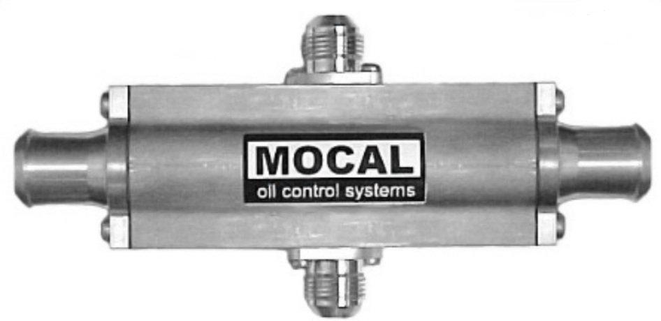

Croc Posted November 14, 2023 Posted November 14, 2023 Both @CarlB @MV8 make excellent points. In day to day road driving you are not going to get the oil temp warm enough to justify an oil cooler. You are more likely to over cool the oil on cooler days. In a track environment the need for an oil cooler emerges. I use the Caterham recommended modine style cooler on my CSR (it is branded Cosworth but was made by Mocal) which has the advantage of allowing the oil to warm up quicker but then links oil temp to water temp preventing an oil temp spike. Caterham CSR260s are well known for their fearsome oil temps on track so it is something I closely monitor when driving in summer. Its a smaller and less bulky package to install. The disadvantage of this approach is that it will not be as efficient at cooling as the radiator style oil coolers on really hot days. However, in the last 13 years there has been only one instance where I came off track on a 100degF day as the oil temp hit 250F after 20 minutes. Otherwise, the oil temp has been staying within its optimal range. My suggestion is install a sensor for oil temp and see where you are operating at first. My bet is your twin cam is operating at the right oil temps now. If not then a solution like a modine might be a better half step to solve the problem than a full oil cooler.

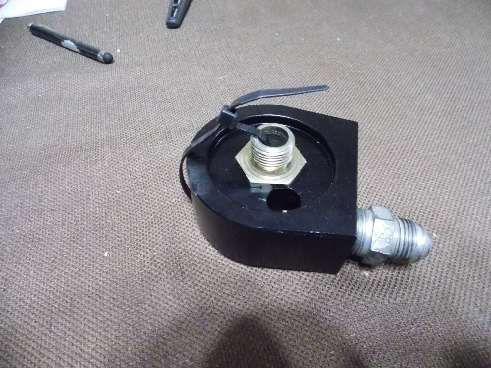

7Westfield Posted November 20, 2023 Posted November 20, 2023 (edited) https://www.pegasusautoracing.com/productselection.asp?Product=1236 the gold colored fitting holds the sandwich plate to the pump it's right above the filter it screws onto the threads that used to hold the filter if yours is like this, all you need to do is remove it and install a filter I have seen some with male threads on both ends---if you have that style, you need the fitting from an another pump edit---forgot I had one in the basement this photo is the bottom side remove filter-remove gold fitting-install filter Edited November 20, 2023 by 7Westfield
Tony Posted November 20, 2023 Posted November 20, 2023 Thank you for the photo! I tried my 1" socket on it and it felt a bit loose. Don't want to mess it up, need the right/new socket. Will check out your pegasus link for specifics. The oil tube connectors on the pump are frozen immovable, probably been there since '93. May end up cutting them just to get it all out.
7Westfield Posted November 20, 2023 Posted November 20, 2023 FWIW that pegasus link is not the one for a x-flow I just picked it for illustration
