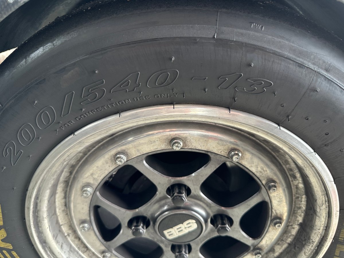

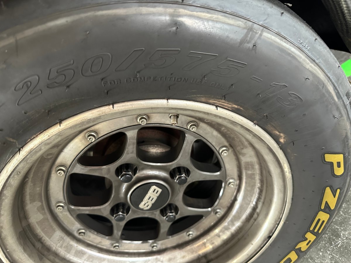

Croc Posted June 23, 2025 Posted June 23, 2025 I didn't think much of the Nankang AR1. My track replacement for both the ZZR and the Hoosiers (now that Cooper Tires have changed the compounds and sizings) is to go Pirelli P-Zero for 13 inch wheels. If I need a tread (for a specific track day operator) then I have them hand grooved in a style similar to the ZZR - its easy to copy. Very close to the ZZR and maybe a fraction behind the old pre-Cooper Tires Hoosier R7 version. Downside - they are not cheap! I believe these are used for Formula 3 in Europe. For road I will stick with R888 for now in 13s. Still experimenting with my UK Caterham.

Croc Posted June 24, 2025 Posted June 24, 2025 6 hours ago, Daniel Escobar said: My local trackday wont allow slicks, so need to stick to road tires. how much quicker are these vs ZZR Extreme? Neither will mine in some events which is why I made the comment about hand grooving a tread pattern. Easy enough to mimic the ZZR. A little quicker than ZZR Extreme - a second a lap. But if the ZZR Extreme are not available then the P-Zeros are MUCH quicker.

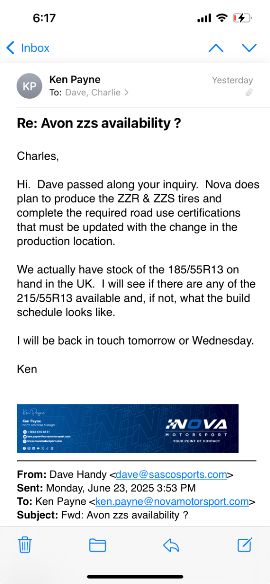

CBuff Posted June 24, 2025 Posted June 24, 2025 (edited) Keeping an eye on options as I will be due to replace my zzs by summers end. Took another look at nova as they were taking over the Avon production. But hadn’t yet committed to producing the zzs and zzr line yet. Will update when he gets back but this was Ken Payne , North American manager at nova, response as of yesterday. Edited June 24, 2025 by CBuff 1 2
CBuff Posted June 24, 2025 Posted June 24, 2025 Update Charles, I've confirmed that there is no stock for the rear tire at this time. Production is anticipated later in the year, but specific timing is still TBD. 1

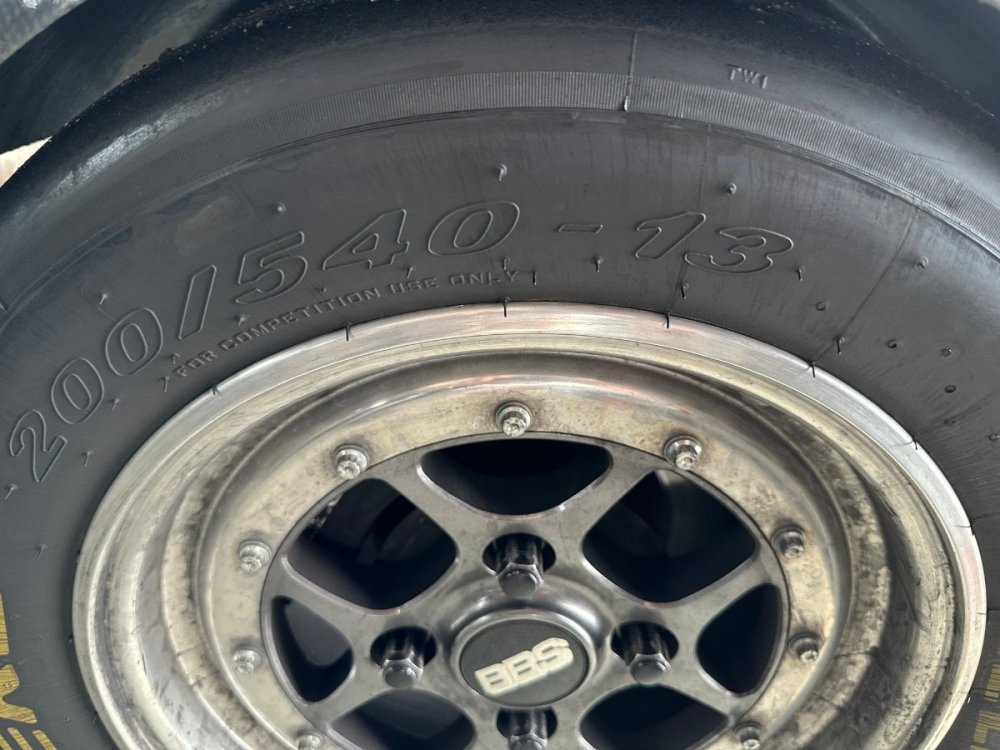

Daniel Escobar Posted June 24, 2025 Posted June 24, 2025 10 hours ago, Croc said: Neither will mine in some events which is why I made the comment about hand grooving a tread pattern. Easy enough to mimic the ZZR. A little quicker than ZZR Extreme - a second a lap. But if the ZZR Extreme are not available then the P-Zeros are MUCH quicker. Those rear tires look meaty! how do they fit on the fenders? whats the width and offset of those WESMO BBS wheels?
Daniel Escobar Posted June 24, 2025 Posted June 24, 2025 4 hours ago, CBuff said: Keeping an eye on options as I will be due to replace my zzs by summers end. Took another look at nova as they were taking over the Avon production. But hadn’t yet committed to producing the zzs and zzr line yet. Will update when he gets back but this was Ken Payne , North American manager at nova, response as of yesterday. They are available in Europe...... I spoke to these guys in Spain that have them, only in the 333 "extreme" compound. Shipping would be expensive.. https://vilarinoracingshop.com/collections/avon-tyres/zzr#MainContent
