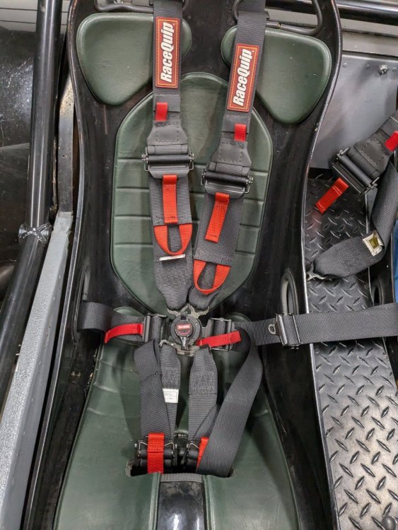

Vovchandr Posted July 12, 2024 Author Posted July 12, 2024 4 hours ago, wemtd said: The yellow label is a patch sewn onto my belts. What if you (carefully & with surgical precision) just removed the offending yellow patches by cutting their threads? Maybe. I'm open to most options right now. Ideal solution of OEM is no longer valid for me. Here is current setup and it's not ideal but it's good enough for me to not want to swap back and forth

fastg Posted July 14, 2024 Posted July 14, 2024 I use Race quip. Do not like the color but like the belts. Got them from Pegasus, they were very helpful. Sent the first pair back because the adjusters were below the side of the seat 1 1

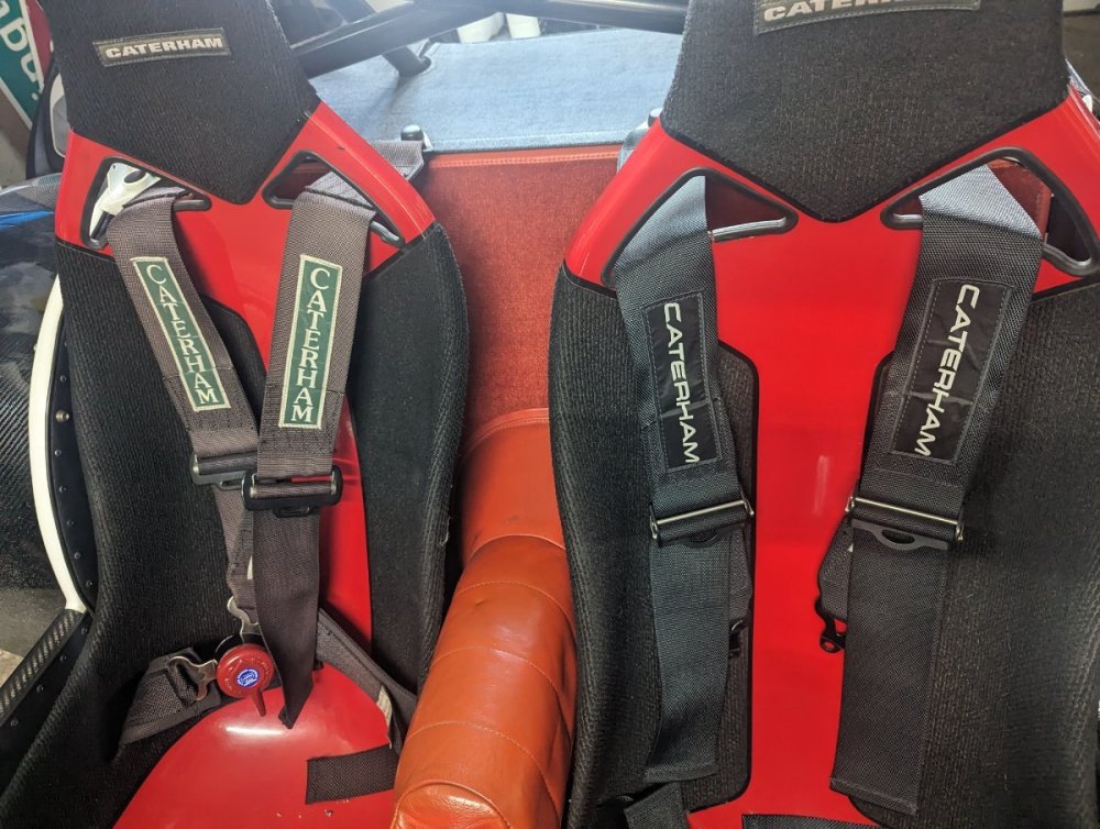

FE07 Posted July 24, 2024 Posted July 24, 2024 Vlad, I use these: https://www.pegasusautoracing.com/productselection.asp?Product=SAB-CCS622F-UN They're formula car harnesses. I've forgotten what your seats look like. If you've got a hole for a crotch strap, then you don't need these. (although you still could use them) If you've got the leather seats like I do, then you simply pull the crotch straps between the top and bottom sections in the back and use them like that. A little more difficult to put on but you don't have any metal by those important parts down there! Looks like you've got composite seats with holes. Not to make things more complicated but if you look at the pic of you driver seat you'll note that the harnesses don't come through the holes equally. The left is splayed left towards your shoulder and the right more towards your neck. It's due to the placement of the mounts for the harnesses. Not really ideal with a HANS device. If you're interested I can send you a pic of the adapter I made for the harnesses so they're appropriate for a HANS. Jim
Vovchandr Posted July 24, 2024 Author Posted July 24, 2024 2 hours ago, FE07 said: Vlad, I use these: https://www.pegasusautoracing.com/productselection.asp?Product=SAB-CCS622F-UN They're formula car harnesses. I've forgotten what your seats look like. If you've got a hole for a crotch strap, then you don't need these. (although you still could use them) If you've got the leather seats like I do, then you simply pull the crotch straps between the top and bottom sections in the back and use them like that. A little more difficult to put on but you don't have any metal by those important parts down there! Looks like you've got composite seats with holes. Not to make things more complicated but if you look at the pic of you driver seat you'll note that the harnesses don't come through the holes equally. The left is splayed left towards your shoulder and the right more towards your neck. It's due to the placement of the mounts for the harnesses. Not really ideal with a HANS device. If you're interested I can send you a pic of the adapter I made for the harnesses so they're appropriate for a HANS. Jim Ive got Tillers with the hole and I got HANS. I'm currently trying to narrow down OEM'ish Luke harnesses from UK but having a hard time narrowing it down to a a model from them that's FIA and that's also regular hole mount/Caterham type. @CBuff thanks. I was afraid that was the case. Even the non snap in job is bad enough. Certainly don't want to make it worse
