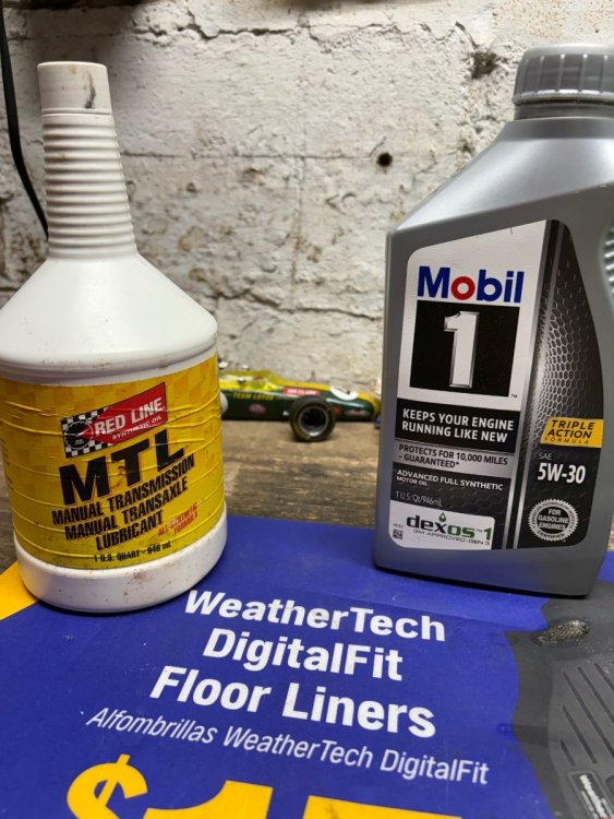

I use a generic synthetic for diff      just be sure to get a GL-5 rating
MTL is great for most transmissions

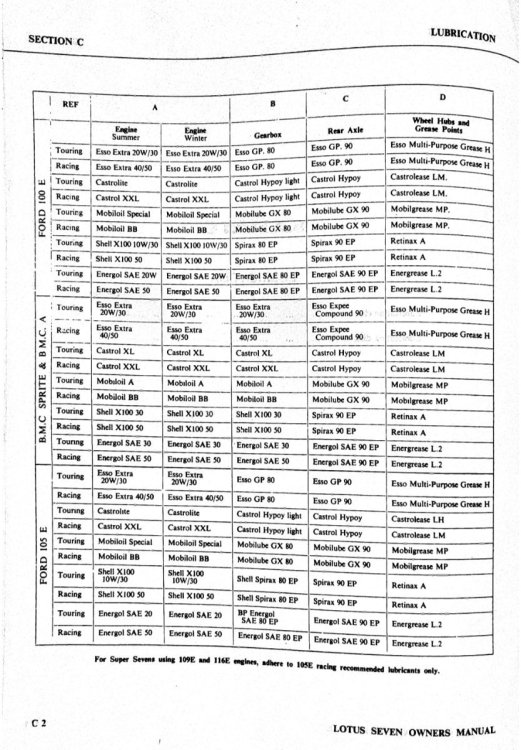

What is reccomended for a 61 S2 differential?  New to the car and changing all the fluids.
Edited by MRH
This should help with proper weights for all the fluids.  The entire manual is in the library, should you need it.

Thanks.  Oil is 20w50 Driven Racing Oil GP-1 (recommended by Ivey), trans is redline, will get the gear oil next.
