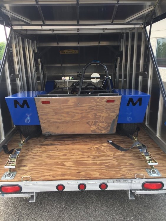

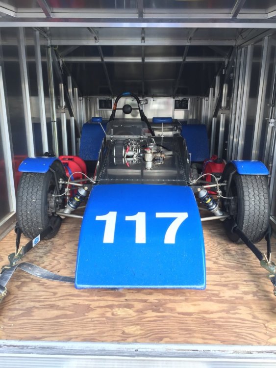

7Westfield Posted November 15, 2025 Posted November 15, 2025 (edited) While the weather holds, I'd drive the Cat to a trailer lot, and ask to drive it into a 6x12 It will be tight both length and width, but doable V nose a def help in this case, it will give you a bit more room up front for tie downs Inside will be bare unless you spec a wall covering Tie downs will be extra You'll want them as far fore and aft as possible. You don't want the straps to go straight down to the tie point, as that will not control shifting back and forth, like a flatter angle will. You don't want the car to kiss the front under braking. Tires....a real can of worms On another (racing) forum I'm on, a lot of them replace tires every 3--4 years, regardless of mileage. UV is a killer. OTOH ours are prob 5 years old and lookin good. We put about 6-7000 miles a year on them, and I pull them and store them in the shed over winter. Also a pretty good theft deterrent. I wouldn't run anything smaller than a 14"--we are on 205/15s More tire spreads the load, and 15 keeps the rpm down The OE tires will probably be some no-names from some backwater, good for a couple of years at most. We currently run Carlisle, and they seem good. Goodyear Marathons are pretty good, too. Trailer tires lead a rough life, low mileage aside. They get a lot of neglect, rubbed on curbs (they do have a heavier sidewall) and so forth A spare will cost extra Brakes I don't know the numbers, but I think you are under the radar on that. But, they are sure nice, esp with a lighter weight tow vehicle. If you get a dual axle, consider putting on both axles, and get the self adjusting ones. Trailer brakes are a PITA to adjust. Ask if your proposed tow vehicle has a built in brake controller--if not, you'll have to install one, and run another wire to the back. The bigger stuff, like pickups and SUV's have come with wiring in place for years, not sure about the smaller vehicles. Edited November 15, 2025 by 7Westfield

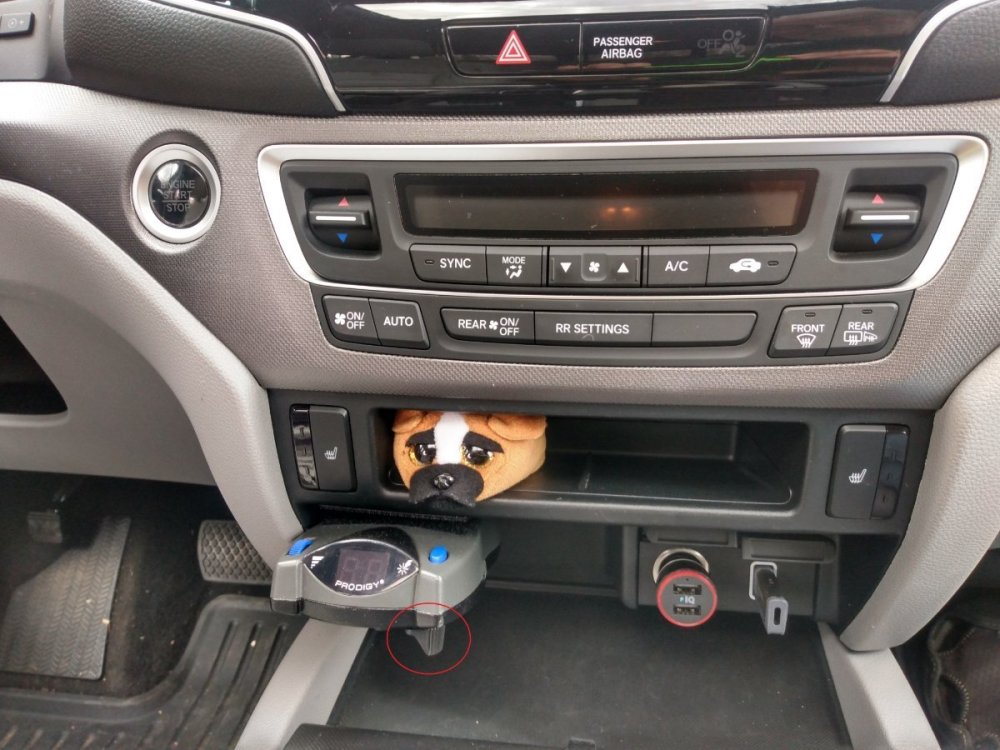

CarlB Posted November 15, 2025 Posted November 15, 2025 If you want trailer brakes, it is a good idea to check out the factory tow packages. I am not familiar with Ford's options, but My Chevy Colorado tow package has several feathers that beef up the truck, plus a brake controller. The brake controller is integrated with the anti-lock brakes for sway control.

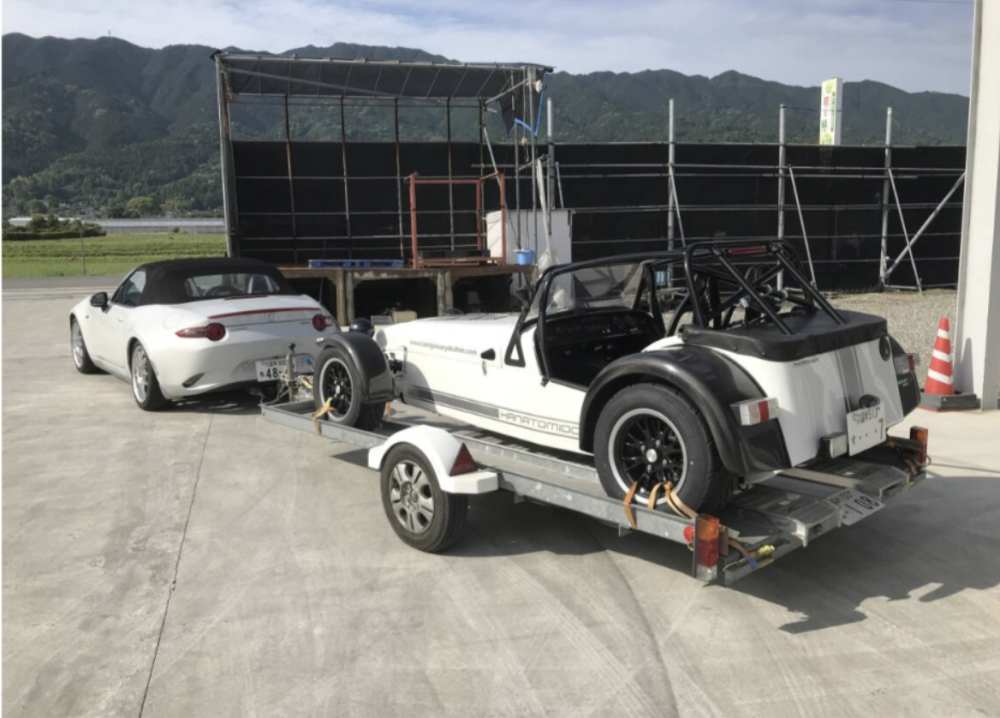

Marek Posted November 17, 2025 Posted November 17, 2025 We run a 3000lb-rated 16' single-axle open aluminum trailer with brakes to tow Sevens and Miatas. It is a dream to tow. The single axle is plenty and even without the brakes (controller problem!) it handled well. Don't over size your trailer. I recommend brakes, but stick with a single axle. 1

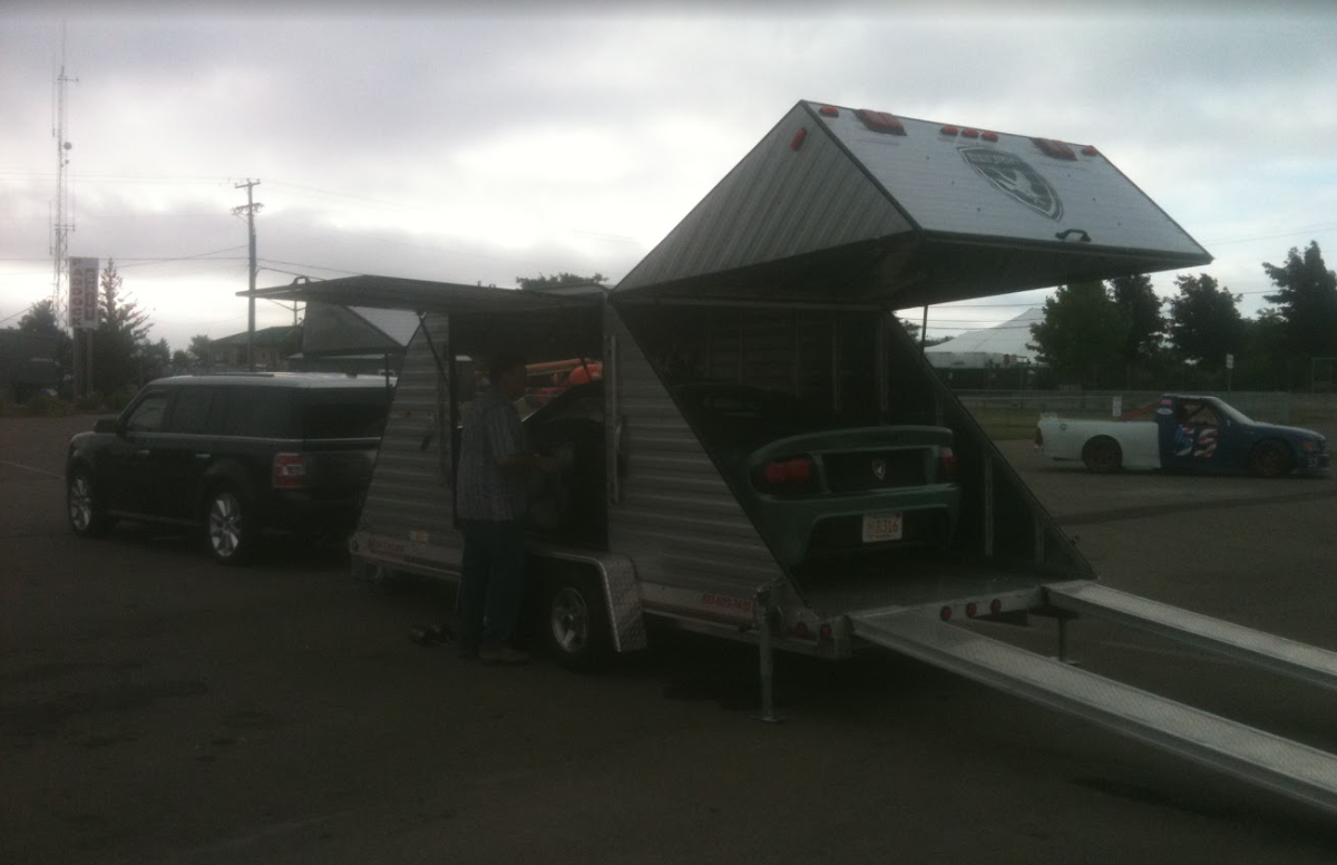

Marek Posted November 17, 2025 Posted November 17, 2025 @savagete2860 Have you considered a Softbits Storm Cap and an open trailer. That would give you a very light, compact, setup which is much easier to load than an enclosed trailer and still provides weather protection. Don't underestimate the convenience of a trailer you can disconnect and easily maneuver into place by hand. In the UK, clamshell covered trailers are quite common. But hard to find in the US. Futura might have a clamshell model.

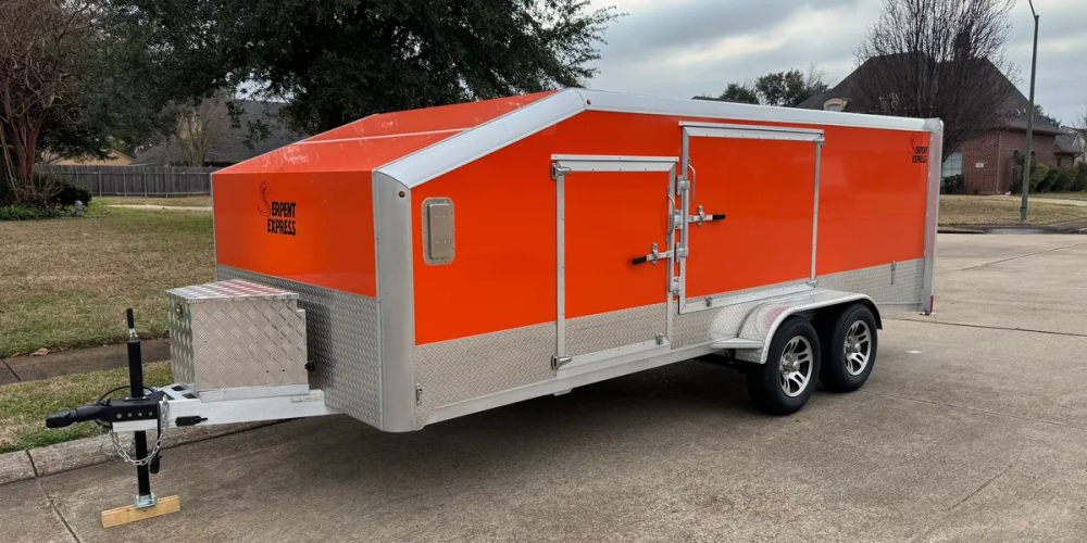

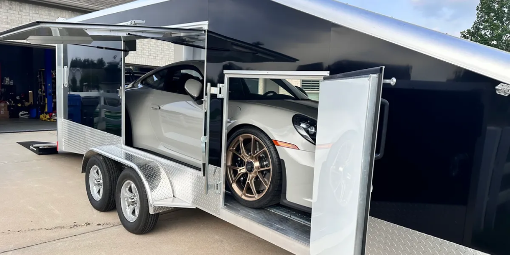

savagete2860 Posted November 17, 2025 Author Posted November 17, 2025 Thank you for the replies everyone, super useful stuff. I am still searching around for both trailer and truck. That was a good call out for checking the door width on 6x12s, a lot (all of the ones I was looking at) wouldn't fit my car. I am sold on tandem axles, it just seems worth the added safety and stability. Also I didn't call it out but I was planning on brakes on whatever trailer I get as well. I really REALLY wish those clam shell trailers that are all over the place in the UK were sold over here. I would snag one of those up in a second. I am guessing there isn't really anything comparable in the states, right? I haven't found anything but maybe I haven't looked everywhere. Maybe its worth reaching out to some custom trailer places and seeing if they could build something similar within a reasonable budget. I did some rough measuring, and a mid size truck can fit in my garage along with my 7, only just (door opening might be a problem and not enough height to jack it up for maintenance). I need to try and test it out in real life to see how much of a pain that would be along with the miserable gas mileage. With only doing a few events a year, it might make more sense to get the smaller, more economical vehicle, and deal with the downsides of an open trailer. I'm still pondering it all... 4 hours ago, Vovchandr said: Maybe we need a dedicated show off your trailer thread too I would love to see some more tow setups.
Vovchandr Posted November 17, 2025 Posted November 17, 2025 22 minutes ago, savagete2860 said: Thank you for the replies everyone, super useful stuff. I am still searching around for both trailer and truck. That was a good call out for checking the door width on 6x12s, a lot (all of the ones I was looking at) wouldn't fit my car. I am sold on tandem axles, it just seems worth the added safety and stability. Also I didn't call it out but I was planning on brakes on whatever trailer I get as well. I really REALLY wish those clam shell trailers that are all over the place in the UK were sold over here. I would snag one of those up in a second. I am guessing there isn't really anything comparable in the states, right? I haven't found anything but maybe I haven't looked everywhere. Maybe its worth reaching out to some custom trailer places and seeing if they could build something similar within a reasonable budget. I did some rough measuring, and a mid size truck can fit in my garage along with my 7, only just (door opening might be a problem and not enough height to jack it up for maintenance). I need to try and test it out in real life to see how much of a pain that would be along with the miserable gas mileage. With only doing a few events a year, it might make more sense to get the smaller, more economical vehicle, and deal with the downsides of an open trailer. I'm still pondering it all... I would love to see some more tow setups. Pardon the ancient picture taken with a potato in 2012 but this might be just what you're looking for Don't know the brand or cost, maybe others here do Saw this at Watkins Glen Man of good taste
locost7018 Posted November 18, 2025 Posted November 18, 2025 Looks like a snowmobile trailer to me. Russ
