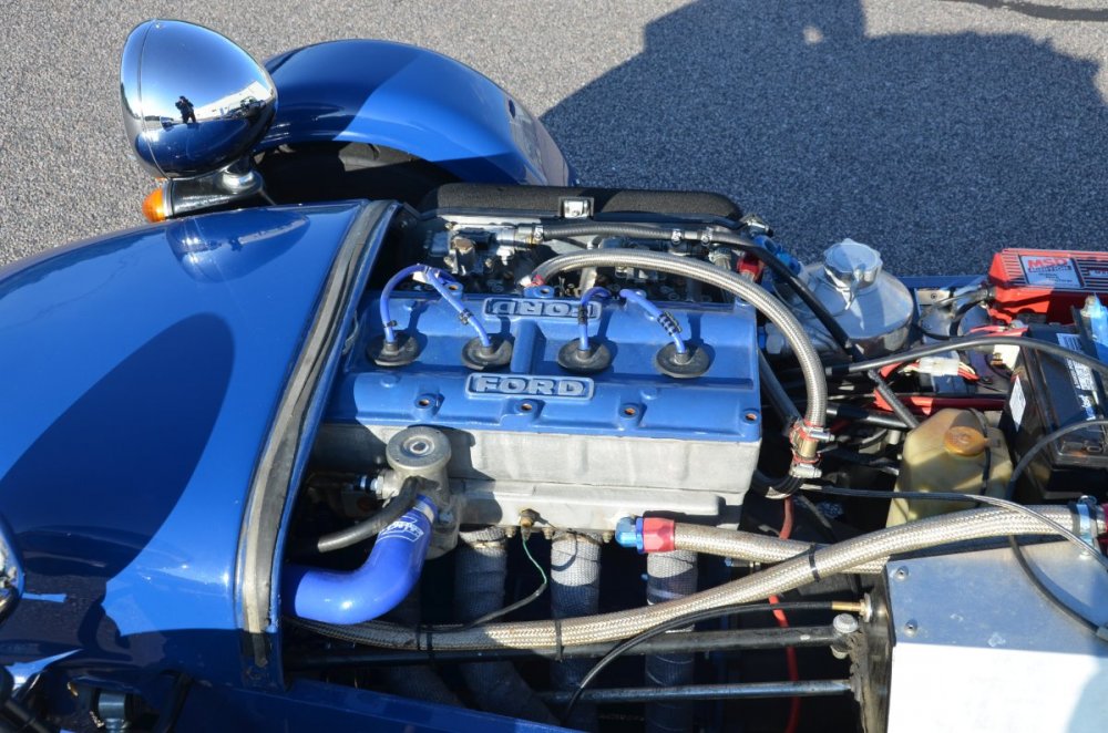

BlueBDA Posted July 8, 2021 Author Posted July 8, 2021 Picture showing the thermostat housing. You can see the vent tube that runs into the overflow bottle.

JohnCh Posted July 8, 2021 Posted July 8, 2021 I think that is a pressurized system. Raceline uses the same thermostat housing in its water rail. It's designed so the overflow port which feeds the expansion bottle is only open to the system when the pressurized cap hits it's limit and the base retracts. Otherwise it is sealed. -John

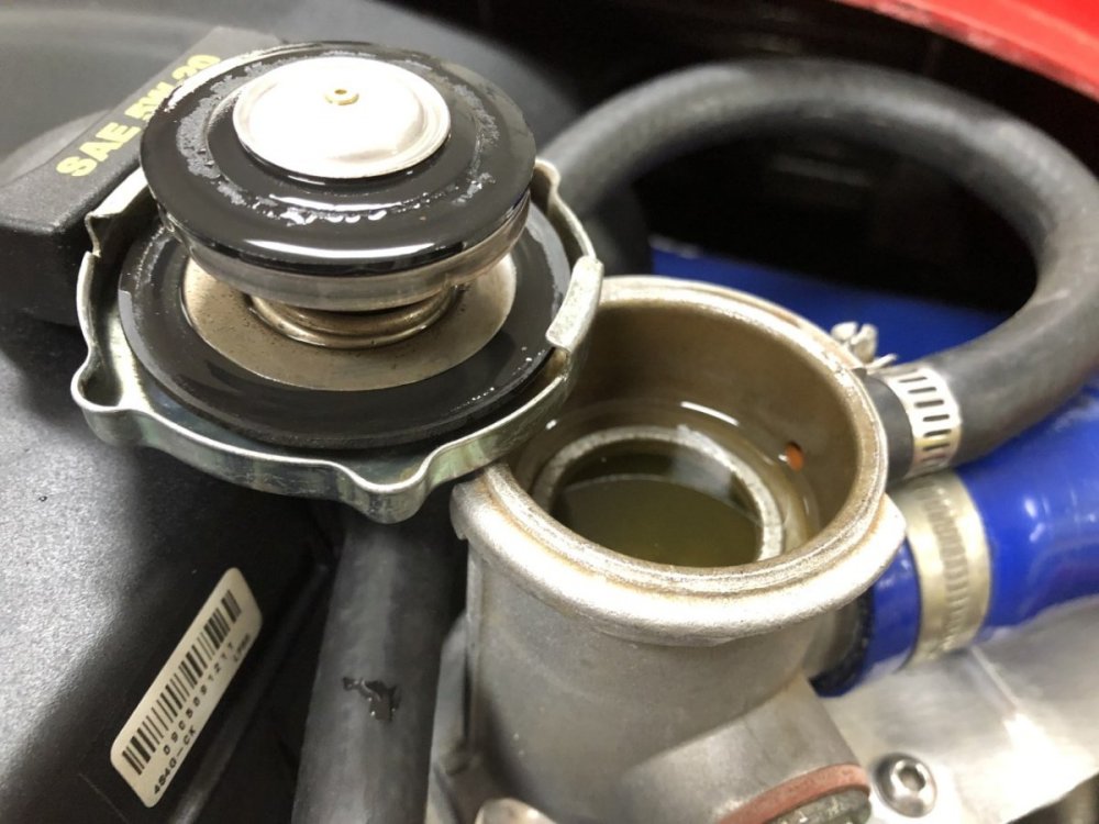

JohnCh Posted July 9, 2021 Posted July 9, 2021 Here is a picture that shows the pressure cap and thermostat housing so you can see how they work together. Regarding the tube in the overflow tank, it's best if the end is cut at an angle to ensure that it doesn't' seal against the bottom and prevent the flow of coolant under suction. -John
