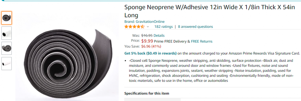

Vovchandr Posted July 25, 2021 Share Posted July 25, 2021 I've put Neoprene in my rear wings and haven't gotten around to doing it on the front wings yet. To me seemed like an easy/cheap/effective option. Granted I have carbon wings so spider cracks are less of a concern but the rock noise made me feel uneasy in general and this cuts down on that noise quite a bit Edit: that doesn't help with outside. PPF is about the only thing that can help there. Link to comment Share on other sites More sharing options...
