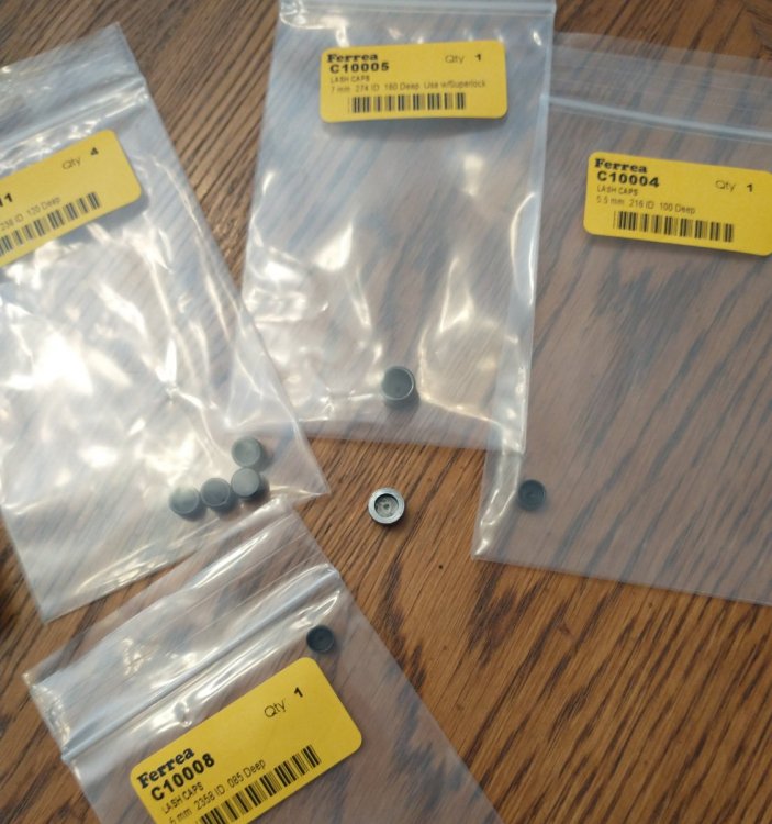

Vovchandr Posted August 13, 2021 Author Share Posted August 13, 2021 I find that remark strange too as I was able to find other topics and part number of people talking about them. I placed an overnight order for 4x of them to be here by Monday. Listed for "6.08 mm Lash Caps - Specifications: 6.08 mm - .239 ID - .120 Deep Ford Focus 2.0L (for Valve Stem Stock size)" I hope they fit. Order one size bigger and smaller as well just in case. They needed valve dimensions from the shop but the shop was unable to provide me with them until Monday. Link to comment Share on other sites More sharing options...

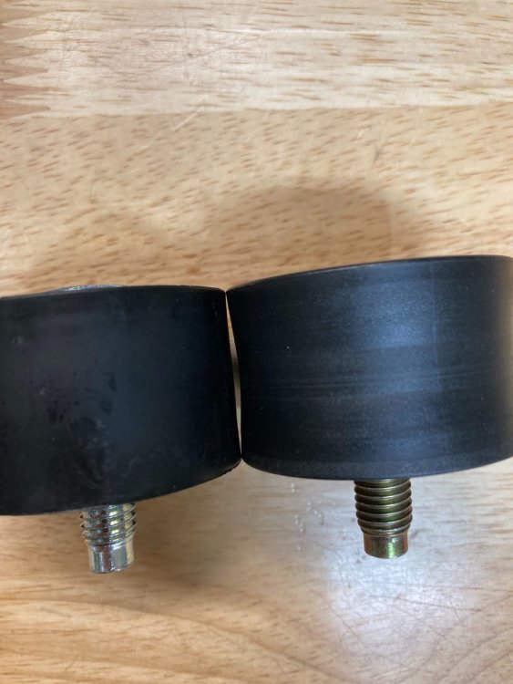

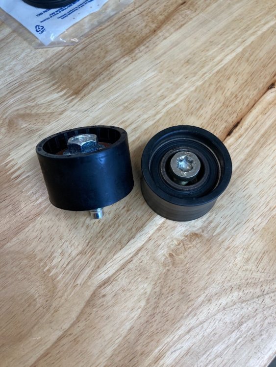

Vovchandr Posted August 13, 2021 Author Share Posted August 13, 2021 Zetecs varieties are still very confusing to me. One of my timing belt idle pulleys came in different than what I've had. Started looking into it. It appears there were two different varieties of Zetec with no obvious distinctions. From everything I've seen so far I have a Ford Contour Motor due to it being VCT and the position of the oil fill plug. Still no idea why the yellow valve cover but those are seen occasionally. In the first picture you can see idler is same size as tensioner. In second picture, idler is bigger vs Here is what the part numbers cross back over to Smaller Bigger As you can see there is a lot of overlap in 99. Might be a half year model thing. With my Caterham being a 2001 I always assumed by engine is around 2000. Looks like it might be a 1998? Link to comment Share on other sites More sharing options...
Anker Posted August 13, 2021 Share Posted August 13, 2021 The cam pulleys are correspondingly larger and the cams are further apart! Link to comment Share on other sites More sharing options...

Vovchandr Posted August 16, 2021 Author Share Posted August 16, 2021 (edited) Lash caps are in. Doesn't look like any of them will work. Called Ferrea and they don't really have anything that will work it seems. Debating on buying a stock head to source the caps but at this point in time I have no guarantees that mine are even stock at this point in time. Since the head was build who knows what the builder used. Edited August 16, 2021 by Vovchandr Link to comment Share on other sites More sharing options...
JohnCh Posted August 16, 2021 Share Posted August 16, 2021 Given the ones from Burton Power appear the same as yours, it might be worth a call to see if they can provide more detail. The page I linked to earlier states "Tappet shim to fit our solid tappets. 0.160" thick (machine to suit) and 6mm stem. Will also suit any tappet/valve with a 6mm stem." Looking at their solid tappets, it appears they are referring to those offered by Kent in standard 30mm, and a slightly larger 32mm sizes. Seems like a reasonable lead to follow. -John Link to comment Share on other sites More sharing options...
Vovchandr Posted August 16, 2021 Author Share Posted August 16, 2021 On 8/13/2021 at 2:01 PM, CarlB said: Someone put different tappets in your engine. The Ford tappets do not use caps on the valves to adjust the clearance. @CarlB It appears you were right on the money. I've visited a second Ford dealer who was also confused and couldn't find a lash cap. Running out of ideas I tried calling the original builder that I had on the sheet to see if they would be willing to help out. Sure enough the phone number was still valid, they picked up and were very nice and confirmed that they used their own lash caps on the intake side to work with the cam profile. I send them the dimensions of the one I have a few minutes ago, they will try to match it against the boxes of leftovers they have and send it over to me (maybe with a few extras) Link to comment Share on other sites More sharing options...
Vovchandr Posted August 16, 2021 Author Share Posted August 16, 2021 2 hours ago, JohnCh said: Given the ones from Burton Power appear the same as yours, it might be worth a call to see if they can provide more detail. The page I linked to earlier states "Tappet shim to fit our solid tappets. 0.160" thick (machine to suit) and 6mm stem. Will also suit any tappet/valve with a 6mm stem." Looking at their solid tappets, it appears they are referring to those offered by Kent in standard 30mm, and a slightly larger 32mm sizes. Seems like a reasonable lead to follow. -John Thanks John. I'd follow up on that if I didn't have a direct lead right now. My measurements came out to be about 9.06 width, 5.20 height, 2.67 depth and 6mm ID. Link to comment Share on other sites More sharing options...

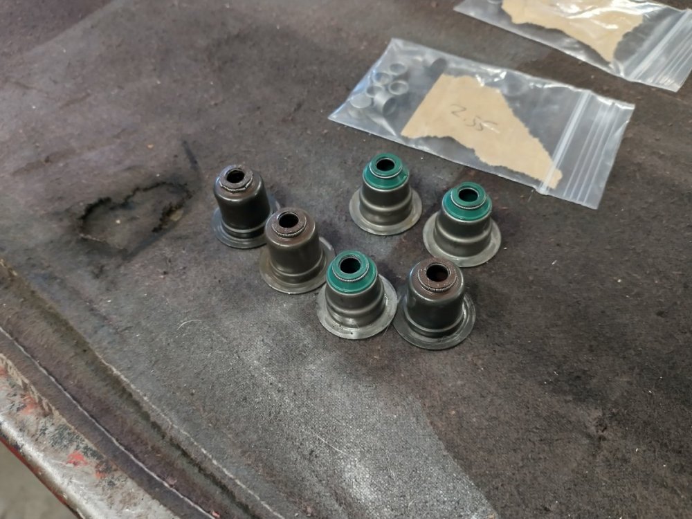

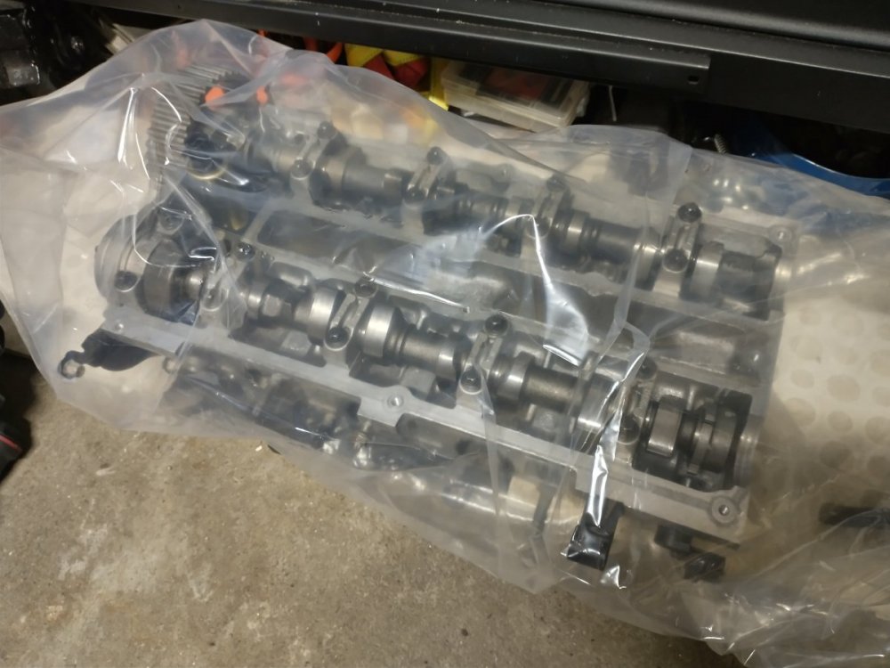

Vovchandr Posted September 8, 2021 Author Share Posted September 8, 2021 (edited) Some progress finally. Today the right caps were sourced and delivered to the shop. If anybody with a custom Zetec runs into this issue... Ferrea didn't fit. Manely weren't right. After talking to the very helpful people at Artistry in Engineering they discovered a supplier that works - https://www.vacmotorsports.com/ They have all sorts of custom varieties and I was able to order ~2.5mm ones that the shop can work with. They said they can take out any minor differences from the valve. VAC-LC-6-2.50 is the part number. I've ordered 8 of the 2.5mm and one of the 2.55 just in case. Shop also replaced all the valve seals and didn't find any other problems in the head. It should be ready for me tomorrow. One interesting note that the shop was surprised to see is mis matching original valve seals. Either two different generations or a mix of intake and exhaust ones (green vs brown). All my replacements had just one part number. Also got my report from BlackStone today. Not very good, I could potentially have a bottom end issue, but they didn't see evidence of blown head gasket. Random notes: *I've never over-nighted anything before in my life and broke that cherry on at least 3 items now. *Somehow a $6 part so far has cost me about ~$200. Lets see how many things I can return. Edited September 8, 2021 by Vovchandr Link to comment Share on other sites More sharing options...

Vovchandr Posted September 10, 2021 Author Share Posted September 10, 2021 The head is back! Lash cap issue is considered closed until noted otherwise. Going to try to reassemble most tomorrow and find out what the next problem is. I see a 50/50 shot of it running well with timing zeroed out. If it runs decent but not optimal I don't care and will deal with it later. If it doesn't run well with going back to zero cam position I'll either have to find a tuner in short notice or mess with timing myself. Not interfierence Zetec I'm fairly certain) Issues in primary trying to close 1) horrible brief lack of power after decel 2) constant overheating at low speeds Honestly. If it runs decent but those issues persist I should still be able to make it. I feat it might not run well at all once zeroed back out in timing. Link to comment Share on other sites More sharing options...
