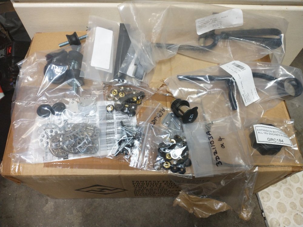

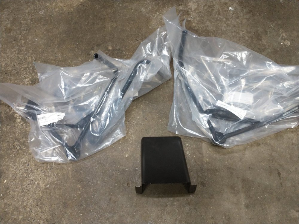

Vovchandr Posted October 8, 2021 Author Posted October 8, 2021 (edited) Got a few more goodies delivered from Redline CSR Fender stays for my new CSR fenders Race fender stays for lowest possible clearance New throttle pedals (to ensure I go WOT without having to bend one). One is for 2008+ one is original I can bend if needed More muffler bobbins Caterham 12v plug Fuel filler cover that I can cut in order for it to fit with trunk liners from SoftBits New bigheads fastners (not the ones I expected, but oh well) New backup overflow reservoir cap Sway bar boots Spray nozzle plugs Hood catch plates black rivets Another key fob Door accessories Edited October 8, 2021 by Vovchandr
