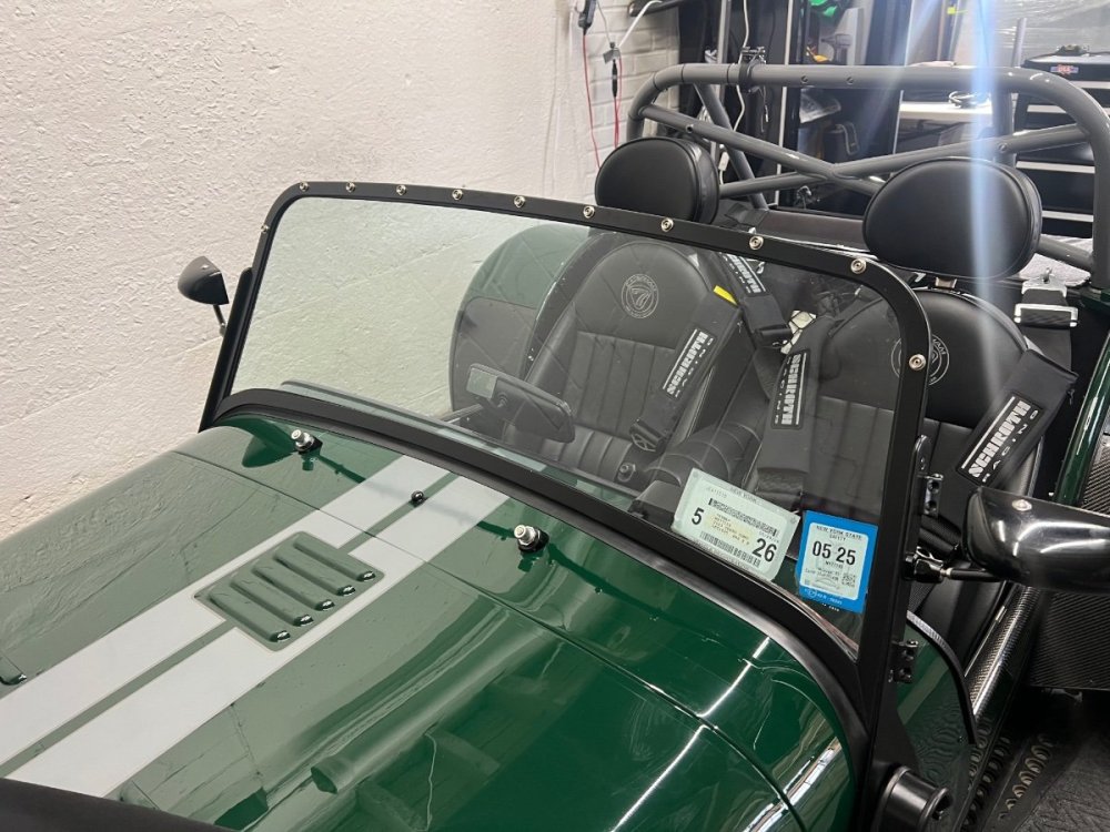

I had the dpr mirrors mounted on the lower windshield frame.  Just make sure the factory doesn’t drill into your doors for the factory mirrors. I purchased some of the mounting hardware from dpr but don’t know what can be reused from the factory stuff.
here is the half hood. I got easy in zips but don’t really use them to be honest. May experiment with opening then and driving like that for a bit if an open top half hood.
I also mounted my central mirror a bit unconventionally down low on the windscreen.  I actually really like it there. Your view is below the X in the cross bar and it doesn’t block forward view.  Can be moved if needed.
the brake light kit installed. They are low enough down so they don’t get blocked by the half hood.
6 point retrofit isn’t that big of a deal. Just have to figure out sub straps with the leather seats. Some folks just sit on the sub straps and they go thru the back of the seats.  I had my squabs cut
If you buy the eckels door mounts from DPR, you can use thr hardware on either the door or the windscreen.
When I'm going somewhere with the doors, I use the door mount.   When I am going somewhere without the doors, I mount them to the windscreen.

3 hours ago, CBuff said:
........ Just make sure the factory doesn’t drill into your doors for the factory mirrors. ............
here is the half hood. ........... May experiment with opening then and driving like that for a bit if an open top half hood.
I also mounted my central mirror a bit unconventionally down low on the windscreen.  ...............
6 point retrofit isn’t that big of a deal. ...........

Mirrors: Aren't they mounted on the doors, from the factory? Then why would they drill holes on the windscreen frame? With DPR mirrors mounted, guessing you don't have an issue with the doors opening and closing?
Factory mounted on the doors. But if you tell them not to install them there they won’t drill holes in the doors (not windscreen).  There is a threaded boss on the windscreen already that will take the dprs. Just not 100% sure what mounting hardware comes from the factory and what dpr needs to supply. The windshield mount does keep the doors from opening all they way to the bonnet but it’s a trade off that I think is worth it as the mirrors are rock steady.
central mirror - right. Forgot about cage. Yes that should work with dpr mount. And it will likely be more stable. My central mirror does vibrate/wind buffet at speed.

14 hours ago, CBuff said:
............ The windshield mount does keep the doors from opening all they way to the bonnet but it’s a trade off that I think is worth it as the mirrors are rock steady.
@CBuff: Not being able to open the door all the way would be a problem for me. I can see now how windshield or cage mounted mirrors would stop the door! Wouldn't work for me.
@demoray mentioned about Eckels mount which can go on the doors in place of stock mount points. So, it'll be a straight swap then; right? Doors open all the way with no vibration on the mirrors?
Question: We're talking about replacing the stock mirrors with DPR because the stock mirrors vibrate and gets out of position? Is that due to stock mounts or mirrors?

Also, as you see, Lucas has plenty of clearance to the top tube. Helmet eats up at least 2-3" of clearance. I'm 5'8" as well, with standard floor. So, I'll have plenty of spacing without helmet.

The choice of safety equipment gets dicy in these cars.  ...... We are just choosing what to give up, what risk to accept.   I don’t like driving my track setup Elise on the street because I’m in a twin shoulder harness with no neck protector and my head is near (padded a little) steel tubes with no helmet.
@Xhilr8n: Is that Exocet Red? Looks striking. I debated between Exocet and Volcano Red. Volcano is same as my Soul Red Miata; didn't want two same colors. Besides, Seven needs something more brighter than subdued Volcano.
