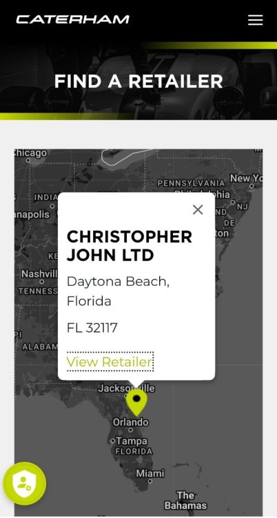

Go SV. Don't be so focused on the track performance.  Get a 7 you can enjoy tooling around in.  Comfortably.  That will be your keeper.

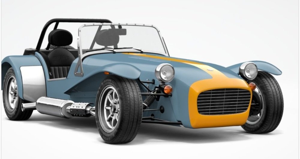

Super 7 2000
Here's your car:
https://caterhamcars.com/us/models/the-range/super-seven-2000?view=article&id=56%3Aconfigurator&catid=9&configuration=%2BBOOPITV%2BBPTPCBL%2BBST%2BCLB%2BCTS%2BDSHPDSS%2BE00%2BFST%2BFWG%2BGS5%2BHHL%2BHTR%2BIC7PP7I%2BINSPINM%2BINTPINCINRPINC%2BISB%2BITTPITV%2BKBT%2BLPO%2BLRSPBLK%2BMCP%2BMINCAOPDCUCAIPSLV%2BN7R%2BNAP%2BNBS%2BNDR%2BNGG%2BNRM%2BNSD%2BNTK%2BPIPPBLK%2BPNBPFYS%2BRAB%2BRBCPGBS%2BS2K%2BSGA%2BSIGCHASSIS%2BSIGHEADLIGHTBOWL%2BSML%2BSRB%2BSRD%2BSTU%2BSWL%2BSZV%2BWLW%2BWST
I didn't see a LHD option.
LSD is nice if you can pay for it.  Lowered floors is a personal choice but I would not choose it if you don't need it.
Edited by IamScotticus
